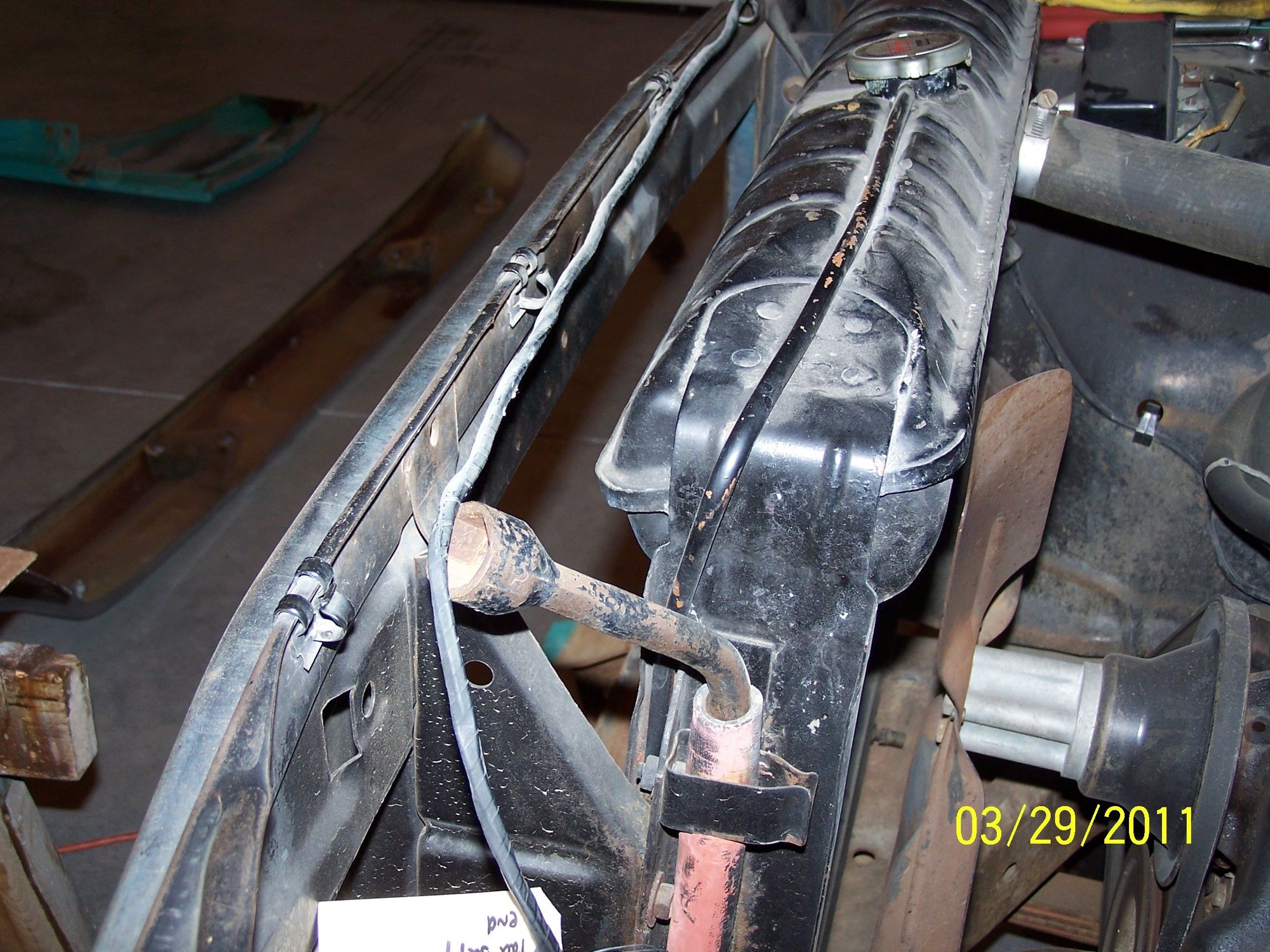

Here it is before I started the restoration

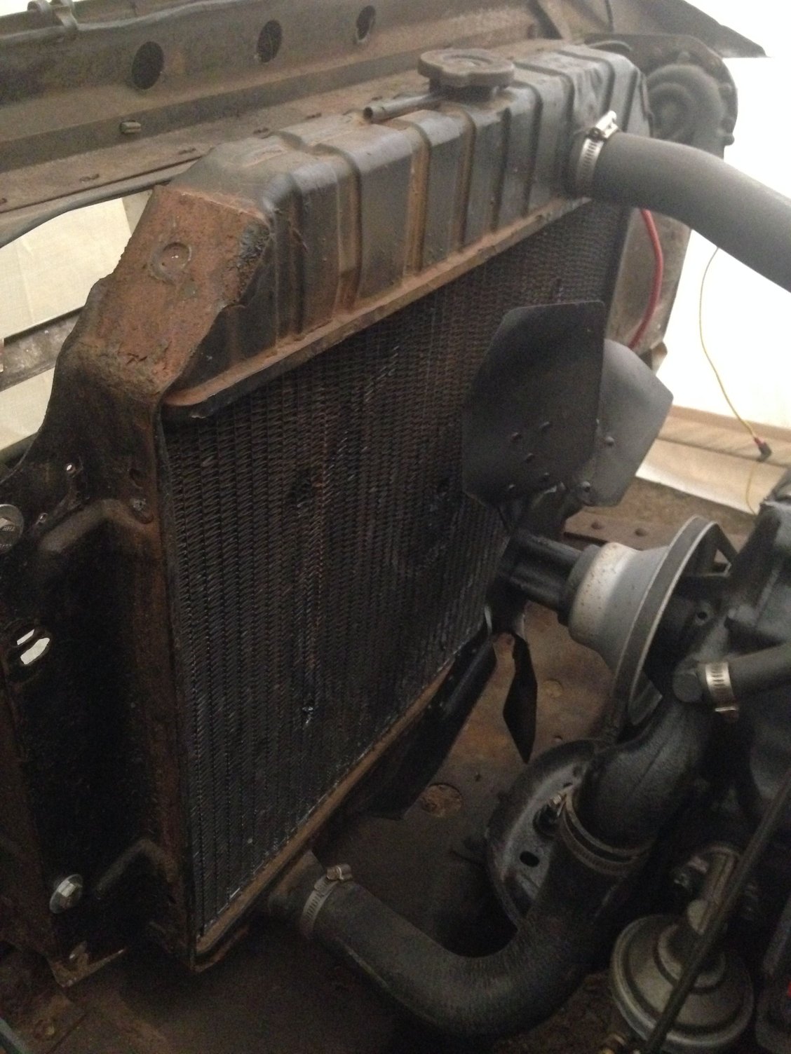

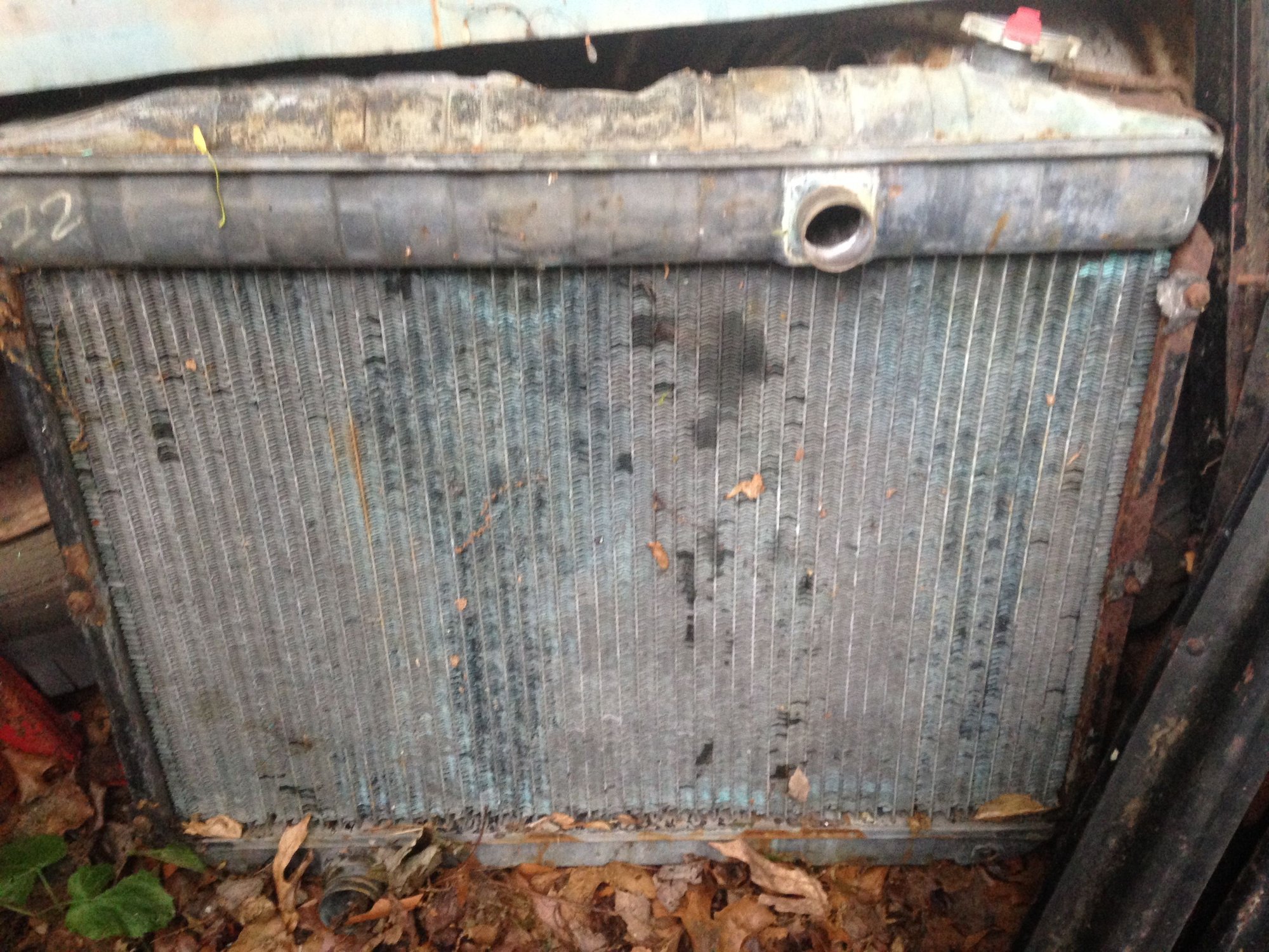

Its interesting there are 2 styles.
My original one (64 F350 DRW) - came from factory with this one....
My replacement i bought from a 64 F250 SRW....
