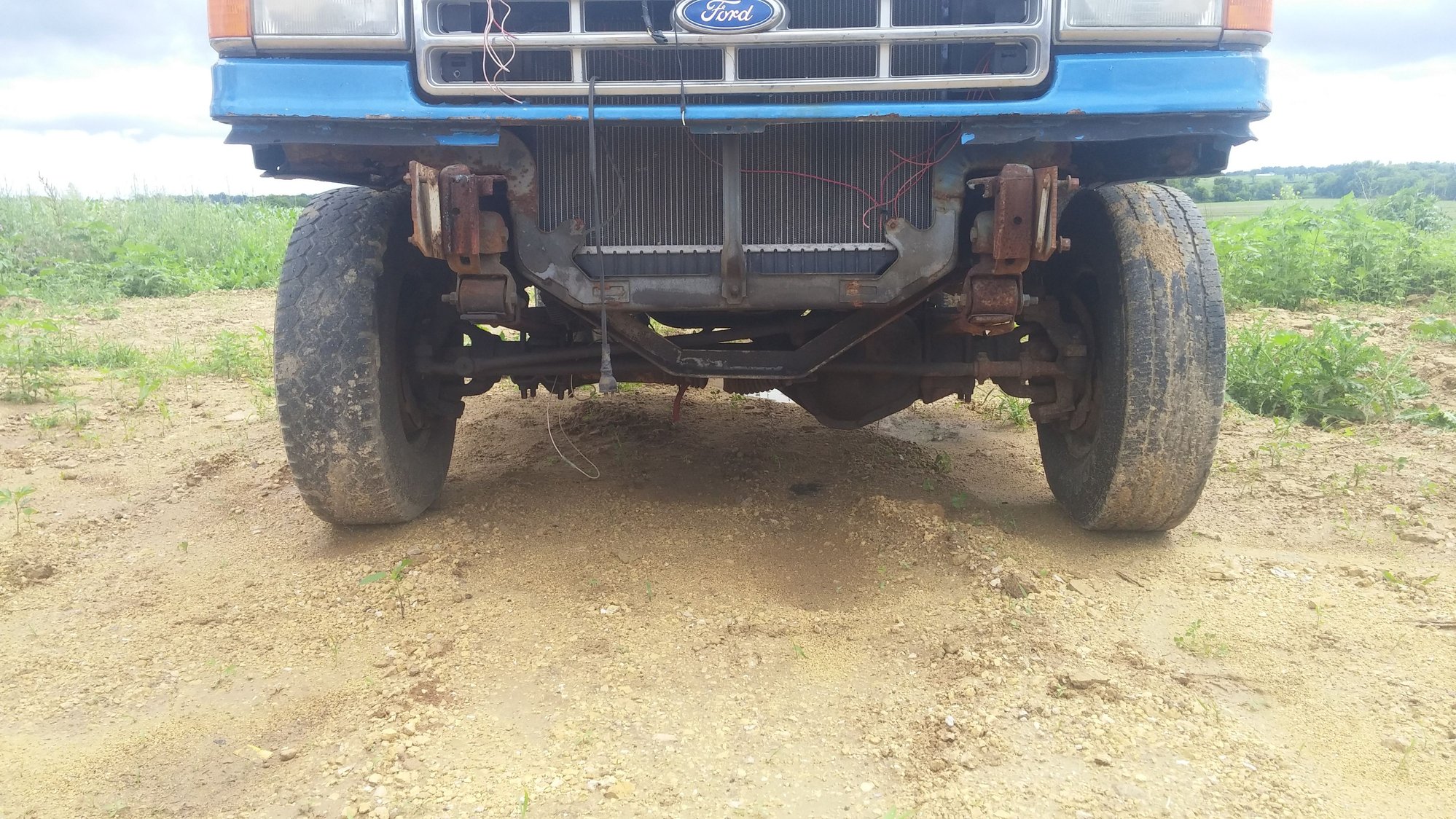

I have just aquired a 1988 F-350 dually 4x4, with 7.3 and C6 for next to nothing. It doesn't have a bed (or anything on the back for that matter) and the vin tag says incomplete vehicle, its titled as a cab and chassis. The cab is shot. The back is actually sitting on the frame from where it rotted. I bought it with the intent of it being a parts truck, but the rest of the truck is really not in too bad of shape. And I think there may be potential to save it.

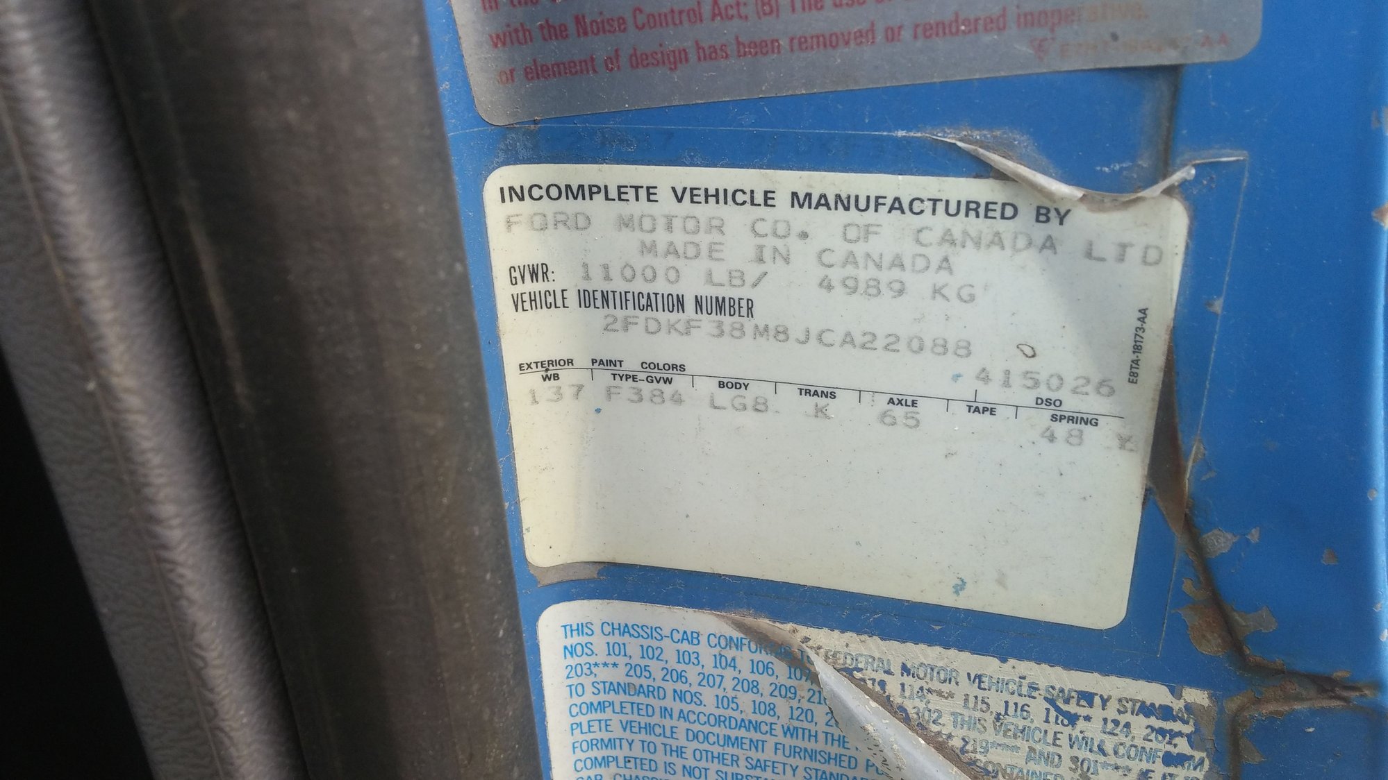

Tag off the 350

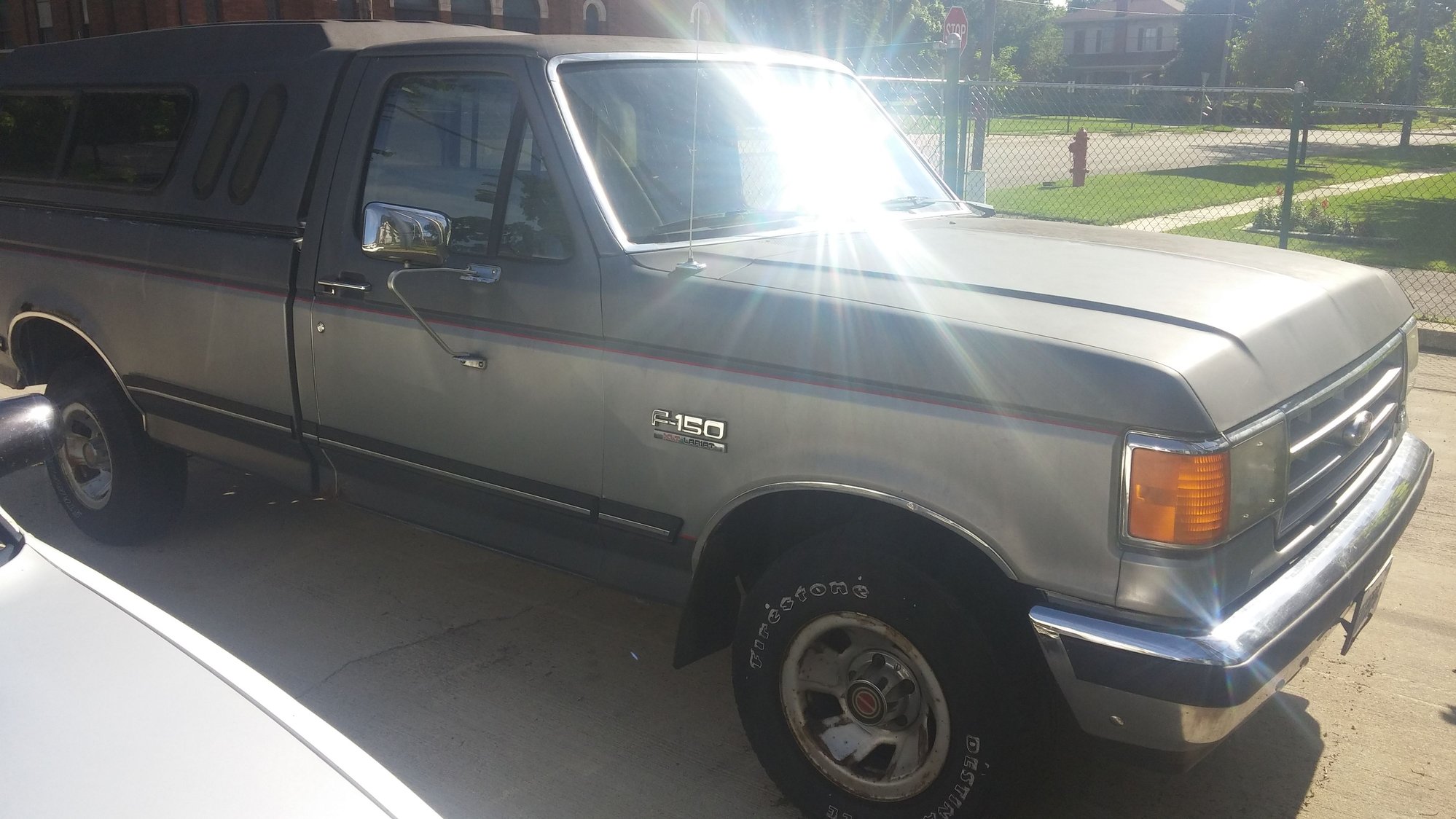

The possoble cab donor

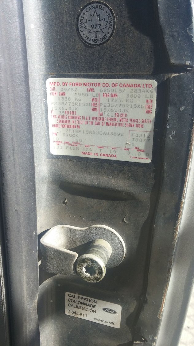

Vin off the doner

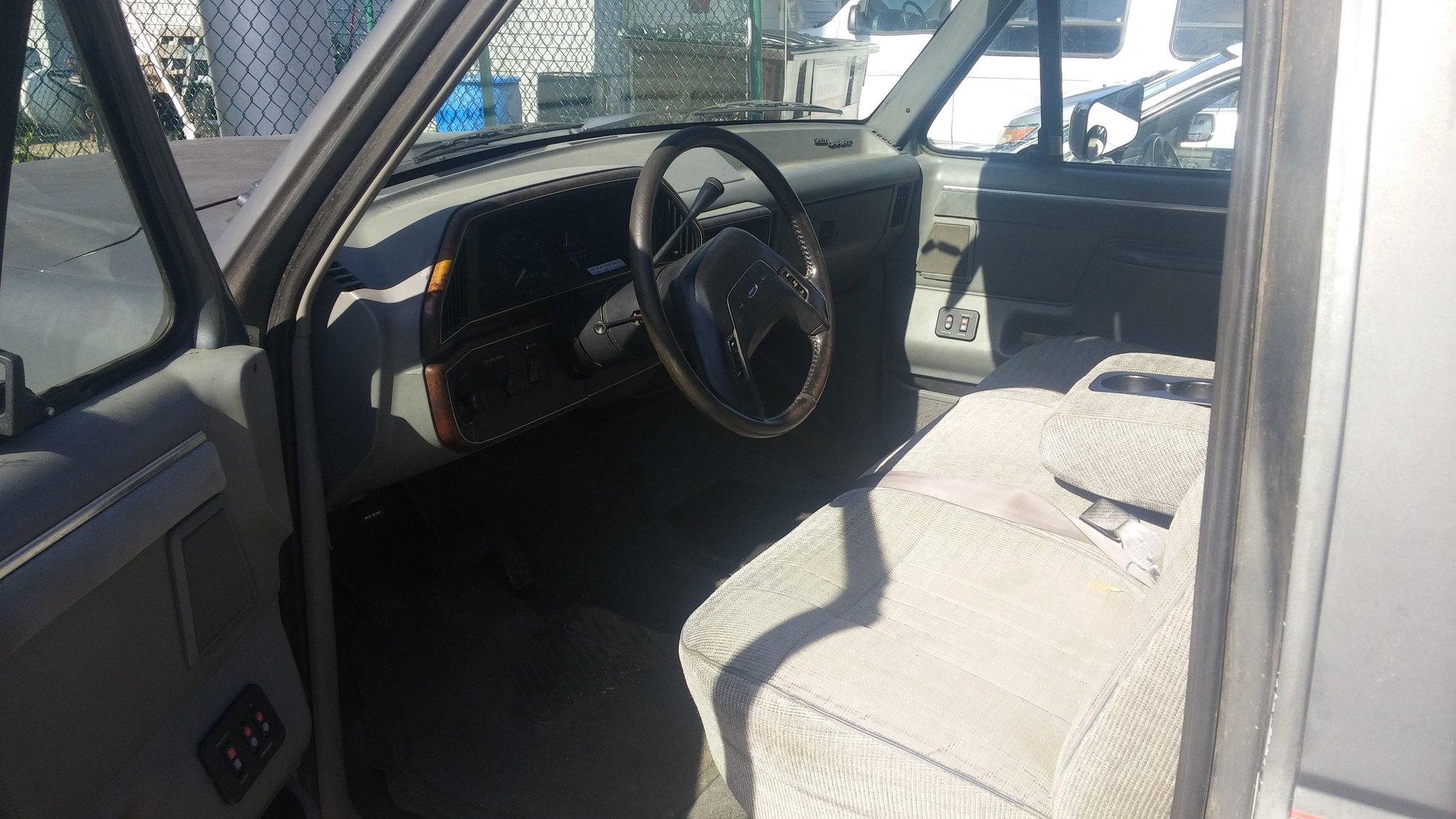

Int off the doner

As the one truck is a incomplete chassis, the frame rails may be different rear of the cab. That means the bed may not fit correctly to the frame.
Old Jun 17, 2015 | 05:50 PM
madMatador78's Avatar
madMatador78
Joined: Dec 2011
Posts: 2,750
From: Pecatonica, IL
Yeah I've been told the bed won't work. My plan was to put a flat bed on it.

the 350 has a 33 inch wide frame rear, the 150 has a 36 inch rear frame.
what i do is swap the cab and put the VIN plate and all the diesel wiring from the 350 in the 150 dash, and remove the warranty tag on the door pillar. i have never had any luck swapping the warranty tags. .
basically the same thing you would be doing if you bought a cab from a junk yard, because when you buy a cab from a junk yard they do not come with a VIN plate or title. .
