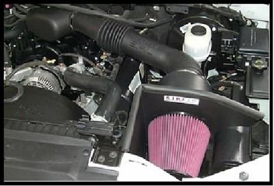

I googled for a generic CAI on our V10 for a picture. I found this:
I don't know what cold air they are talking about...it draws air from directly under the hood. The stocker doesn't...it's the true CAI.
