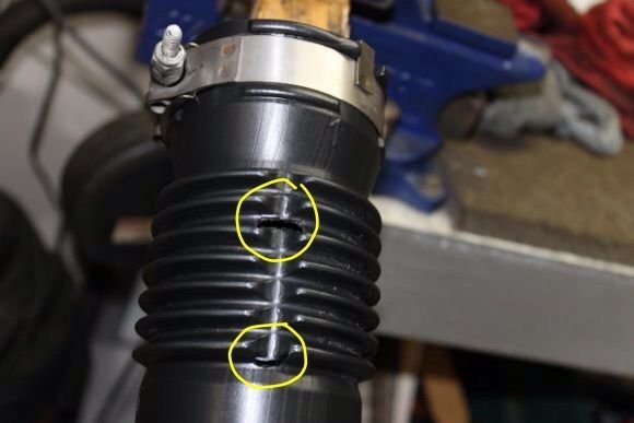

I've seen this a couple times now, the plastic splits on the cold side CAC tube under the air filter. Definitely makes an air-whooshing sound at higher boost levels. If this turns out to be the problem, a nice upgrade is the early model metal tube and boots. Riff-Raff sells a kit with their a/m boots, or if the budget is tight Ed at Ficmrepair.com has a nice price with the factory boots.
If that looks ok check the other boots, the one on the turbo outlet often splits on the bottom where you can't see it, and peek under the filler panel in front of the radiator and see if the o-ring is hanging out of the CAC it's self where the plastic end caps meet the aluminum core section. If all that looks ok it could also be an exhaust issue.
In the picture, I'm flexing the plastic pipe to open up the holes, it's pretty hard to see and I may not have caught this without pulling the pipe out.
Kinda funny, when I found mine I ordered a replacement and figured I'd tape it up until the big brown truck came. I had some "F-4" self vulcanizing rubber tape I thought would hold it so I gave it a couple layers of that and came back over it with some electric tape stretched real tight and put it back in. It worked for a while but the first time the boost came up good it started making an amazingly loud squealing sound. After that, it would squeal every time I touched the go pedal. I drove it several miles home-through town with it squealing like some sort of alarm was going off. I got a lot of looks on that short trip .
