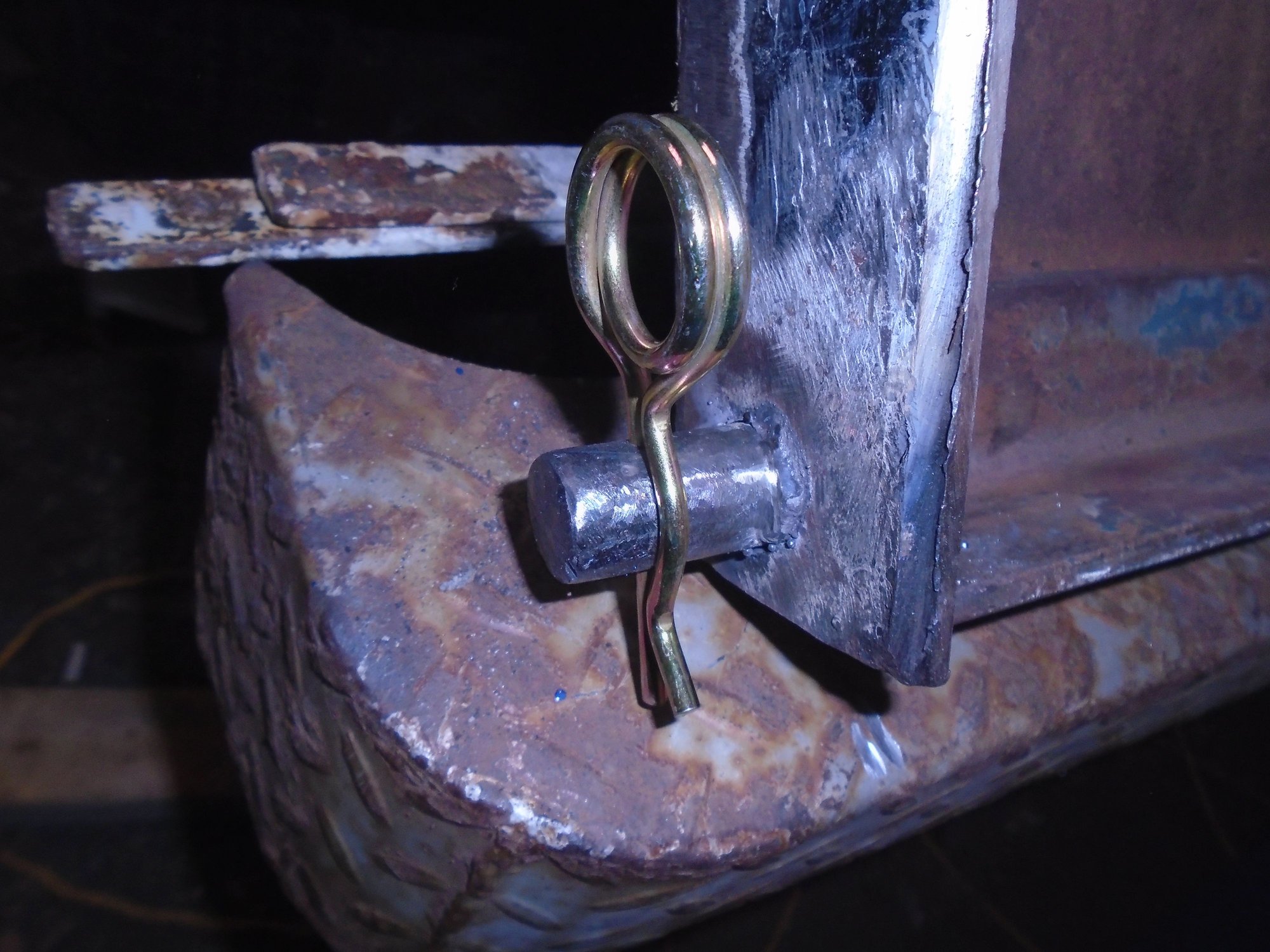

Spring latch pin on passenger side only good pic of it. put spring on bolt and welded bolt onto 1" x 2" plate that's welded to pin, pin is concrete stake. Spring rests against C channel and plate on spring
holes are 3/4"

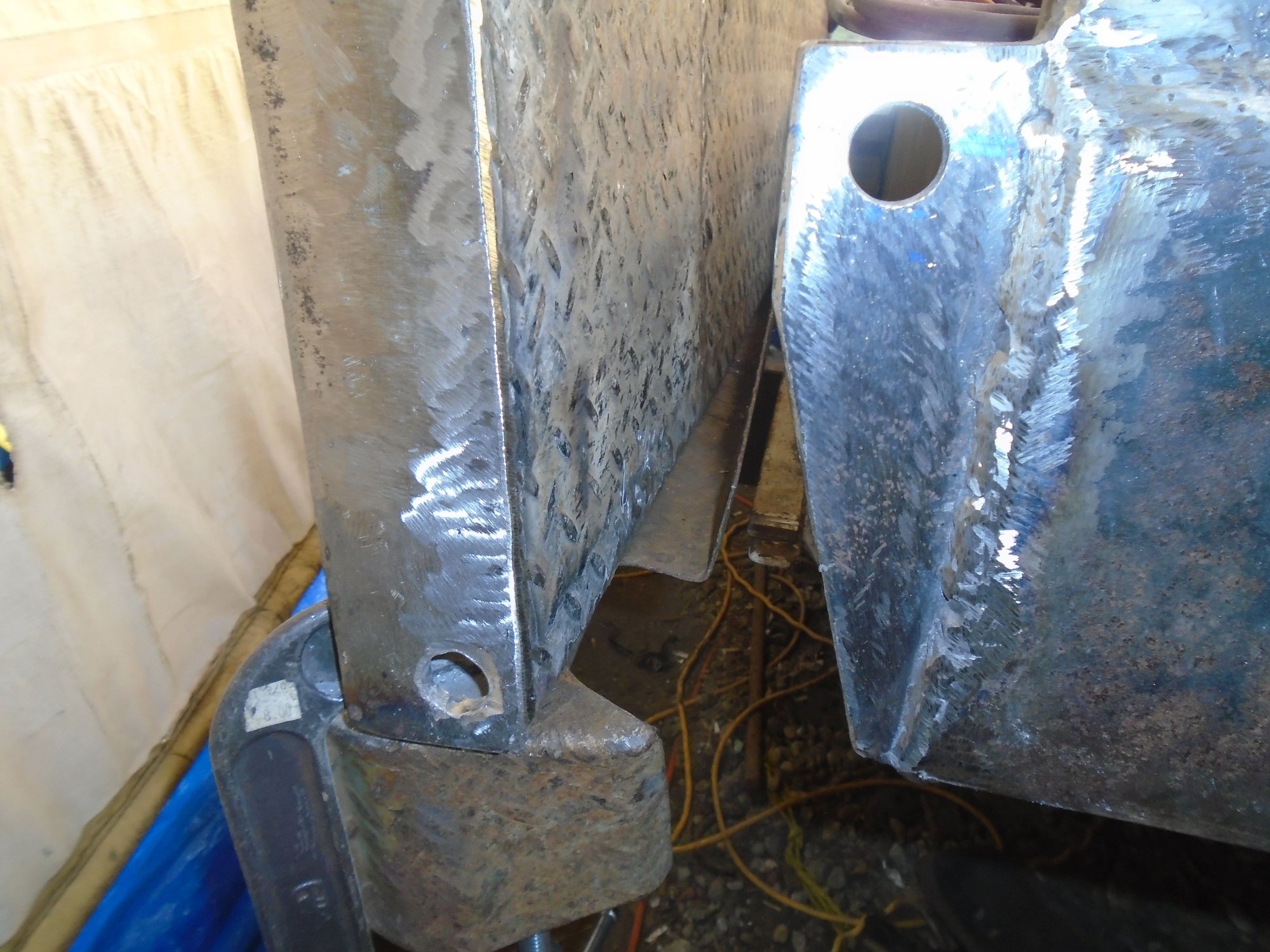

pin on drivers side welded to tailgate from inside

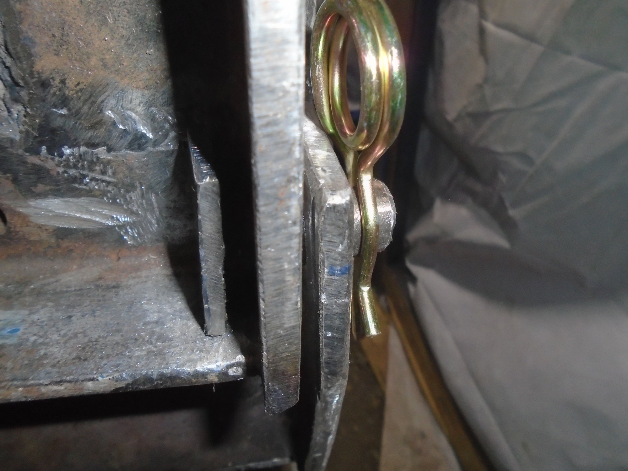

plate on spring pin, need to dress the pin down 1/16" to make it easier to take off gate. I've got more pics but need to go through them, post if you need a better explanation or more pics, I'm a bit distracted right now and will have more time tomorrow to properly answer your question.
