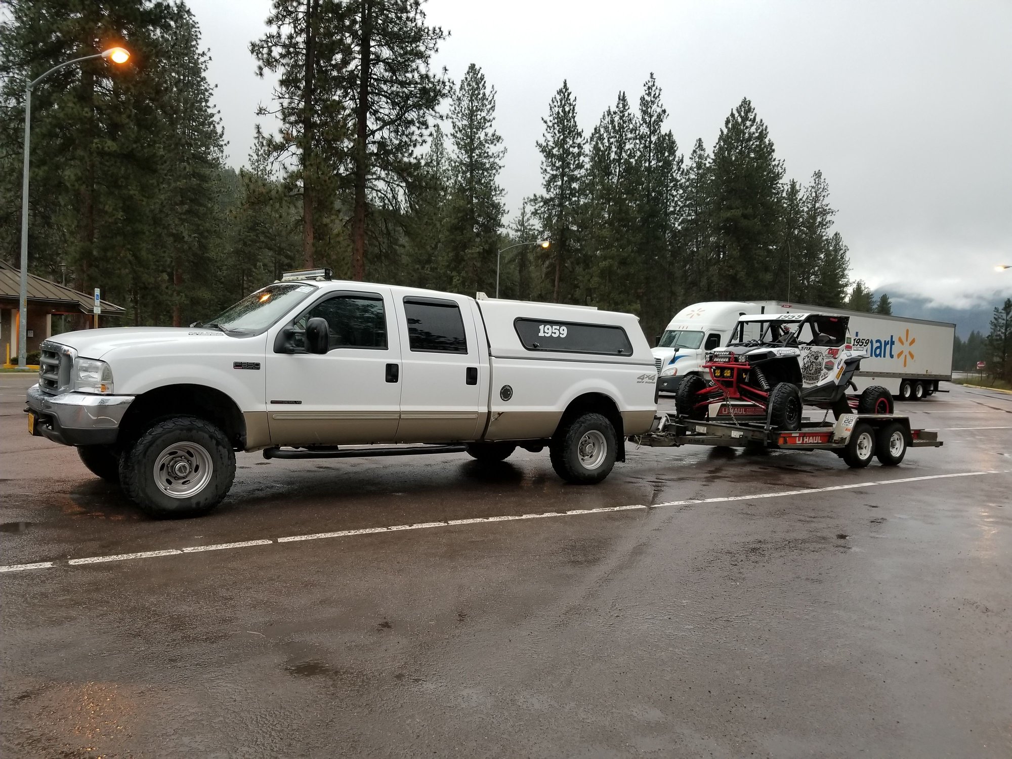

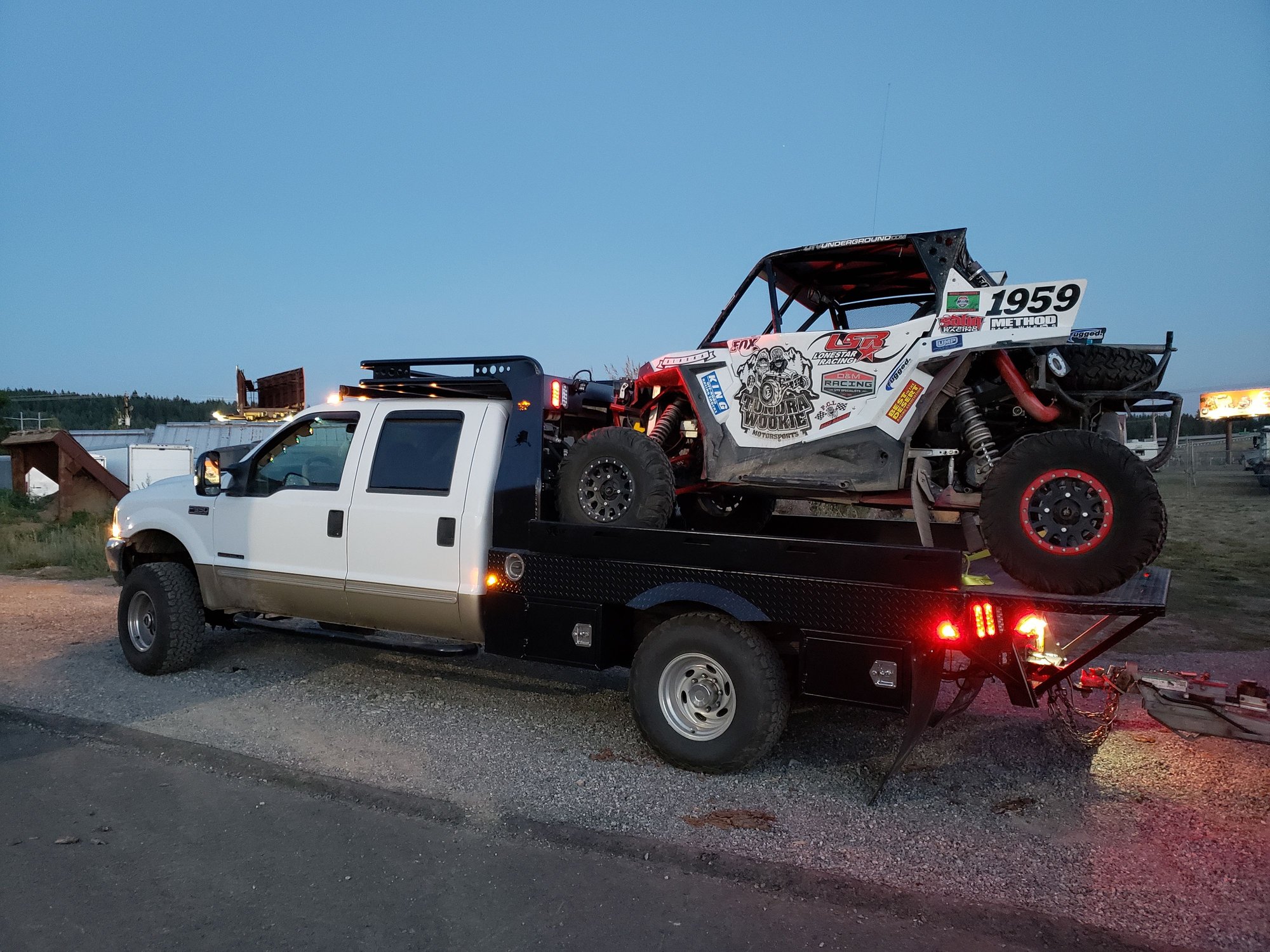

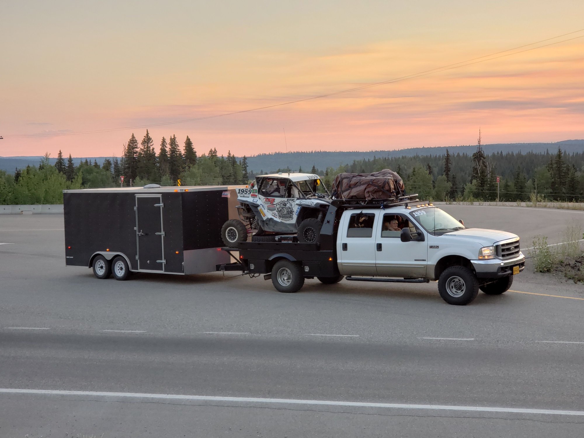

I can't really speak as to weight savings in comparison to the stock bed, but I recently had my truck converted to a flat bed for the sole purpose of being able to carry a RZR 1000, on top of fuel and a cargo rack on top of the cab. I went pretty much all out on it. I also spent about two years thinking and looking for something I wanted. I almost went with a pre made setup but I waited it out and spent more on custom.
I did some research on bed versus a rack setup that would fit in the bed, or a trailer. A trailer would be the logical solution for the average person, but I wanted all options available to me as the truck will probably be put to use for other things such as carrying lumber, goose neck towing, pallets, snow mobiles, etc. At any rate, I ended up with Silver Lake Manufacturing. Father/son shop, small time guys but incredibly genuine and busy. People I had spoken to regarding some of their products said they were very pleased.
Ended up dropping off my truck with them while I went to work in Alaska and picked it up as soon as they could finish it. Long story short, I'm very pleased with it. I plan to keep this flat bed and move it from truck to truck if I even upgrade down the road.
They have a website and a Facebook page. I spoke with them mostly through Facebook, and they also have lots of sample work on their page.
Trailering to Spirit Lake, ID.
Driving back to Alaska a few months later.
First try on loading the RZR. Hideaway ramp and winch on board.
In Alaska, going out to do some clutch testing.
Unloaded, with two foot extension bolted on.
Example of loading.
