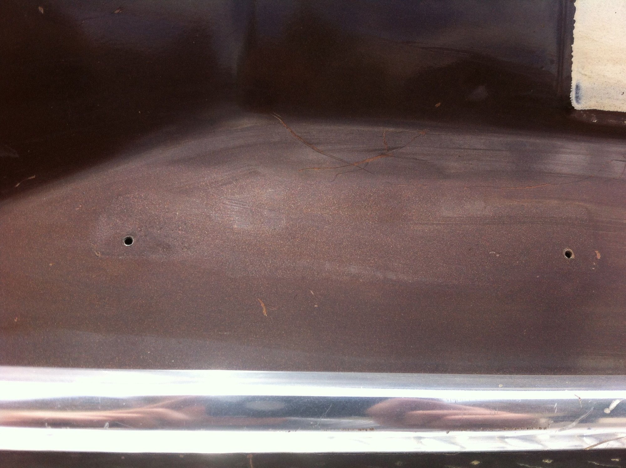

Hi, new to posting but have been searching the forums for a while now. I have a 75 F250 "Highboy" that I have been restoring over the past few months. Just putting all the emblems back on and realized one is missing. I am unsure about what goes there though? The holes are located on only the drivers side cowl and are 3/32" to 5/64" in diameter and placed 3.75" apart. I have both F250 emblems on the fenders and both Ranger emblems on the bed. Thanks in advance. Attached is a pic of holes.

Has the cab been changed? 1975 didn't have any emblems on the cowl, they were on the fender like yours currently are.

To small and to far apart to be for a regular F250 Ranger or Custom badges and yes they did not go there on a 75 anyway.
CS badge was on the front of the fender under the side marker light on 78/79 CS and or yes under the F250 on the fender like in you pic on 73-77 CS.

Interesting. I would say that someone drilled those holes there for some reason. As Shane said, for that truck the F250 emblems are in the correct spot on the fender. If there was a factory badge missing, it would have holes on both sides, not just the driver's side. And even if it was a newer cab, the F150/F250/F350 CUSTOM/RANGER emblems require four holes, not just two since they had 4 pins on the back of them.

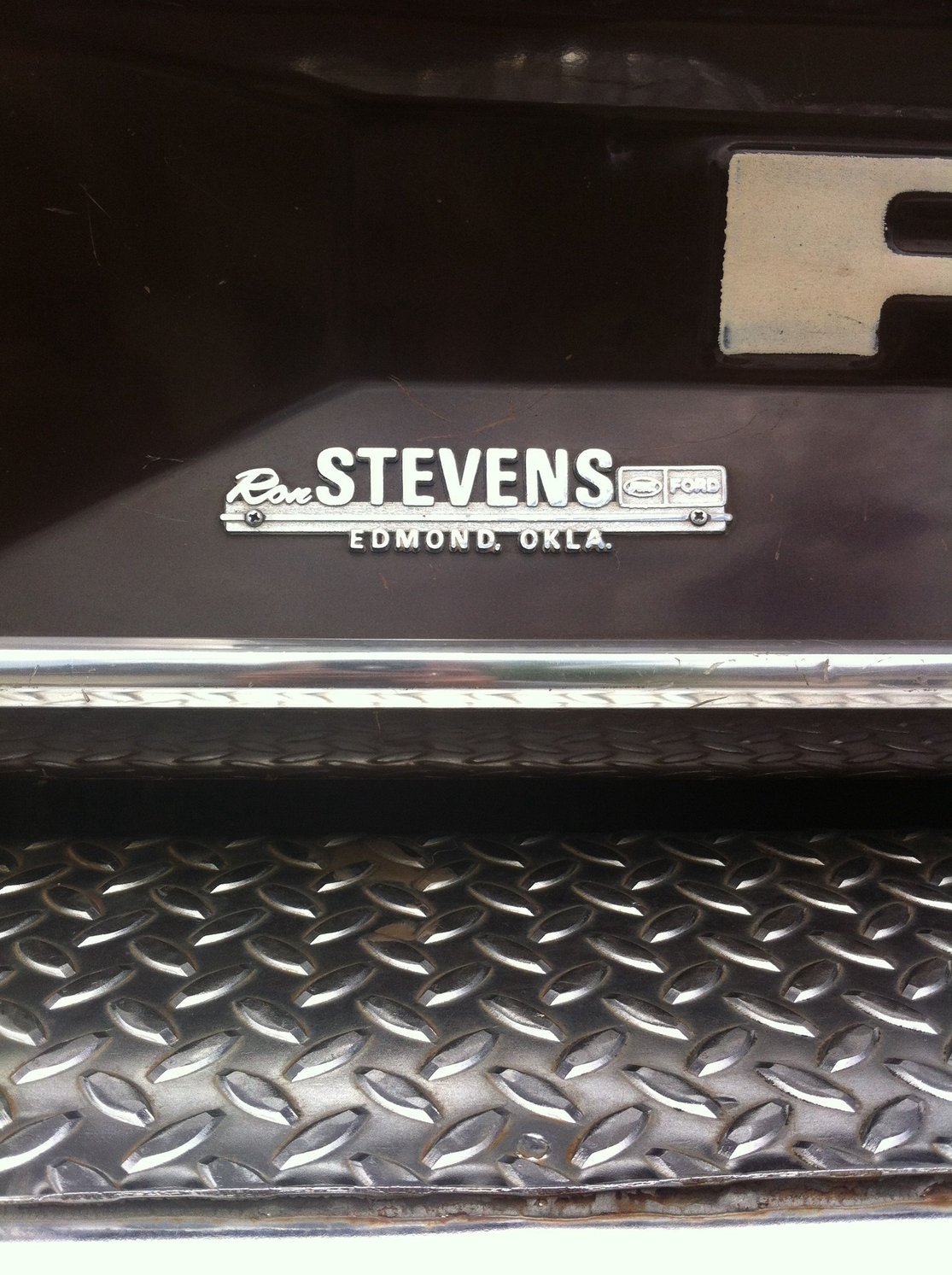

Looks to me like a dealer badge.
My 78 has this one -
