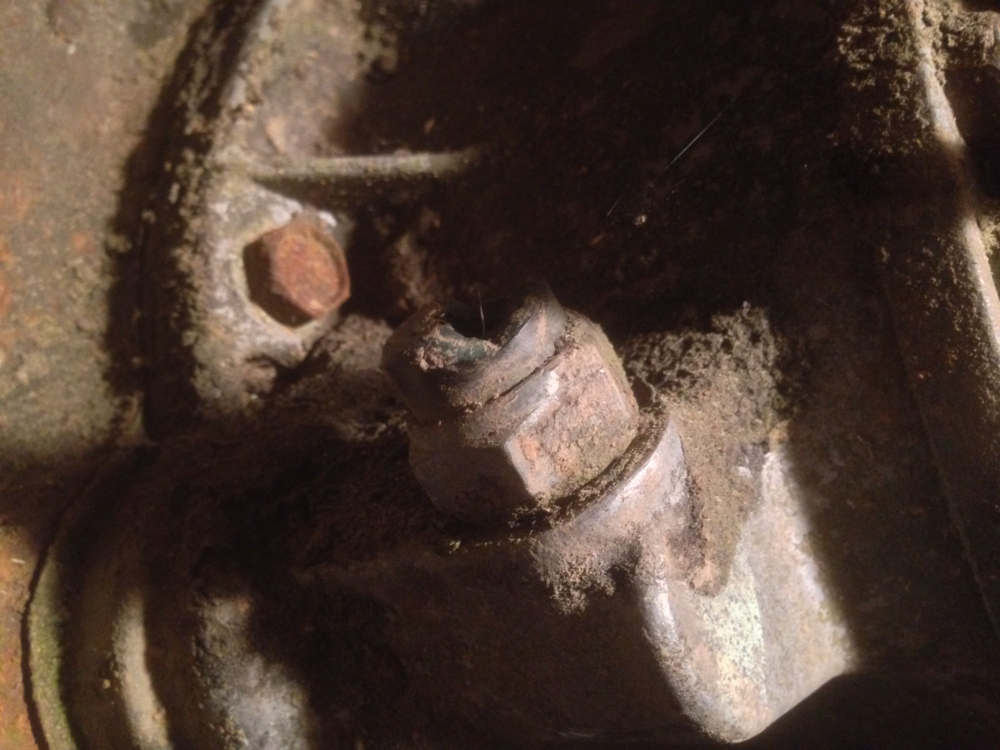

Can anybody tell me what this is? Switch or sensor or somthing?
Old Jun 13, 2015 | 08:10 AM
hickory1991's Avatar
hickory1991
Joined: Feb 2011
Posts: 1,410
Likes: 42
From: Michigan
If your talking about the cable going into the transfer case it is your speedo cable.
Old Jun 13, 2015 | 01:11 PM
ZarK-eh's Avatar
ZarK-eh
Joined: Sep 2014
Posts: 862
From: like subarctic, brrr man!
Looks like a sensor or switch to power a "4x4" or "lock" or "4-lock" light on your dash.
Old Jun 13, 2015 | 05:59 PM
herbiemin's Avatar
herbiemin
Joined: Apr 2015
Posts: 142
From: Albertville, AL
That's what I was wondering...didn't know if these trucks had a 4wd indicator or not

According to the Wire Schematic, it's descriptions are:
"4 Wheel Drive Indicator Lamp"
and
"Differential Lockout Indicator Lamp Switch"
Not sure of it's operation, and my NP205 doesn't have anything so guessing it's for the NP203. Either Lock and/or 4x4 operation.
edit: Also, the Lamp is fed by Fuse 10. C-416 and C-417 indicate a single wire is used and the switch supplies ground to complete the lamp circuit. C-416 L.H. Side of Engine Compartment Near Dash Panel Wire 210 Blue. C-417 On Transfer Case Wire 210 Blue. And I thought that blue wire might be for trailer tow lol

Old Jun 15, 2015 | 05:32 PM
herbiemin's Avatar
herbiemin
Joined: Apr 2015
Posts: 142
thanks a lot!
