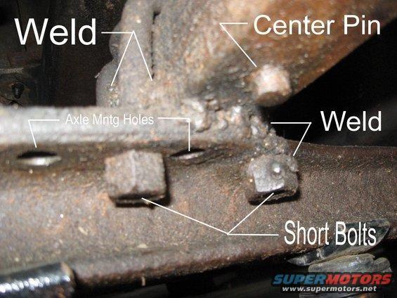

The previous owner of my 48 F1 replaced the front axle with what appears to be a 53 axle that is a couple of inches longer. When he did this the springs do not sit on the spring pads, so he welded the spring u-bolts to the springs.
I bought an actual 48 F1 axle to put in but my question is this. If I cut the u-bolts loose will the springs still be safe to use? Would the heat from welding and cutting the springs loose weaken the springs ?

As promised pictures of the PO's handy work. Sorry for the picture quality I got a little to close. As you can see the u-bolts are to short and not parallel with each other, nuts welded to axle, bolts welded to springs, spring center pin not over axle. Because the axle is longer the springs don't sit on the pads, u-bolts don't align with holes. The list goes on and on.
I already have the proper axle, new king pins, disk brake conversion, set of 5 on 5.5" wheels and tires. Still need to find some springs and new linkage.
Oh and the front wheels had the center hubs cut out and welded back together with hub caps over them to hide it.
