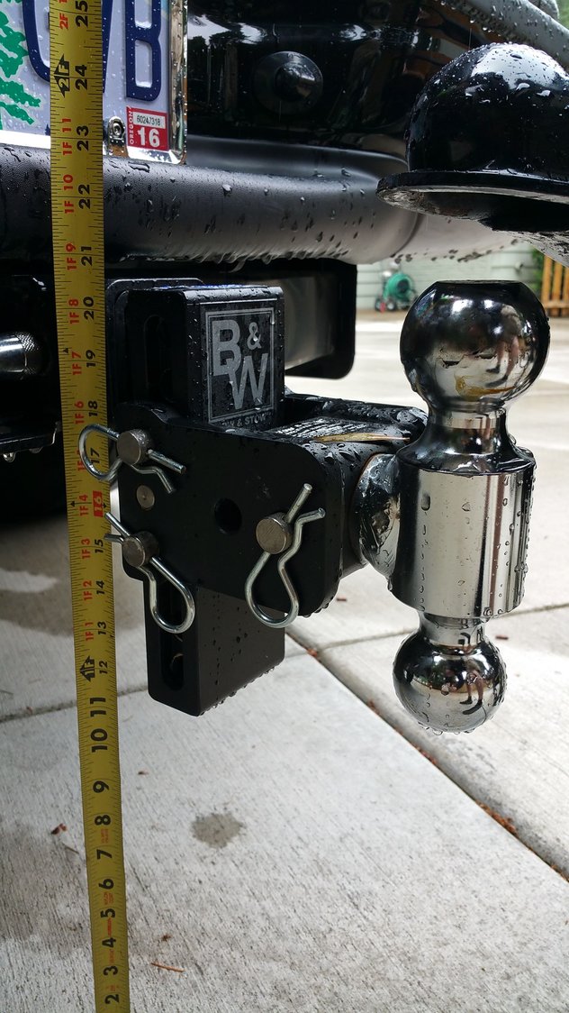

Thanks for bringing this back up. Here's the pic I took but failed to post.
This is with modded B codes and stock 265's
I'm right at 20 1/8" to top of tube opening.
That puppy set you back more than $19.00
OP, needs to get a trailer one way to his new location. I know this my not work if he's to tall BUT a tape will tell. I've run a mount as high as 22" for a heavy trailer (the squat takes up the slack). I really like your set up BUT that much metal that low in the rear does not work for my driving style.
My setup might be closer to what David (the OP here) is running, I have modded B codes, F-350 tapered blocks, 2 sections of the old slapper traction bar and 35.28" tires. My ground to rear fender well lip measurement is 45.5" and the top of my receiver opening is 25 3/8" from the ground.

With Tom's hitch height, it would take an 8" drop to get a u haul trailer level.
Mine is not the most cost effective.
I actually ran the one that's 2" less drop for along time. In anticipation of my 18 HD wheels and larger tires that accompany them I sold my old one to a guy and put this one in. I leave it on all the time but I've only towed twice with it in the last couple weeks.
