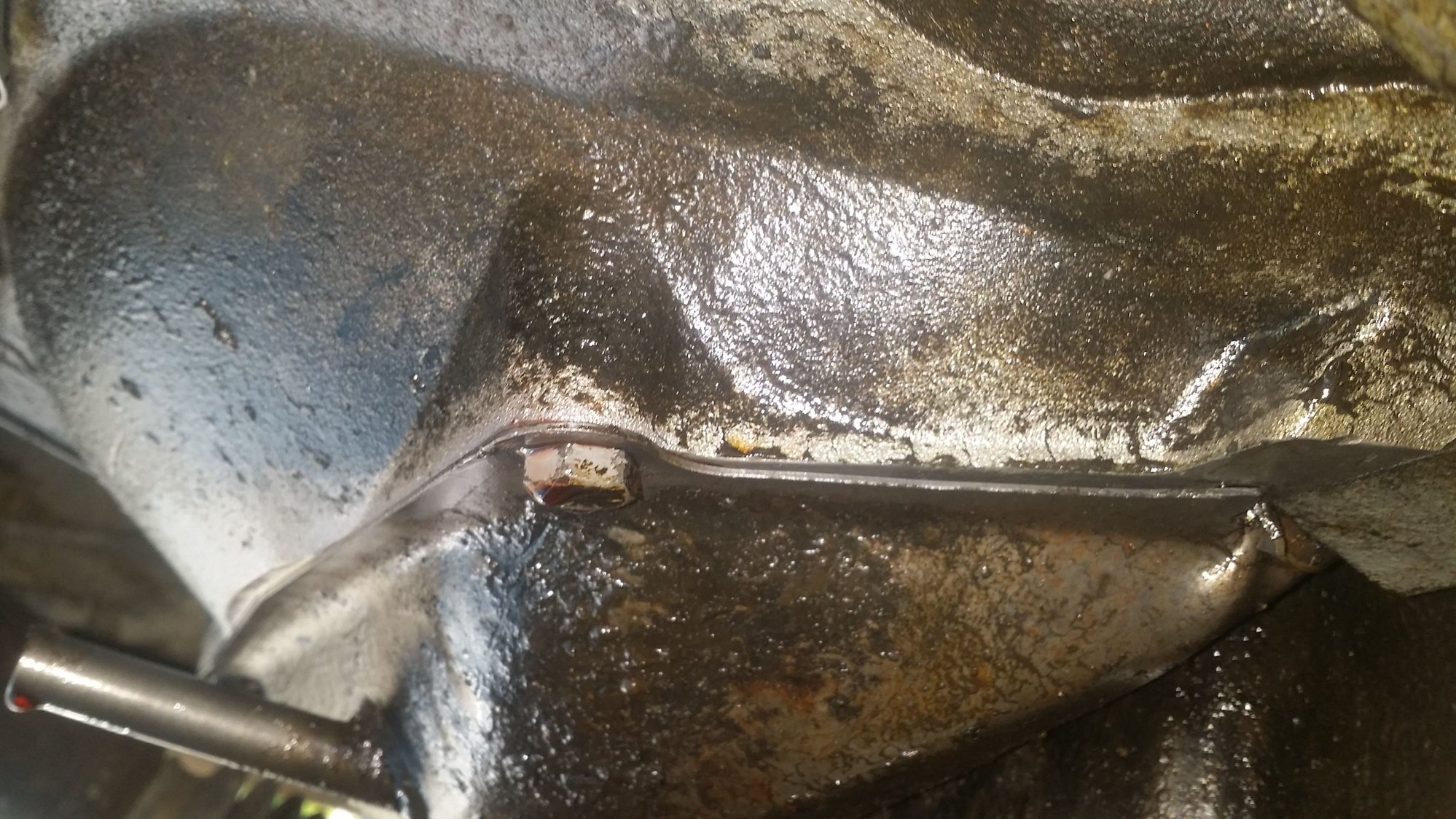

I took it to a reputable transmission shop for a flush and filter change/ inspection and to get the cooler lines at the radiator replaced because they were rotten and leaking transmission fluid all over. $200 was the cost. Get home and notice that there is quite a leak ,but unsure where from. Called the guy we discuss it and I end up finding that the pan bolts were merely finger tightened. I could turn all but one with my fingers. So I snug them up and am keeping an eye on it. Still leaking. The guy says bring it back. Ok, I'm gonna. However I would like to go loaded for bear I have turned many a wrench but never transmission work and never diesel nor 4x4. I've had this truck for about six months. Something doesn't look right. (See pics) I see shiny metal. And it looks as if there are no gaskets
? Like I said, I don't know much about this subject and any help would be appreciated. Thank you
What is that thing protruding with a drop on it?
Upper right corner of photo(bare metal) is odd looking to me

The first pic shows fresh fluid leaking from the bellhousing drain tube. That would be a leak at the front pump seal (transmission input shaft basically).
Second pic, another view of the bellhousing access cover. No gasket required there, it's just to keep trash out of the bellhousing.

More pics
Please ignore the redundancy
More shiny metal
What is this part? There is a noticeable gap

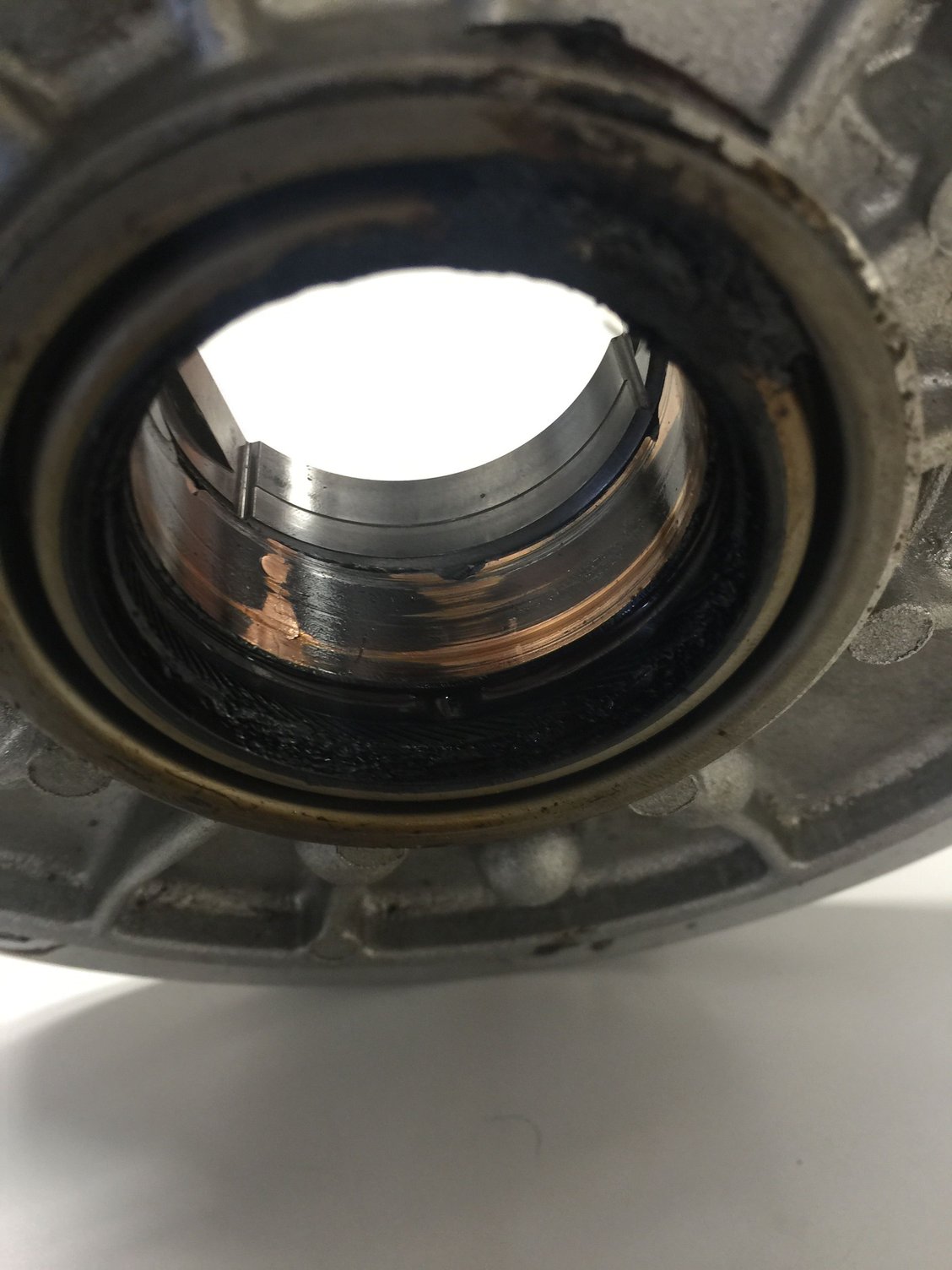

It's probably leaking right from the pump gasket,

As far as the engine, if it runs good and pulls good and doesn't drink oil, I would say just drive it and nut worry about it. As for the leaky trans, I would just try a seal replacement and see what happens. Now if it looks like Puddy's, that's a different story. And you won't know until you crack it open.
