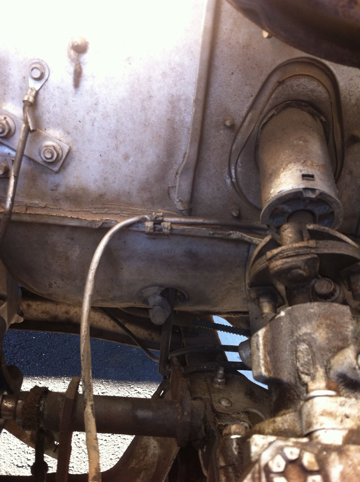

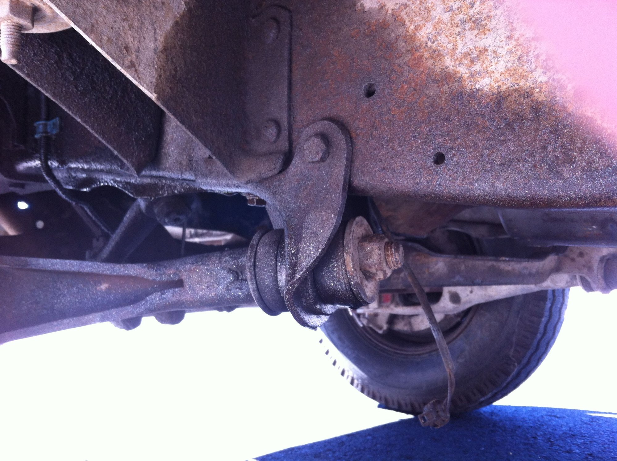

Leak began right after I turned off engine, stopped after just a few minutes. Slow leak, looks like oil...I don't think it's brake fluid, but it's running down break like. I've attached some pics...let me know if you need more info.
Brakes feel a little difficult in slowing down truck, but like I said...looks more like oil.
78 f250 2WD, 300.
dripping from this area, but I think it's coming from something else.
different angle of first pic; you can see the drip here.
brake line? Fluid in master cylinder is normal.

I didn't realize that last pic was so blurry until I uploaded it. I'm going to go outside and take a few more pics. Also, what cord is that hanging down (in the first 2 pics)? Haven't noticed that before.

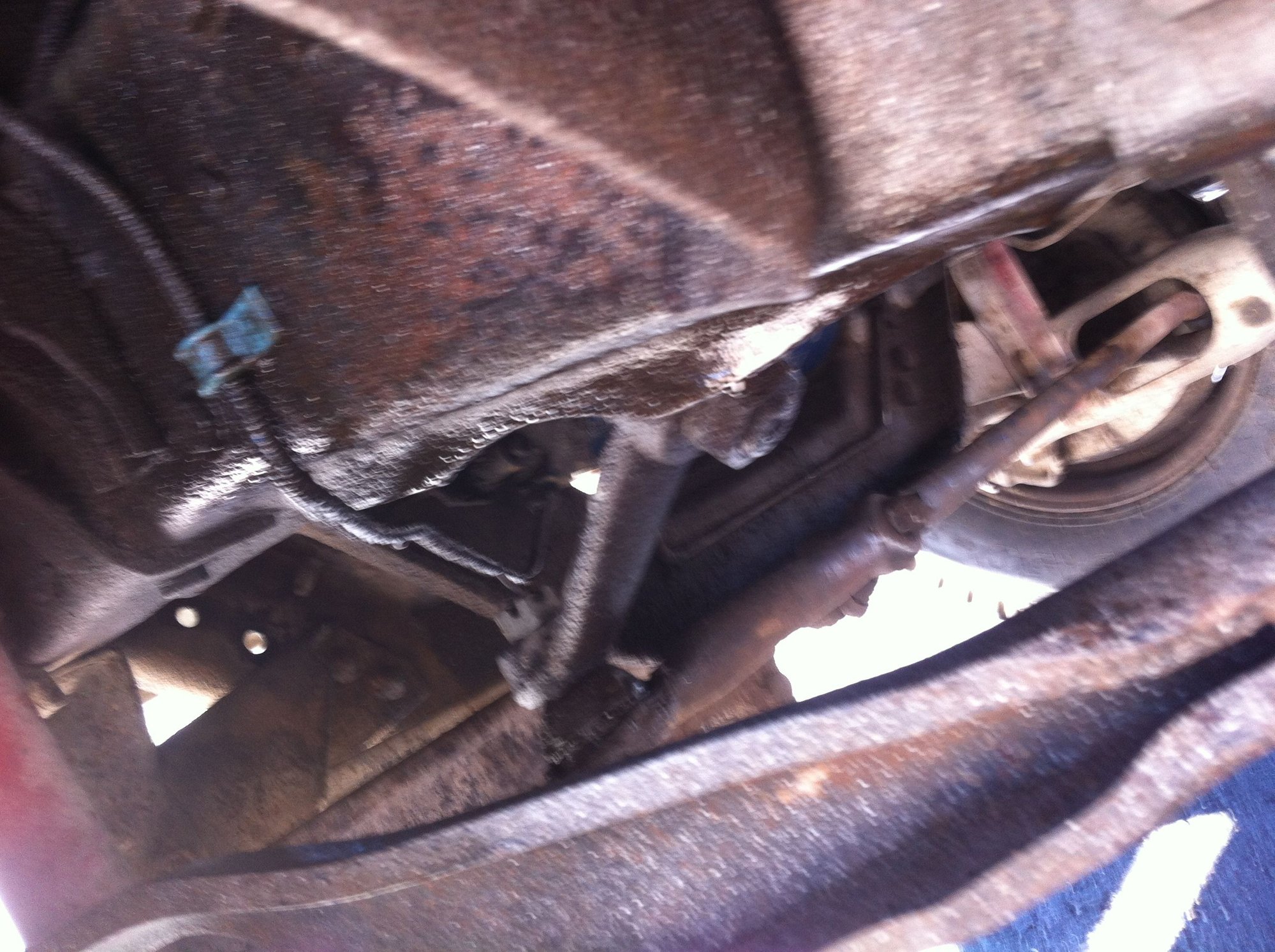

more pics of leak
Here are a few more pics. It's definitely oil, but I can't locate where from. Also, took a pic of that wire hanging down inside engine bay.
reference where the leak(s) are hitting the ground in relation to driver side front tire
the cord hanging down from engine bay. No idea what this is to.
leak
noticed a little oil here, too, running along that seam. not dripping at this point though.

Power steering?
In that location, about the only thing is the steering box.

hmmm...possibly the lower hose. I just replaced the pressure hose, and I'm positive it isn't leaking. Lower hose was not replaced though. I'll go check the fluid level in a bit.
Any ideas on the cord? I don't see a place where it might have come loose from.

If the leak is at the steering box, it's a good chance that it's the box itself leaking and not the hose(s).
Very common for either the sector shaft seal or input shaft seal to leak.
What colors are the two wires that are hanging down?

It must be the box. I just checked the level and it was really low. The lower hose does not show signs of leaking.
Looks like I know what my next project is for the weekend. What's the difficulty level in replacing this part?
As for the wire, it's a white color. I'll have to get back in there and take a picture of the end of it (should have done that in the first place).
Oh, and someone else asked about a smell...there isn't a strong smell to the liquid. It's almost clear, very thin.
Look again, there are two wires in a common sheath. Clean the individual wires.
I looked at the wiring diagram. That plug looks like it's connector C-330. If it is, there should be a blue wire and a red w/ yellow trace wire.
That wire goes to the throttle kicker that was only used on F150 w/ manual transmission and a 302. So, in your case, it's not used.
