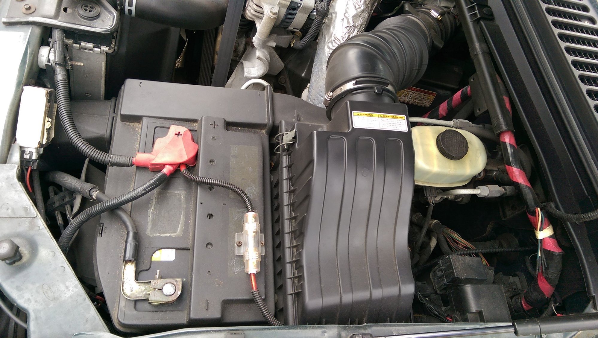

On my 02 Ex, I was troubleshooting batteries and learned the small extra cable on the driver's side positive terminal powers all lights, dingers, probably PCM, etc.
Maybe you can check this, if it is the same?
In the pic above, there is one extra cable on the positive terminal, now removed (powered a massive amp from PO)- the one with the inline fuse.
I had removed the other small cable today as a test and the whole truck was "dead". Learn mode "on"
Hope this helps!
