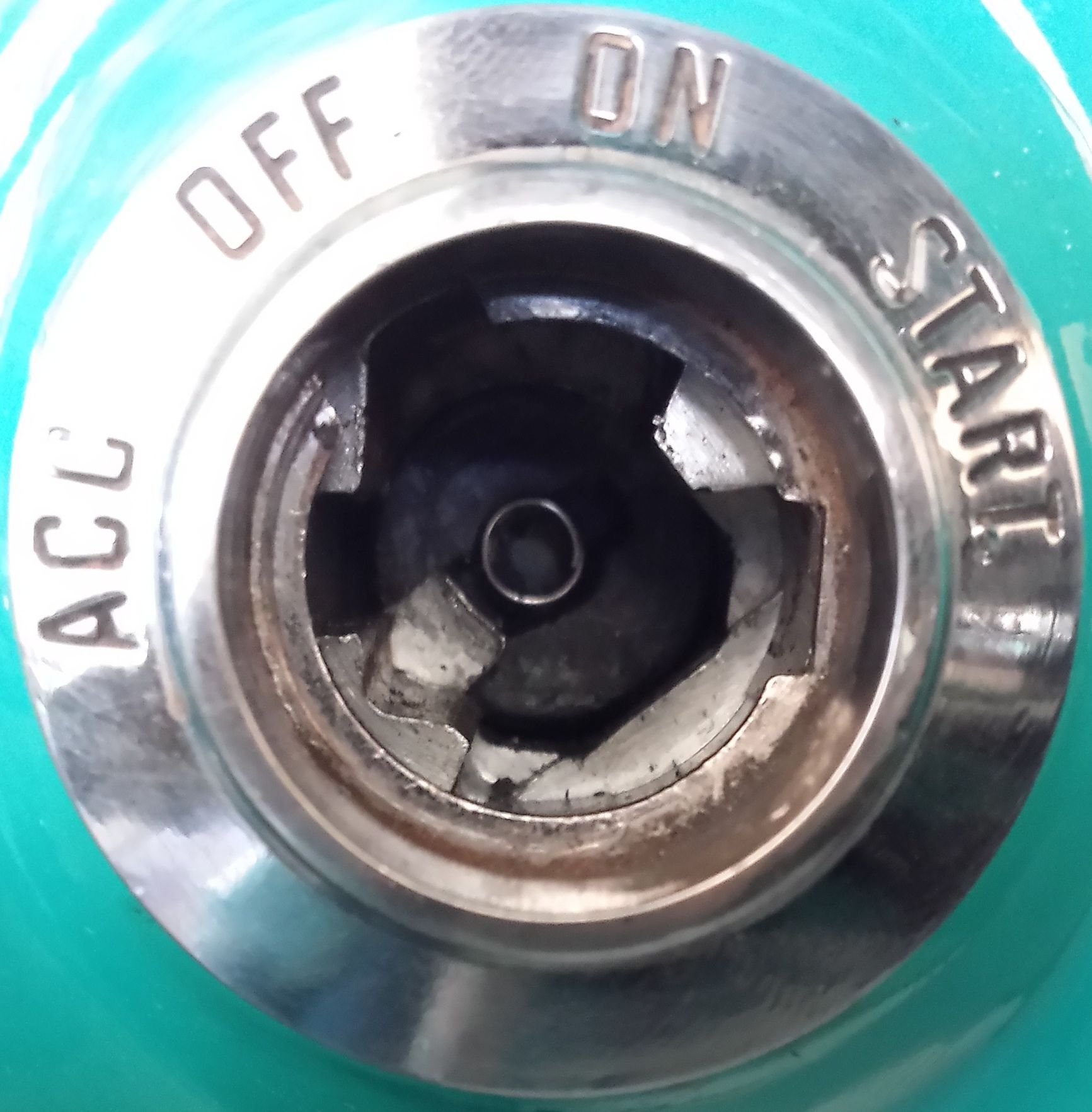

The person that finished the dash on my f250 did not install the ignition cylinder. I am trying to install it, but it won't go. I think the alignment is off with the other parts. Attached is a picture of what the alignment looks like inside.
Would someone happen to have a picture of what it should look like inside?
Thanks

Thanks. I have those pictures.
I originally took the cylinder out using the correct method, but that was 3 years ago. I had someone else do all the body work for me, but he didn't put the cylinder back when he restored the dash area.
I think the alignment in the back of the switch is off (ie at the wrong angle). He started it with a screwdriver to give it back to me. I have the cylinder and key, I just need to know what the inside alignment should look like.
None of my books show the inside alignment and none of the youtube videos I have found so far show it either.
Thoughts?

Here are a coulple of YouTubes I think you'll find helpful.
To minimize any confusion, before you start twist the switch housing around until the "off" position on the bezel is straight up. Make sure the three tabs of the spacer behind the dash are positioned properly in the slots in the dash behind the bezel. You may have to wiggle the tumbler a bit (DO NOT FORCE) but eventually it will go in after which you will insert a paper clip or something and turn the key back to "acc". Never mind that these films are about Mustangs- the procedure is the same.

So the solution was that some how the body work guy managed to put the bezel on wrong. He had wedged the large pin in the small slot. It was a pain to take out.
When it was out I made sure the alignment of the slot in the back of the switch was set correctly with the cylinder. I put the assemble back together correctly and the cylinder snapped into place.
Thanks everyone.
