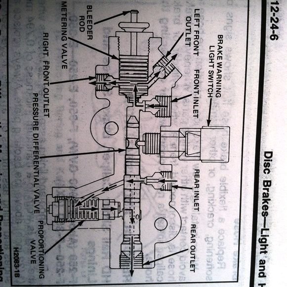

As promised, no idea why the orientation came out like they did on the post but nonetheless they are there.

So to confirm, you removed the hose at the rear of the master cylinder (at the master cylinder) and bled this never letting the fluid go dry. then reattached hose at the master cylinder, then removed the hose at the prop valve inlet (green circle) and bled that portion of the line, then install the line back to the prop valve inlet (green circle) and cracked and bled through the prop valve each (red circle) oulets individually, then removed the individual lines at each caliper and bled them individually, then hooked them back to the calipers and bled each one individually? Every union must be bled. otherwise you'll skip something
I know you bypassed the prop and went to the troubled caliper. The above was the recommended was to diagnose your problem area, however the bypass should have actuated, the caliper (as long as it was properly bled and absolutely zero air in the line, if there is air in the line you are simply compressing air) with all this, it leads me to believe that your master cylinder is not functioning correctly. Don't give up, I have been there many a time, but my determination and perseverance always got the better of me. However....before I bought the master cylinder I would do the paragraph above, if it doesn't work then you know you done all you can do with the current cylinder, it may have a weak seal. Install and repeat.

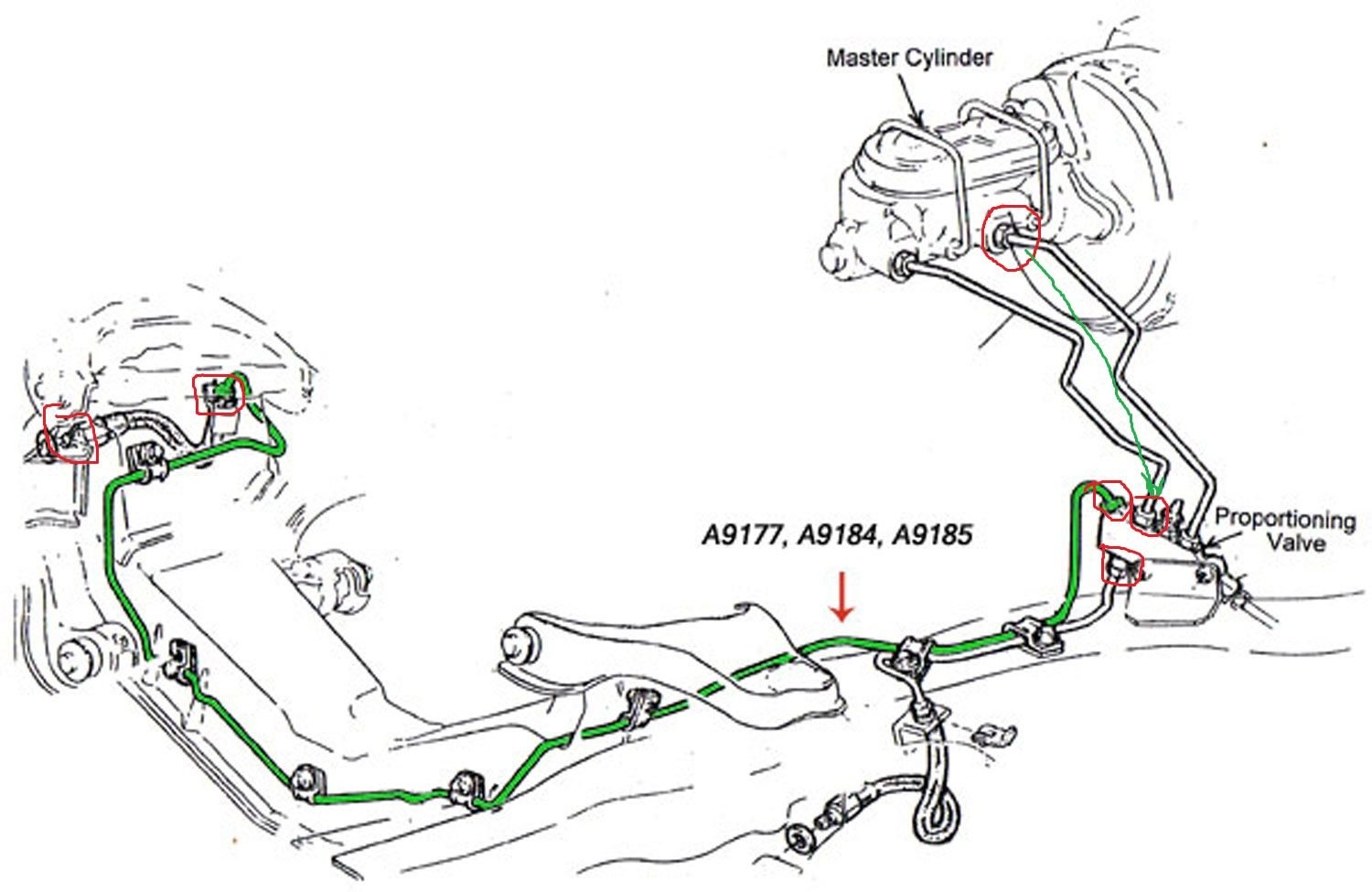

So I have no idea what vehicle this pic is from, but it is close enough for this purpose (the green arrow shows the flow this one had the rear line to rear brakes, but I fixed that), every red circle is where you have to remove and bleed to, starting at the master cylinder, work you way down the line to the caliper with the caliper being the last thing bled.
