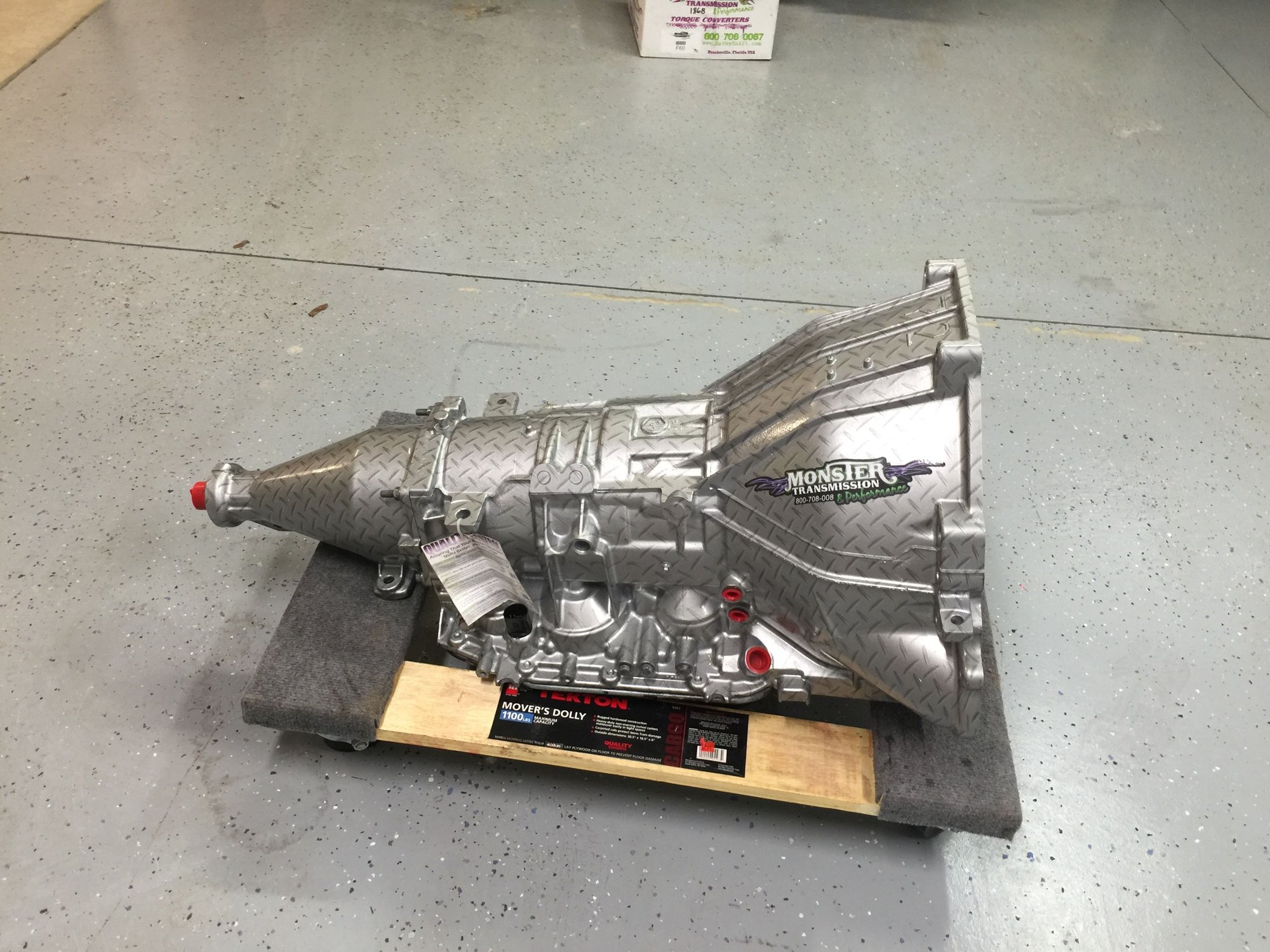

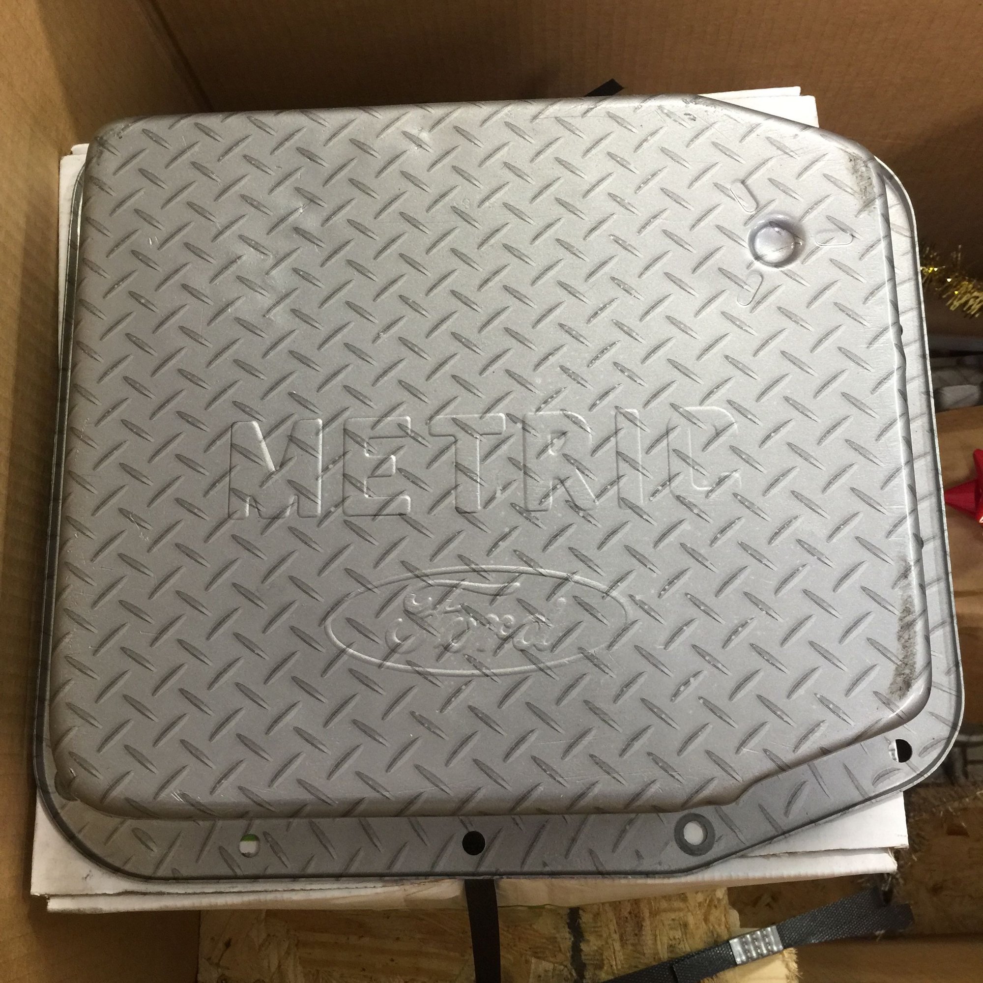

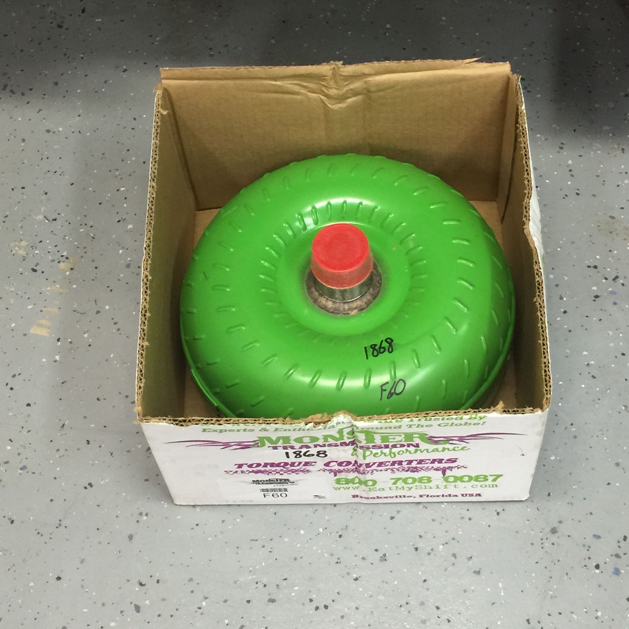

My 4R70W came in from Monster. It looks great and the folks there were quite helpful and pleasant.
They even added some Christmas cheer.
