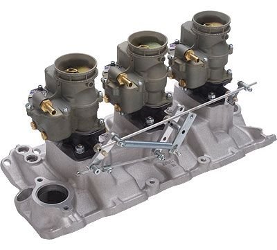

Here is another pic to help illustrate the parts I linked to - it is a triple 94 setup and uses a progressive linkage - again not your situation, but these are the parts you need:
3x94 - note linkage on extended shaft. Rear carb has linkage setup that can work with AOD TV cable.
So you can buy the extended throttle shaft from Speedway I linked in my post above and install it in your carb base. It is a pain in the butt as the butterfly screws are staked and the throttle arm is pinned, but it is definitely a DIY type of job. Then you can install the throttle arm I linked to (just like the one on the rear carb of the 3x94 setup) and use that to operate the Lokar cable.
There is no requirement to run multiple carbs - it is the linkage. The extended shafts are NORMALLY used on multiple carbs, but can be installed in any carb.

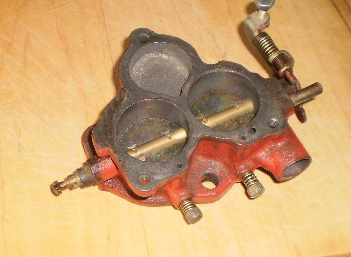

Find an 8BA truck carburetor (or just the base) with the long shaft for the hand throttle cable. Then you won't have to drill out the side of your carburetor base. Make sure to NOT get the older carburetor with hand throttle linkage since the base lacks the vacuum passage for your distributor. Removing the throttle shaft is annoying but very do-able.
Here is the type of carburetor you need (not this one though, it is hilariously high priced)
http://www.ebay.com/itm/NOS-OEM-FORD-USA-V8-Truck-PICKUP-1948-52-8RT-9510-F-94-CARBURETOR-F-1-2-3-4-5-6-/141511993939?hash=item20f2c5aa53&vxp=mtr

I have an ECC 2110 base with the extended shaft for manual throttle. It has larger bores than a 94 and has a spark control valve, but otherwise directly replaces the 94's throttle section. I don't see any way an arm attached to the short stub for the throttle cable would clear the bowl, but replacing the throttle shaft would be a snap.

Since I am probably months away from doing the transmission, I will probably try drilling mine and installing the new rod. If I screw it up I can always just get another base.

There is no need to "...redrill the base all the way through to the other side..." Unless yours isn't drilled all the way through? All the 94s I've had were...but there were so many variations, who's to say.

Time is money. How much is your time worth? How confident are you that you can do it in a reasonable time? It may well be worth it to have Vintage Speed provide a base...see if he'll throw in an aftermarket throttle arm for the other side (the side you need the AOD cable on).
Ross has the base that will work...
The price from Charlie does include the aftermarket throttle arm.
I believe all Truck models were drilled all the way, but Cars weren't. I had a Car base that was drilled all the way but sealed with a plug, too.
My concern with DIY drilling is that it needs to be very accurately drilled or the butterflies won't seat square. I wouldn't try it with a good drill press, that's Bridgeport work. The hole needs to be reamed to final size, too, and if the existing hole is not tight, then it needs to be a .003" O/S shaft and reamed to that. Vintage is offering a lot for that money.
That was my concern about trying to drill it myself.
