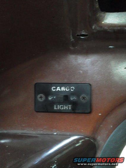

Yes the back of the cab cargo light controlled with a in cab B pillar mounted switch was an option.
It is controlled only by the pillar switch and not the head light switch (like my 99 Dodge bed light is)

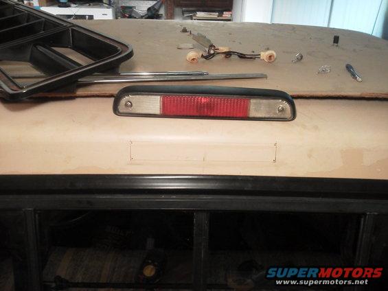

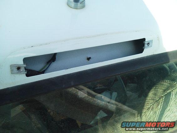

I installed a brakelight/cargo light on my 79 from a 94-96 ford pickup. I have seen the super duty lights installed too which might fit better and offer more aftermarket dress up options. The 94-96 light located in the right spot will fit the cab contour just right. I actually used two lights. I dremeled the light sockets off one so I could find the right location to fit the contour of the cab and mark the screw holes. I measured the opening on an actual 94-96 cab at the junkyard and transfered to my cab for cutting. Used dremel cutting wheels for the hole.
Got a factory cargo light harness and switch which plugs into the main harness behind the instrument cluster. Then ran a brakelight wire tied into the brake light switch wiring and to the light. the cargo light switch has a round hole in the sheet metal behind it-used a step drill bit. Then used self tapping screws to mount it.

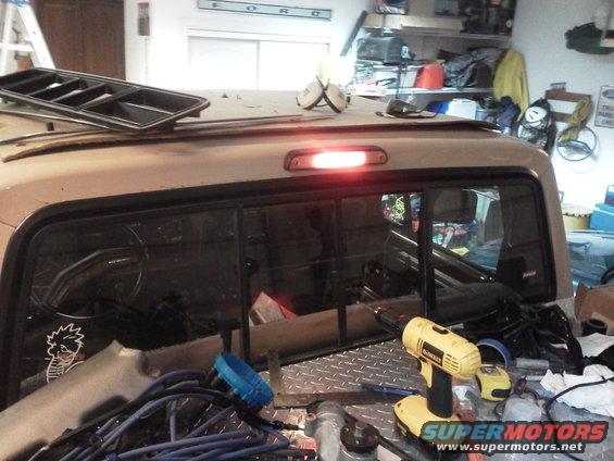

To make the cargo light also function as a 3rd brake light, you would need to change the 1156 single element socket out of the housing for an 1157 dual element socket and then install a red/white switch back LED into the cargo light housing and wire the added brake light circuit.
3rd brake light on my 1969 F100 Ranger using the stock cargo light housing.
