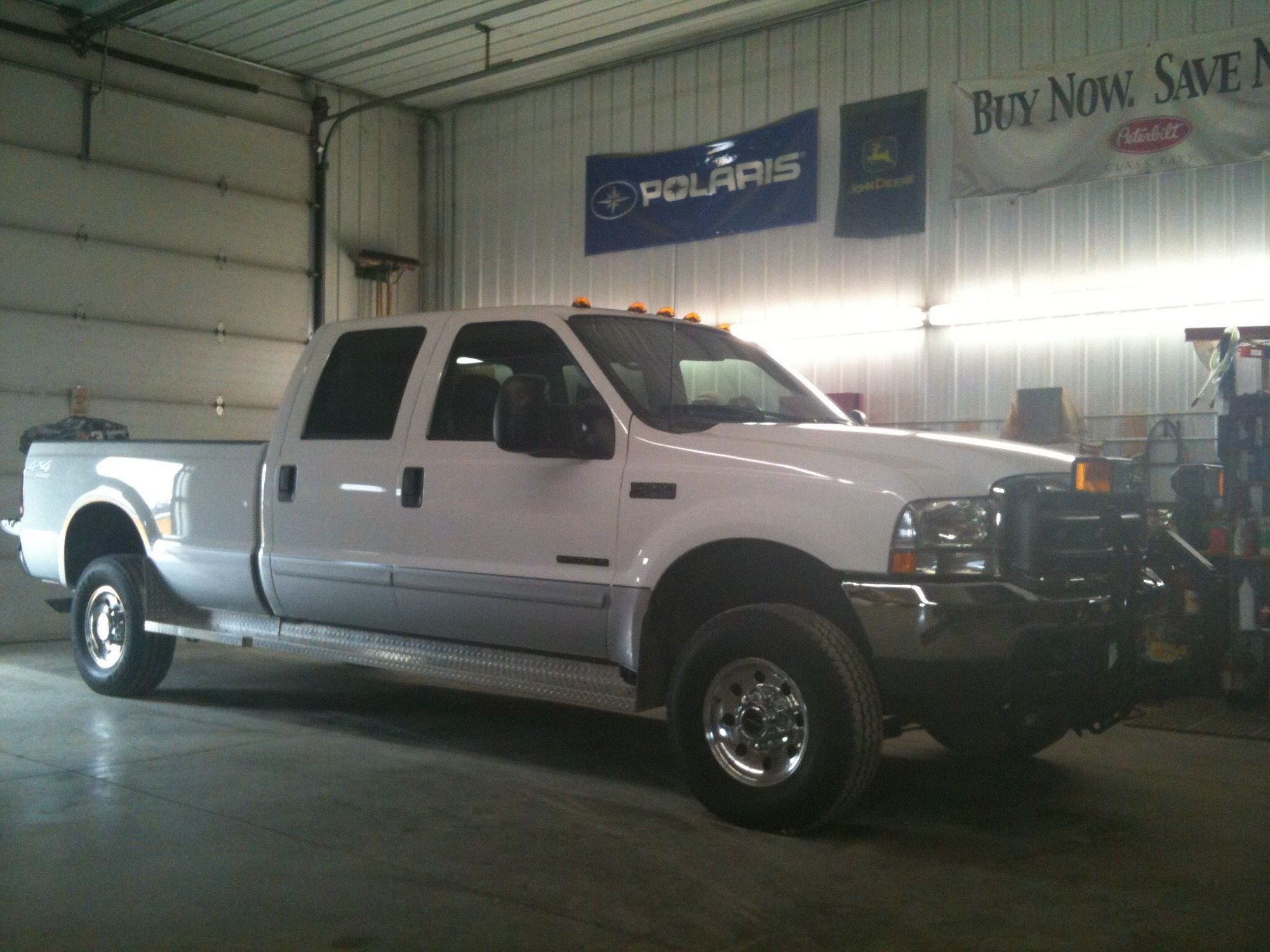

My 02 in sig came with "V" 's, for what it's worth a put another spring on so I have a 3 spring front axle, granted I did this years ago but it was the best thing I ever did to the truck, the ride was much better! I'm just sayin.
The pic isn't the best but there's over 1000lbs hanging on there. Just look at how much wheel well to top of tire there is.
If you look closely you can see that there is not much differance in the wheel well to tire differance with or without the plow.
Here's how it stands with nothing on the front.
