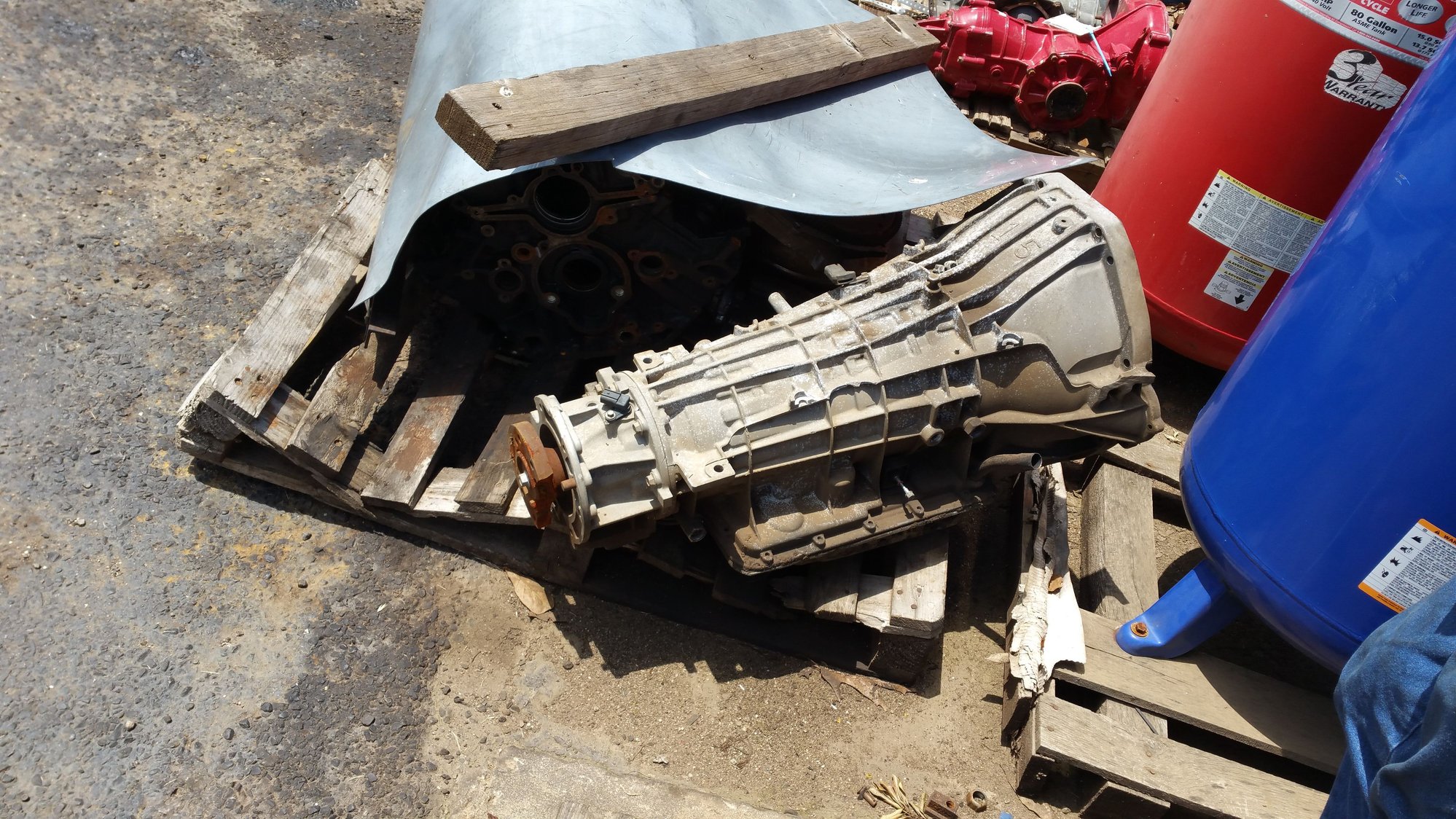

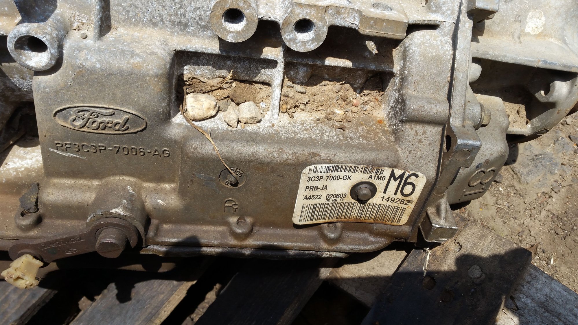

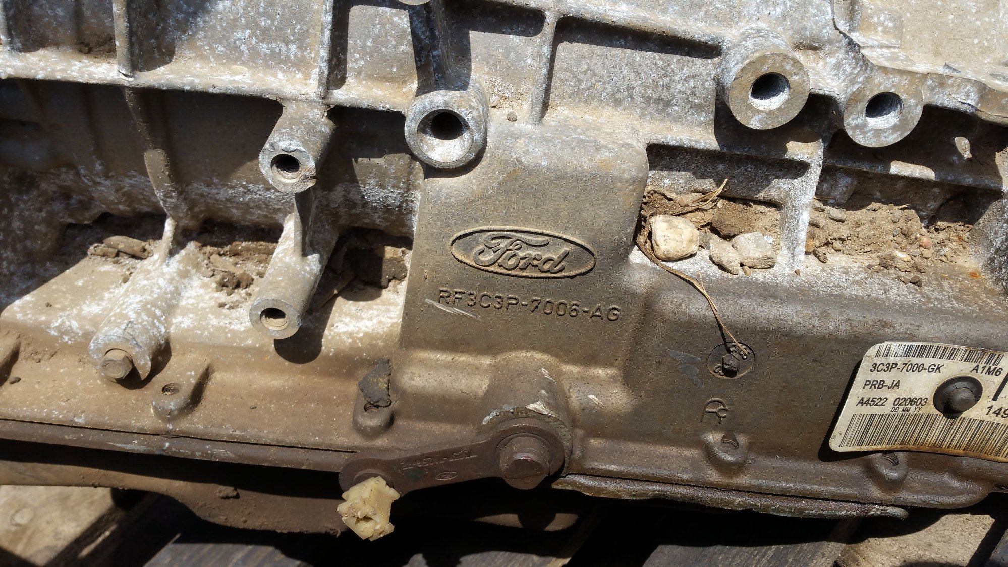

So I found this core for $50.00 from a friend that just needs some stuff gone from behind his shop.
RF3C3P-7006-AG

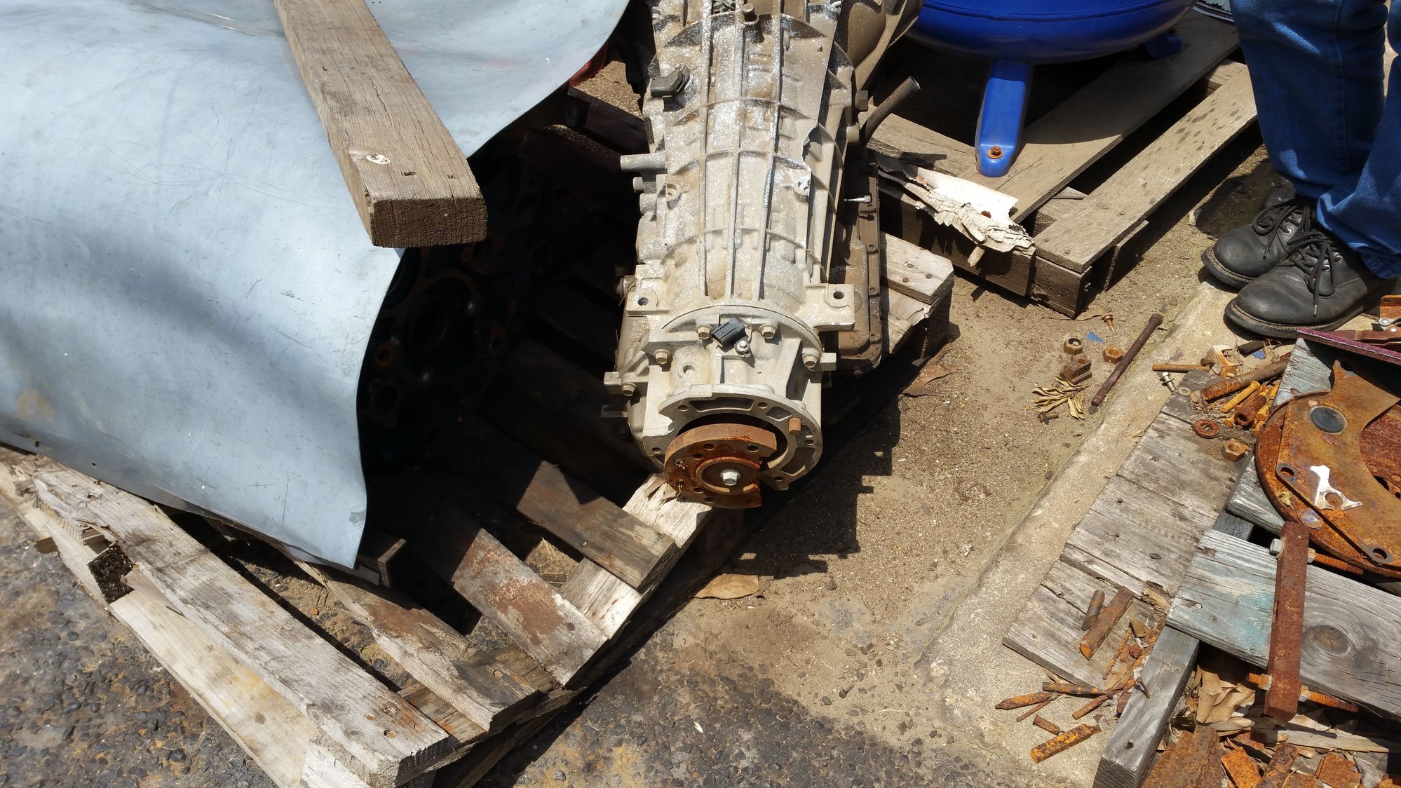

My hypothesis is that it came out of a 450/550, and was equipped with the parking brake assembly mounted on the tailshaft adaptor.
My experience on the older 450/550 trucks is that the E-brake tailshaft adaptor can be removed, and a transfer case will bolt right up for use in a 4X4. Is this still the case? Do I have a good builder here?

Most 5R110 transmissions were built in the 4x4 configuration. As I recall only E-Series and a very few F-Series had a 4x2 slip yoke.

Yes there are. And their transmissions are the 4x4 configuration. There is no slip yoke on the trans, there is a flange that the driveshaft is bolted to. The slip yoke is in the middle of the driveshaft.

Mark is the difference the output shaft and the addition
of the tail housing Vs the transfer case?
Sean
Old May 1, 2015 | 05:33 AM
Mark Kovalsky's Avatar
Mark Kovalsky
Frmr Ford Trans Engr
Joined: Aug 1999
Posts: 24,739
Likes: 2,669
From: SE Florida
Yes it is.
