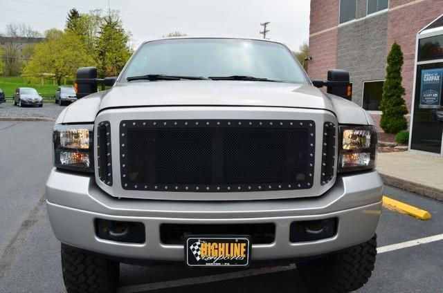

Originally Posted by SMaxey88
This is what I'm doing to my EX
Jesus. I (as in my wallet) hate these forums.
