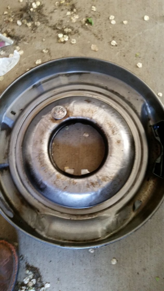

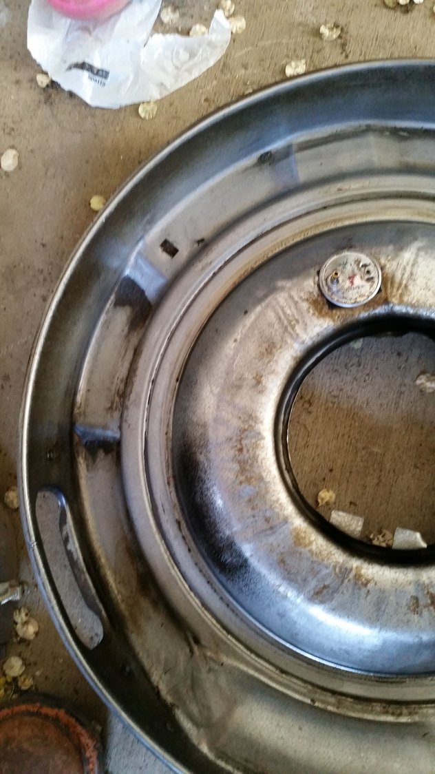

Took a few pictures this morning, then I reread your post for the "lid". But here is a few
No baff, this is where the tube from my oil cap goes in, the other part of the Positive Crankcase setup. I guess it needs some kinds of filter. Not sure why its spitting oil back into the filter from the intake side

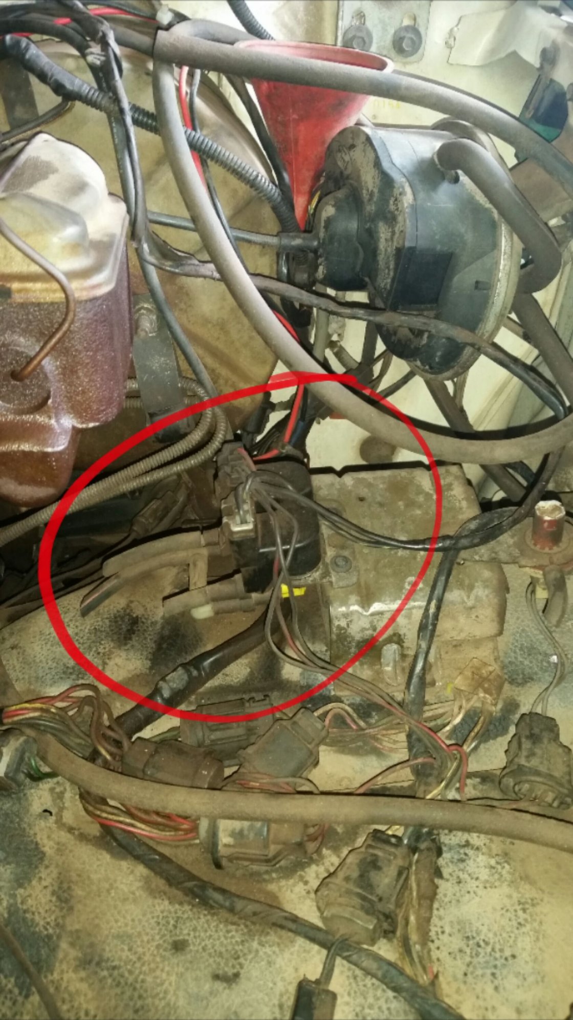

Originally Posted by marktrot
Okay, I will concentrate on cleaning up whats left and will get back on here ASAP. I know Ford did something right for this thing to still run after 30 years.
Passenger fenderwell. What are these?
Driver side fenderwell. Slaughtered, not used?

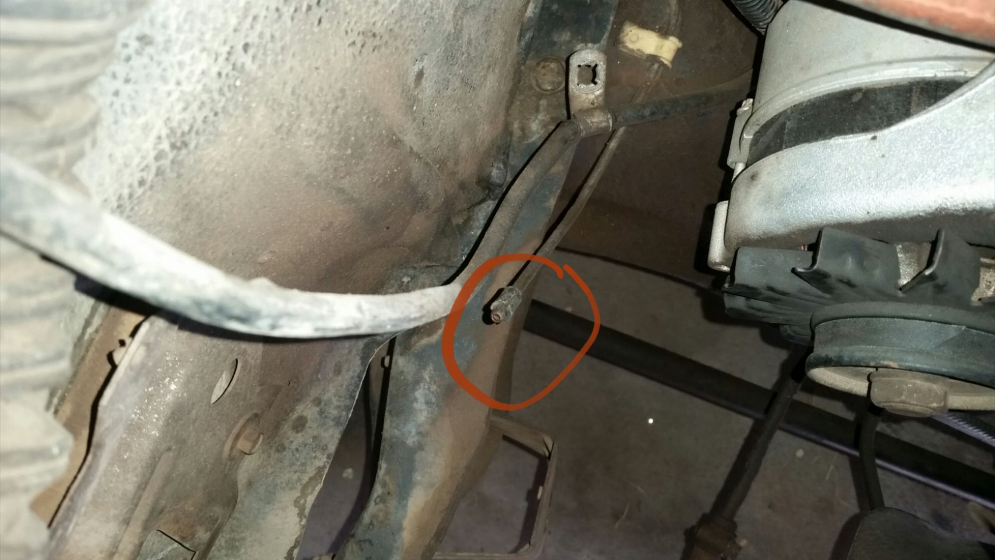

Also found this way down on passenger side fenderwell. I will trace it after work. Gonna be a fun project this vehicle... haha

Inside the red circle are EGR solenoid valves. If you are eliminating the EGR valve, you can completely eliminate those as well.
***To the right of the red circle, where the EGR solenoids are bolted, looks like a YELLOW strain Duraspark ignition box. Dust off the bottom of the ignition module and tell me what color that plastic tab is. If it is yellow, that means you have (had) a computer-controlled engine. And that would explain the extra solenoids in the First picture that most of these trucks DON'T have. That would mean that somebody "might" have replaced the original air cleaner with the "5.8 H.O." air cleaner. Post up a picture of the emissions diagram sticker that is on the radiator core support, and that will answer a lot of these questions.***

That steel line leads directly to your gas tank. As it is now, gas vapors are vented directly to your engine bay. Not only does this let dirty, unfiltered air in the gas tank, but your garage is going to smell like a gas station with it left open. DO NOT PLUG IT! Plugging it will pressurize the gas tank, and possibly even rupture it.
The steel gas line should have a rubber hose attached to it, and the rubber hose would then connect to the canister purge valve. That *might* be what the [top right] open port is for in your first picture. For the system to work properly, you need to go to a junkyard and get a charcoal canister and hook it back up. It bolts to that bracket on the side of the passenger's side inner fender. The charcoal canister will hold the gas vapors from the gas tank and carburetor fuel bowl when the engine is off and route the vapors back to the engine for burning (similar to the PCV valve) via the canister purge valve.

For your air breather off the oreillys website, you "blow-by" oil that is getting sucked up into the filter element is probably enhanced, because you have no filter, but also typically blow-by signifies the rings on your cylinders are getting tired, causing oil to blow-by and end up in the filter element.
MicroGard - Breather Element
Part # 42992
