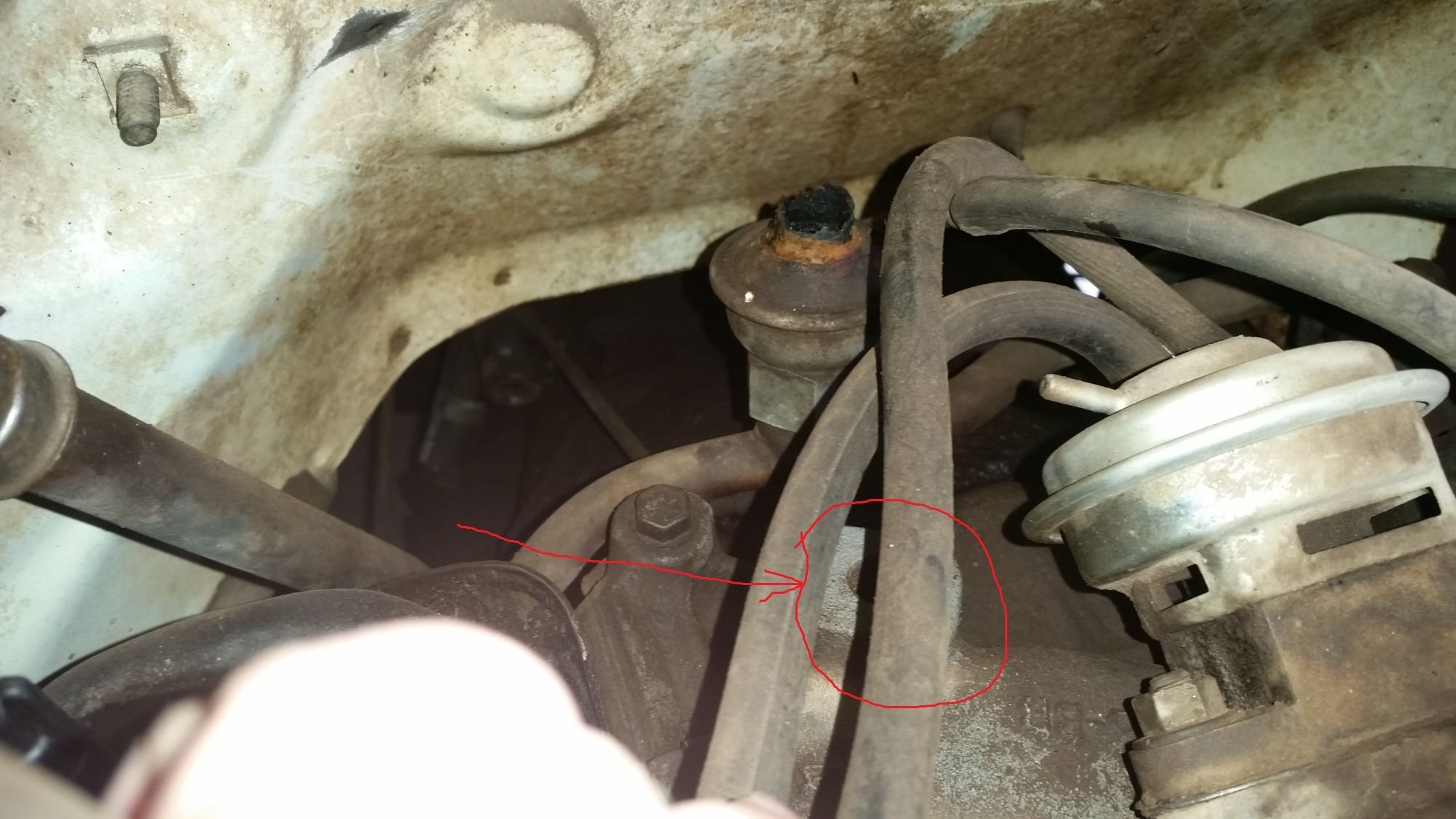

Good catch. I didn't see the metal blocking plate - if that's what it is. If so, we don't have to worry about the EGR. But, to prove that I would put full manifold vacuum to the EGR valve and see if the engine dies. If it doesn't either the valve is bad or is blocked. In either case I'd leave it alone for now.
