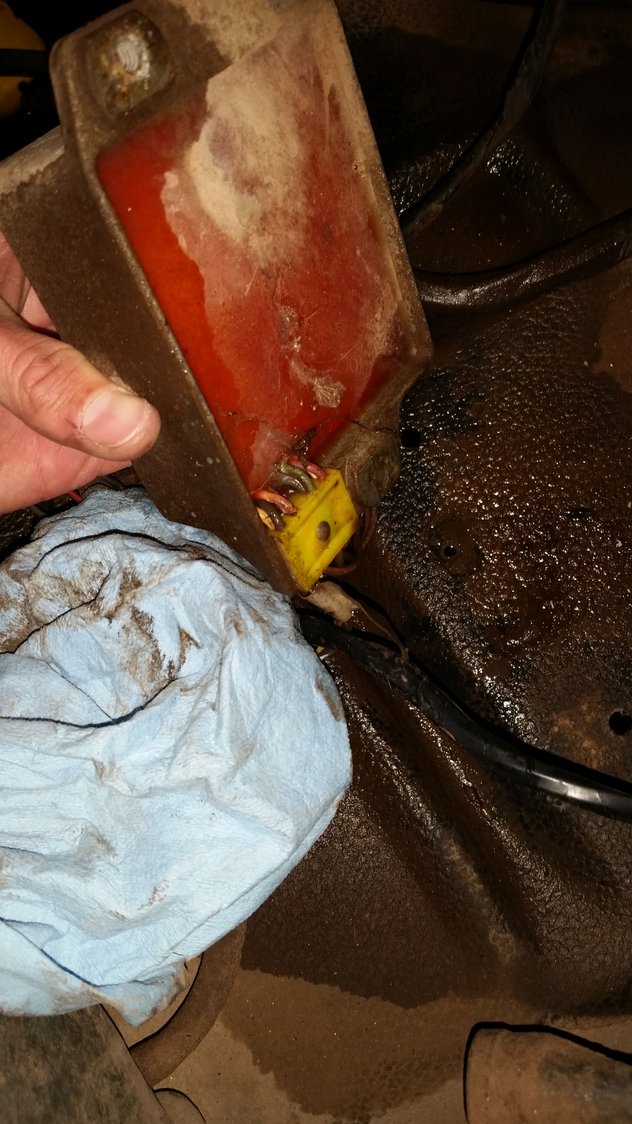

More disconnected vacuum lines! driver side firewall

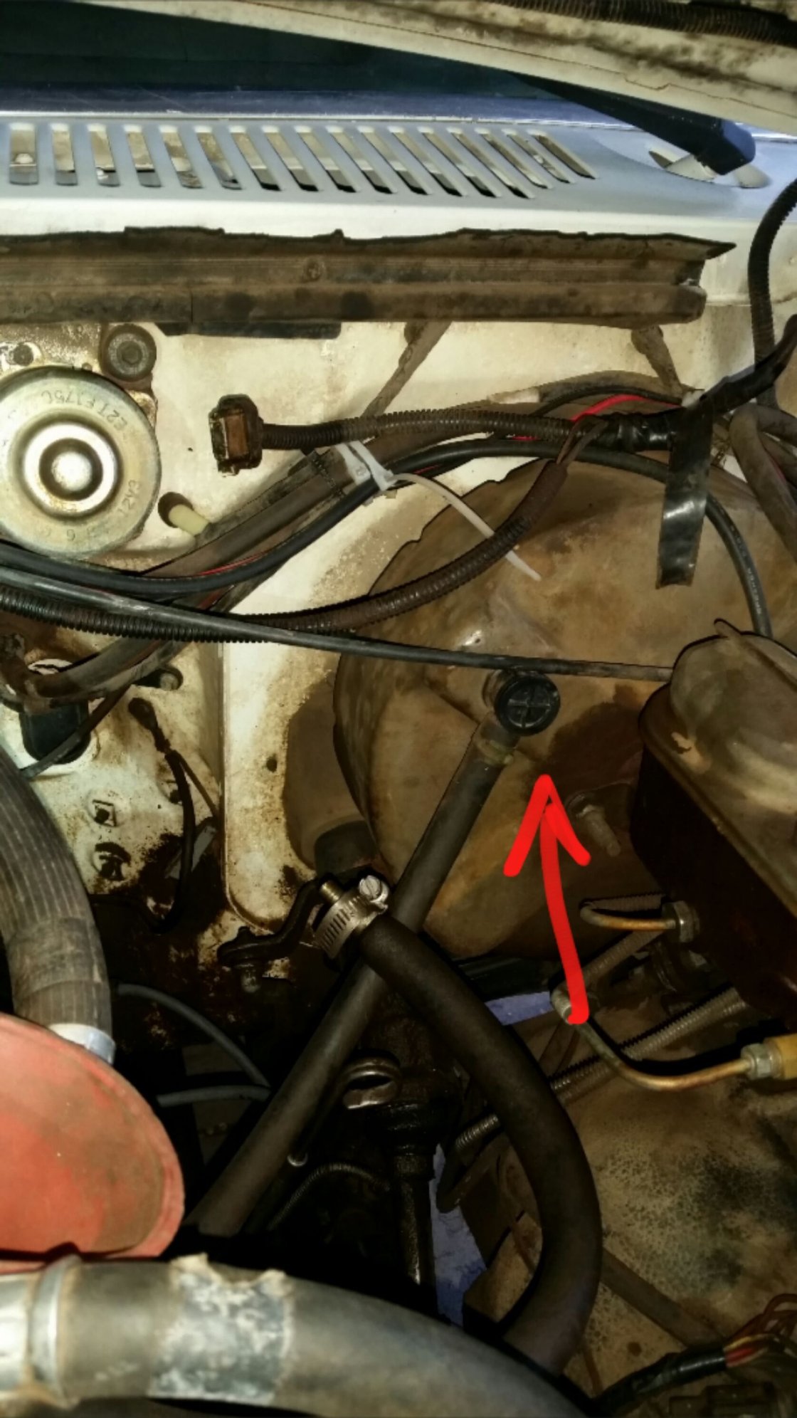

What is the large black canister in the third photo above? It has a diconnected vacuum line has well. Seems like lots of things that I can remove since the previous owner liked to cut everything up
Old Apr 29, 2015 | 02:28 PM
  #53
Gary Lewis's Avatar
Gary Lewis
Joined: Jul 2010
Posts: 32,875
Likes: 48
From: Northeast, OK
Cruise control actuator.
Old Apr 29, 2015 | 02:49 PM
  #54
marktrot's Avatar
marktrot
Joined: Dec 2008
Posts: 56
Well, I dont guess I have Cruise haha
Old Apr 29, 2015 | 03:03 PM
  #55
Gary Lewis's Avatar
Gary Lewis
Joined: Jul 2010
Posts: 32,875
Likes: 48
From: Northeast, OK
Truck did at one point. It would have had a horn pad with switches on it, an electronic box under the dash, a sensor in the speedo cable, and that servo hooked to the throttle.

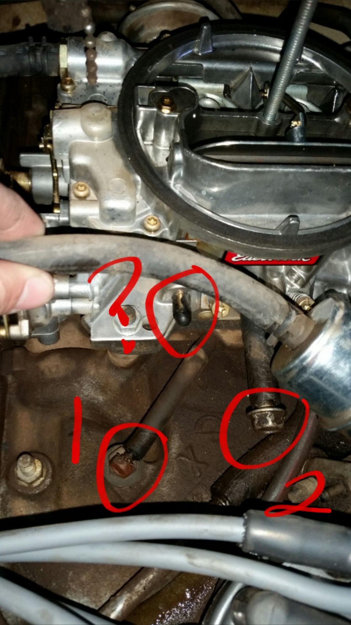

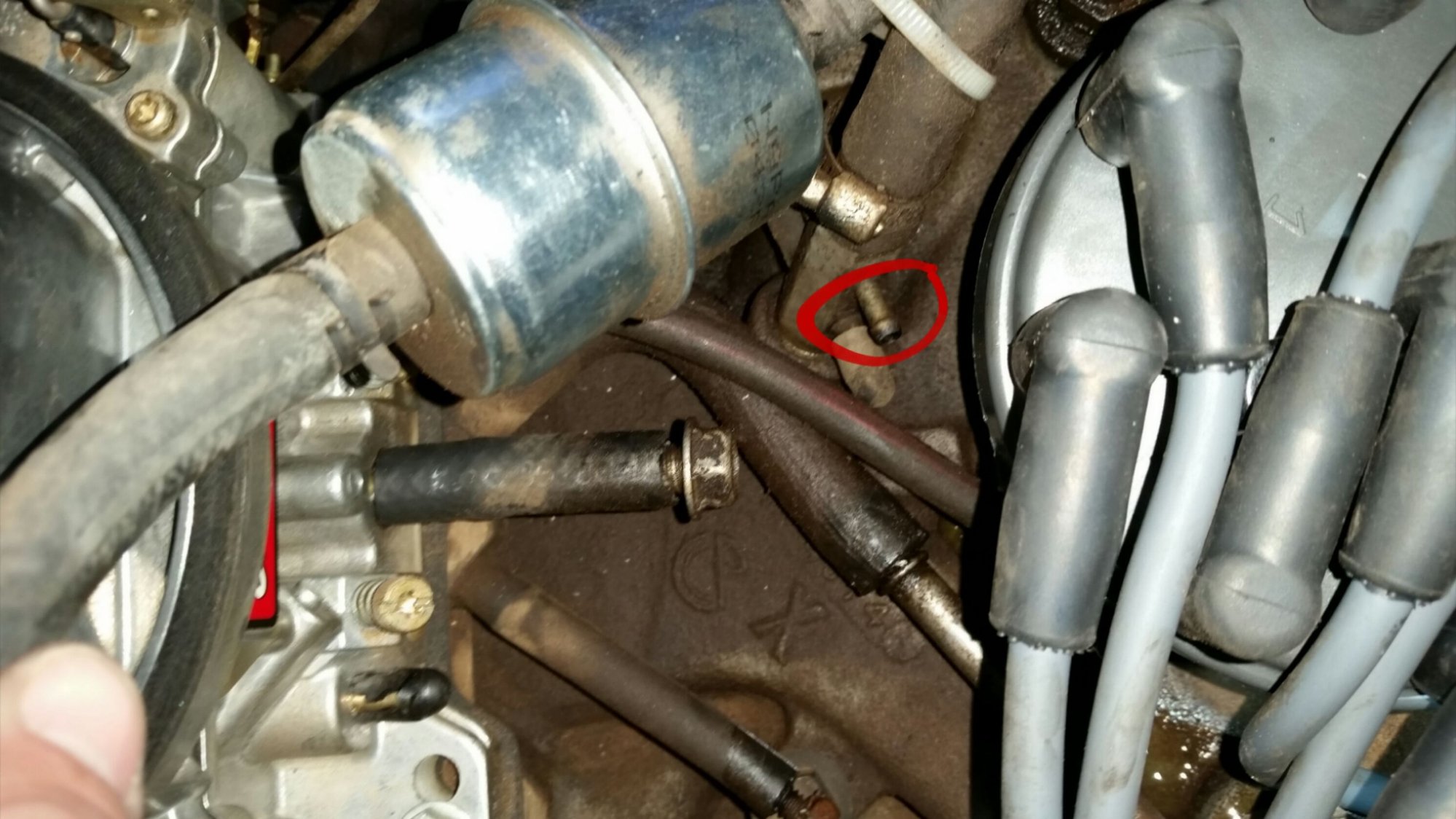

More nasty engine pictures
What port is the cracked cap covering? What about the two pretty bolt plugs?
this vacuum port is unplugged and pulling a vacuum. If i plug it with my finger, idle slows down... obviously not good I think
The above line comes from here...

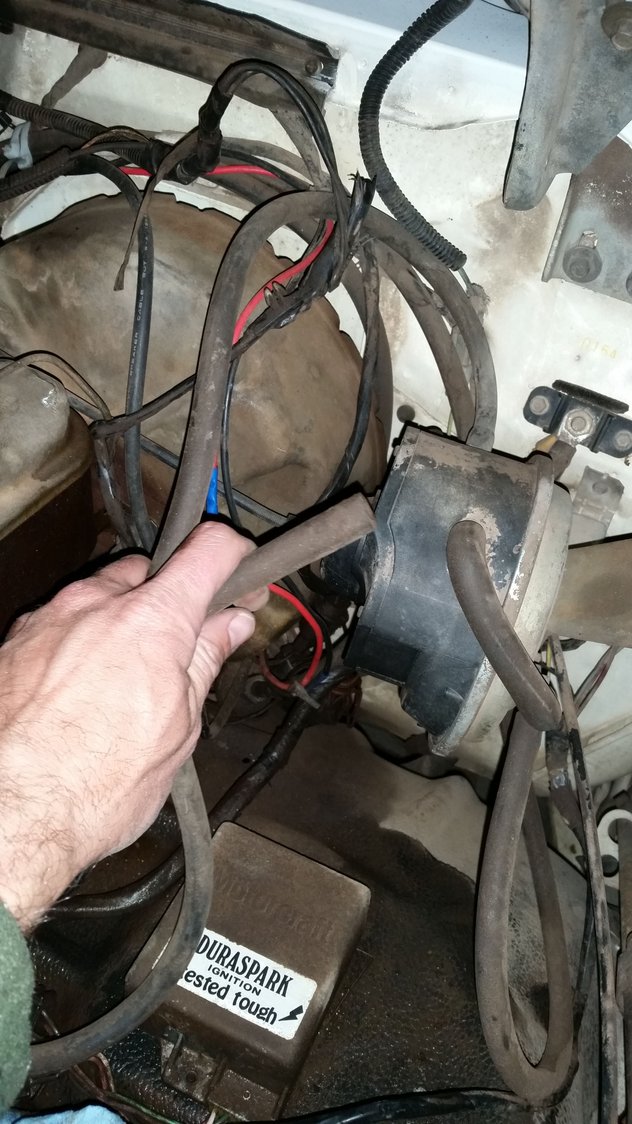

Old Apr 30, 2015 | 09:29 PM
  #60
marktrot's Avatar
marktrot
Joined: Dec 2008
Posts: 56
One more
This valve is puffing out exhaust...
