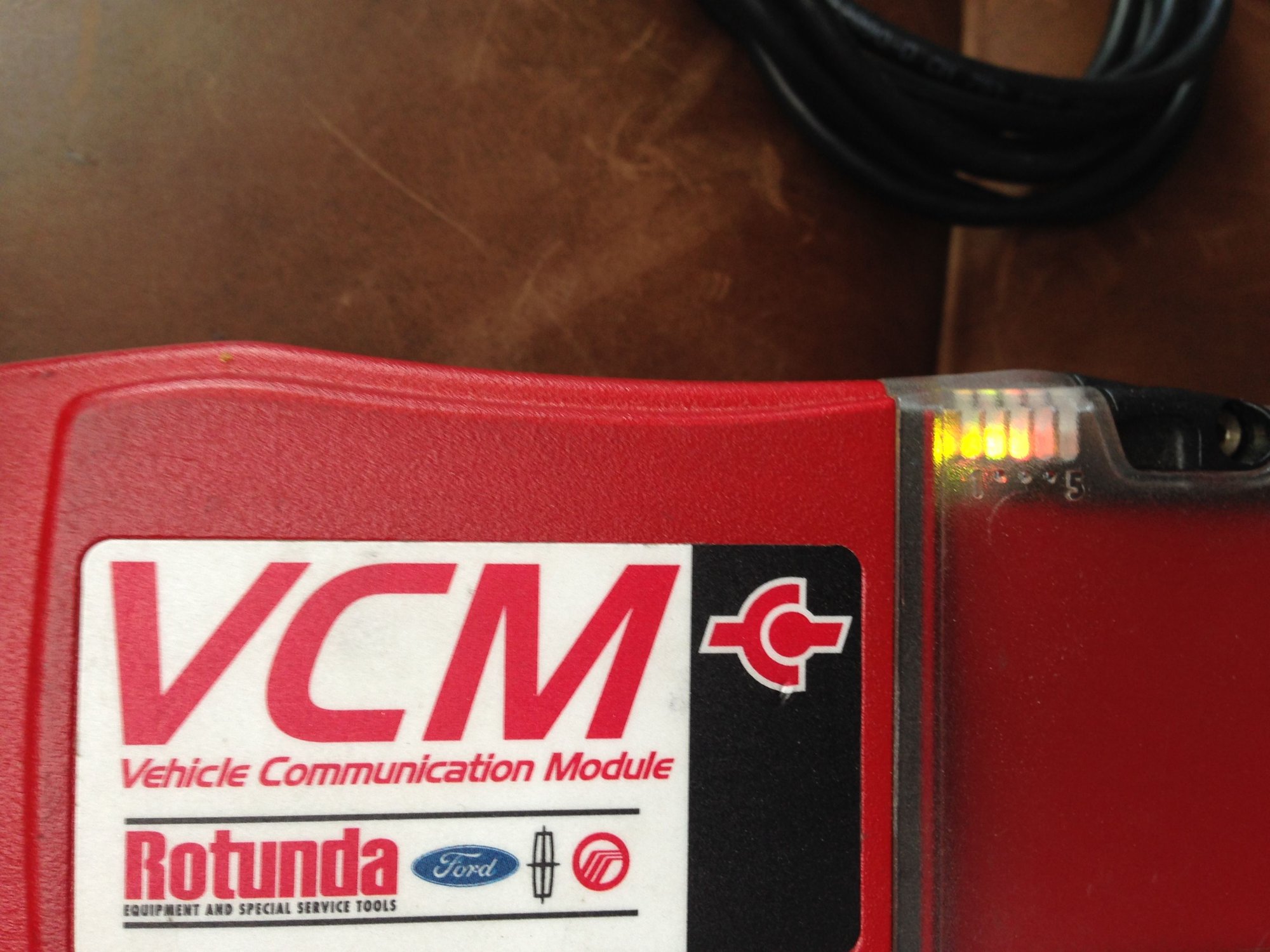

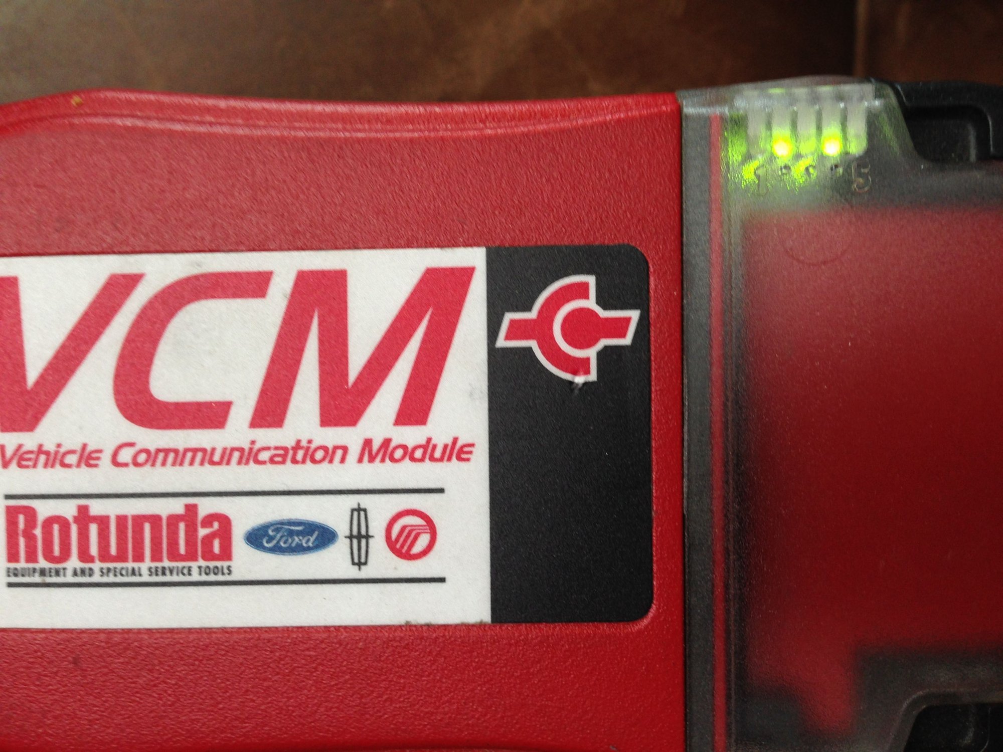

I am beginning to wonder if it got bricked somehow in all of this.
Is it responding at all? When you just plug it into the truck without
the laptop plugged in what are the lights doing?
Here are some things to look at.
Bricked my VCM
You can UNLOCK your Motorcraft VCM for your FORD IDS | eBay
I know that there is a program out there that will clear a bricked unit and let you
reload it. That is dependent on a good unit that is onlu having a software lockup.
Sean

[QUOTE=Yahiko;15299335]I am beginning to wonder if it got bricked somehow in all of this.
Yahiko, this is plugged in ,key off,no computer. Lights are not blinking .
Plugged in key on, no computer. Lights blinking.
