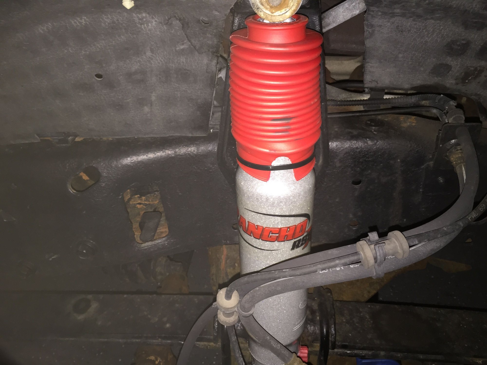

Here are my rear shocks installed. I had to clearance the lower shock mount to clear the wider body of the Ranchos.
These are the fronts. Bolted in with no problem. I have enough length in the shafts of the shocks to bring the X up 2" without needing to buy new shocks.
