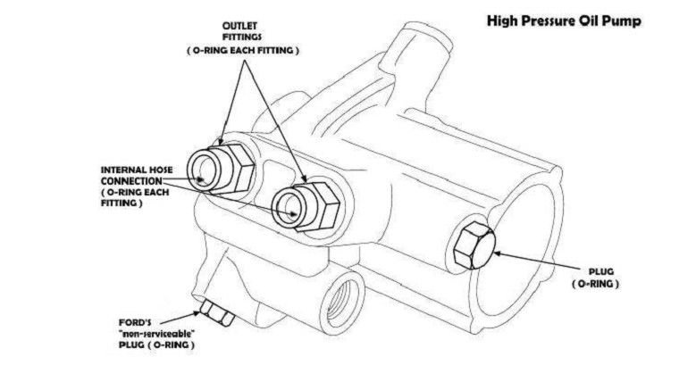

Could you send us a picture that highlights the location of the "adjustment bolt"?

Here are pics of the one I removed off of truck at a salvage yard yesterday.
Just choose the picture that has it in it...could be more than one...and give us the location.

Could it be he's referring to a bad "O" Ring, leaking Non-Serviceable Plug, IPR, or something else?

my oil pump is leaking at the Non-Serviceable Plug. will i need to remove the pump to replace the o ring? it is a new pump with 1300m on it. don't wont to hijack the thread but i'm having the same problem.
You'll need to remove the pump and repair it with this: Serviceable Long Threaded HPOP Plug - Riffraff Diesel Performance

Welcome to FTE. There is no adjustment bolt on the HPOP. Either identify which bolt is in question in the pictures above, or find a new mechanic that at least can look up what bolt does what.

My bad 13,000 and it is over 2 years old. it is a new Bosch from Riffraff. disappointing to remove and fix an engineering defect. I don't even know what the Bosch warranty is but 13,000 is sad. I ordered the recommended parts from Riffraff.
I don't know that will have any warranty. However, you could always call Riffraf and possibly meet an amicable agreement on a replacement. Or, Just re seal the one you have. In either event, you'll be removing and reinstalling.
