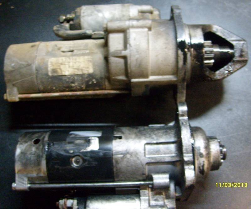

Yah, they're interchangeable:
Both from my IDIs.

there are three or four design's, the one that is un shrouded is fine as long as it fits..it looks much like a PS starter just a shorter nose length..ALL types are gear reduction...some of the newer types have smaller moters that turn higer RPM the largest one I found was 4 kilowatts most are 3.4-3.6
