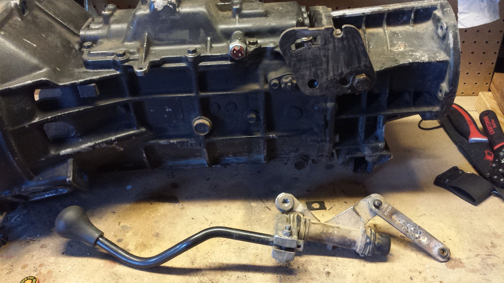

Hello I'm concerting my f150 from 2x4 to 4x4. All i need is the shifter linkage for the transfer case and a shorter rear drive shaft. I purchased this li kage thi king is was the one i needed but it doesnt look like its the one i need.
What is the one i need? Or am i just an idiot. Please help, would like 4x4 by this deer season in july

The transmission appears to be a 87-91 and the shirt lever is a 92-97
They are NOT compatible

Thanks for the response Brad. What is the lever that i should have?

You want the lever from a 87-91

So one that looks like this one on the left? I cant find any for sale anywhere online

The one on the left "looks" to be correct but I am not up on the 87-91 trucks

The one on the left is the one you want.

Thats what i was hoping for. Hopefully jumps in soon. Thank you for your help either way
