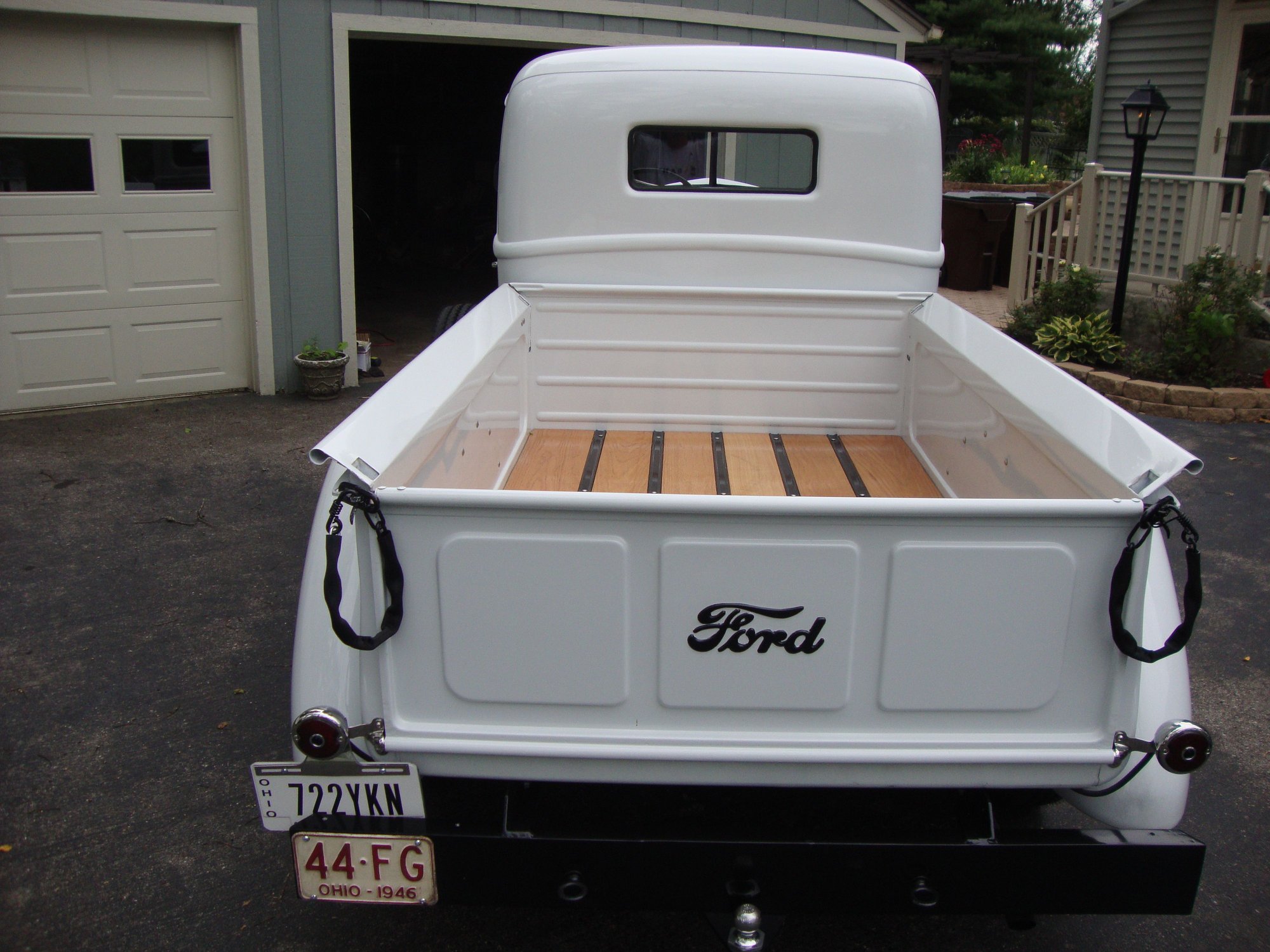

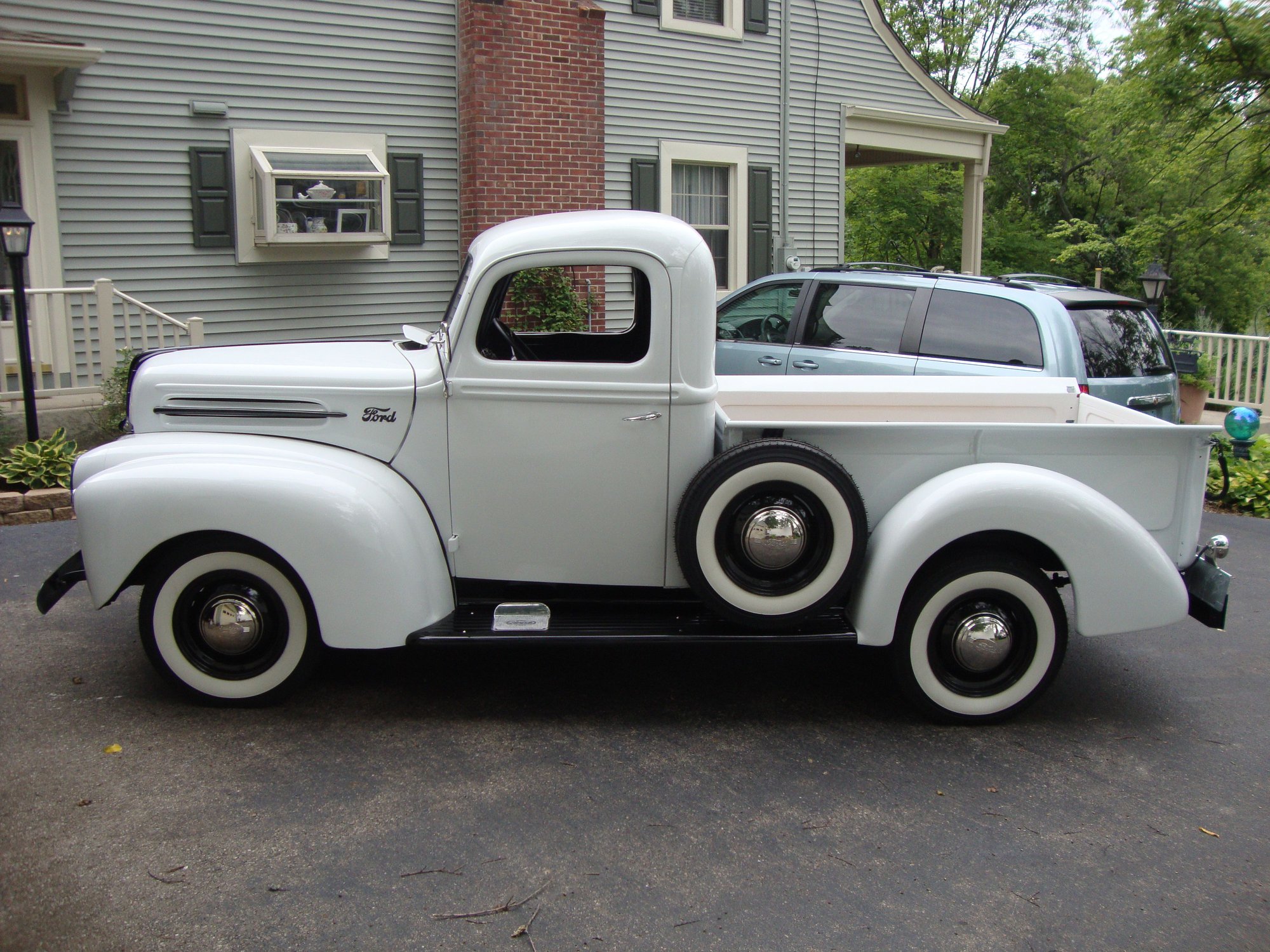

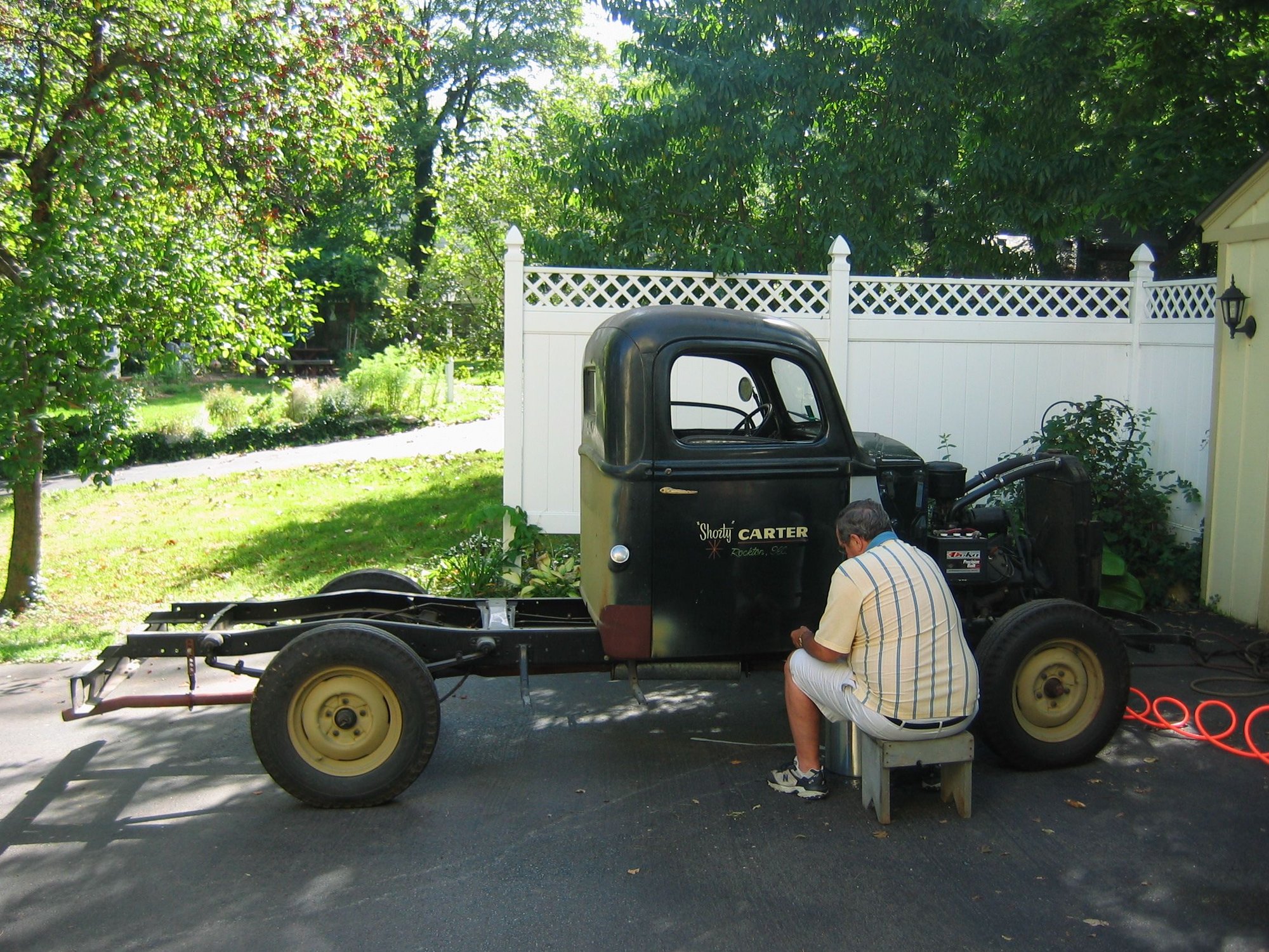

I bought a 1946 Ford 1/2 ton in 2003. I didn't get much done to it for the first eight years. I wish you luck with yours because I finally gave up on finding time to work on it and found a guy to paint it so it would be finished. I have taken out the steering column and steering box like said above. Down through the bottom of the truck. I will try to post a few pictures of the truck to encourage you to get it back on the road I have really enjoyed mine for two years now.
