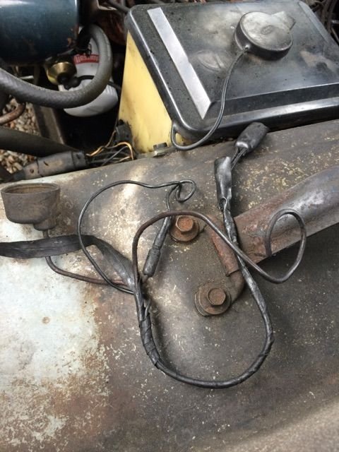

So now that weather is getting nicer I thought that I might try to get the back-up lights working on my 74 with 302/C4 AT. Having read the threads, I was looking for the jumper on the drivers side splash pan and I found this wrapped around my steering shaft..PO...
Can anyone name that greasy wire?

It looks like Ford wiring based on the bullet connector. I don't recognize that rubber cab thingy....

That "rubber cap thingy" originally went on the end of the carb's anti-diesel solenoid, it's been pulled off.
Here is the connector you should look for, in the picture it's the one just above the red connector. In the next picture you can see the short jumper wire to bypass the connector when an automatic is installed. That plug is actually the plug for the manual three speed back up light switch.

Aldo kinda looks like it might have gone to a water heater. the location does not make much since. That is my guess.
