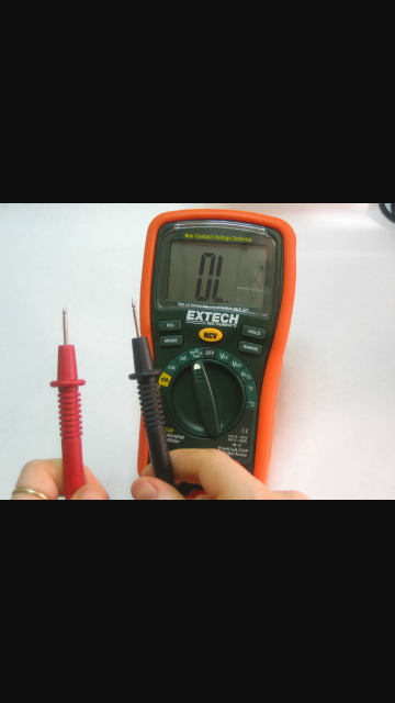

Your going to want to do an Ohms test for the two wires, it's relatively simple. Disconnect the connector at the a/c clutch, fallow the harness back to where it ties into the the main harness and disconnect it there too.
Next set your meter to read ohms, it has a symbol that looks like a horseshoe. IIRC there's only 2 wires for the a/c clutch, I can't remember off hand the color of each wire. Take your black lead and touch it to a contact in the a/c clutch connector. At the other end of the harness find the contact for the corresponding color wire you are testing and touch the contact with the red lead.
The wire with an O/L reading is your bad wire. The other wire should read 0.002 or all zeros. If both wires read all zeros the problem is upstream in the system.
Sorry if over explained it, not sure of your experience with a multi meter. Good luck bud.
