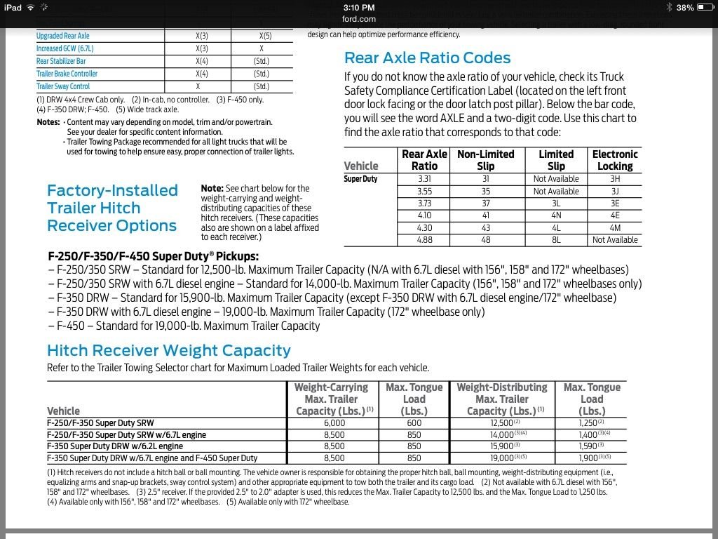

Your truck only comes available with a 3.73 or 4.30.
Here's the door codes for 2015 to validate once it arrives. There is also a plate attached to one of the differential bolts with the code to verify.
Ford simplified the codes for easy identification some time back. Expect to see a "4L".

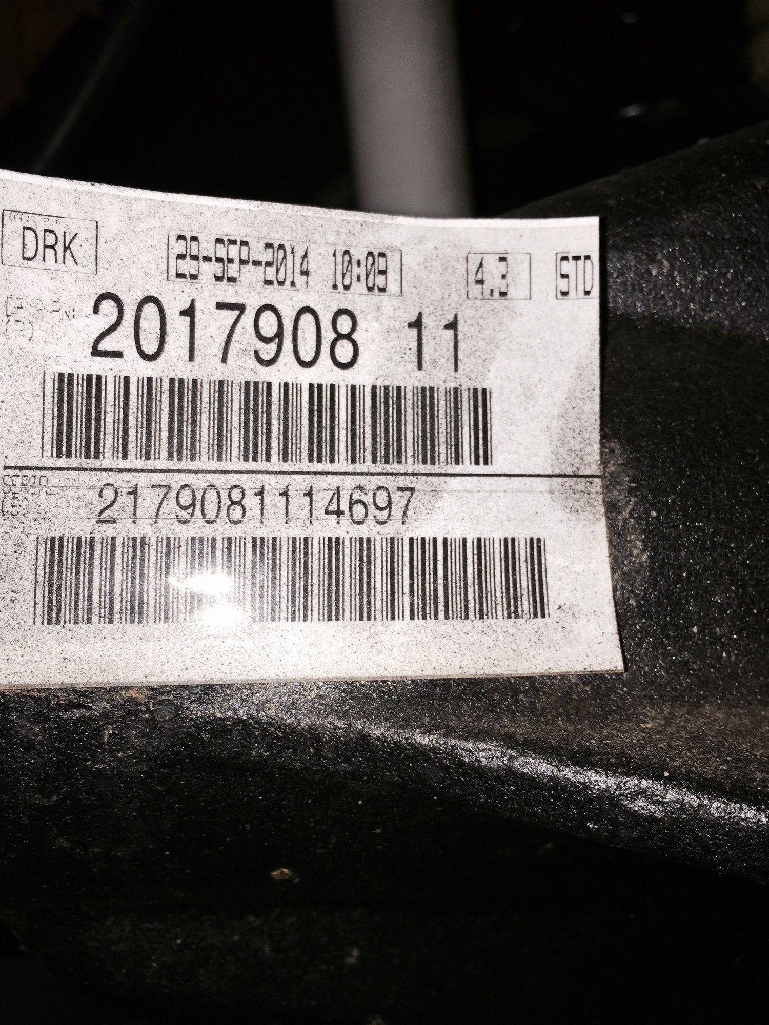

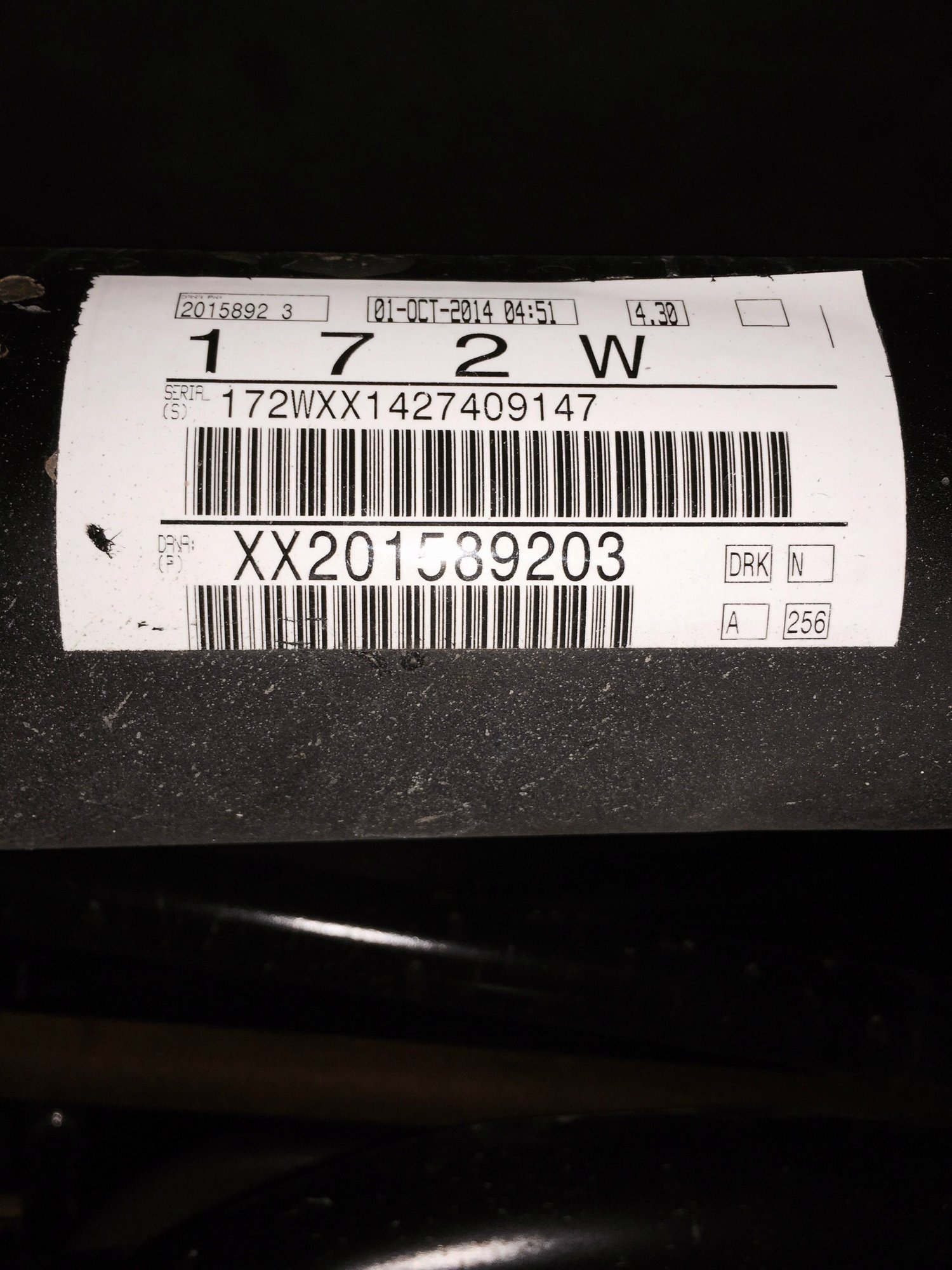

Mine came with these two stickers on the front axle. It also has a tag on the front of the axle that says 4.30. The top sticker is on top of the pumpkin and the bottom sticker is on the back of the axle tube. They are both on the front axle.

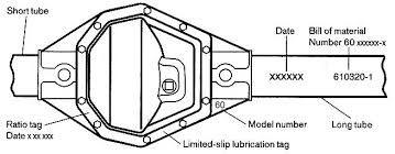

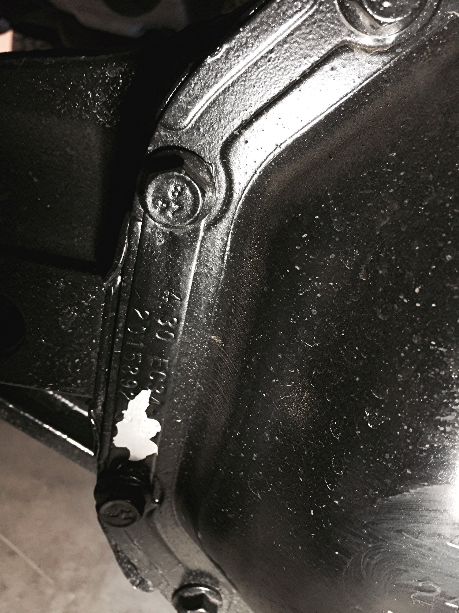

There should also be a metal tag on one of the differential bolts, its about 1/2 wide and about 1 1/2 inches long. It will have a bunch of numbers and letters but the first ones should be 4L30, the L is for limited slip, if the truck has an open rear the space where the L is will be empty.

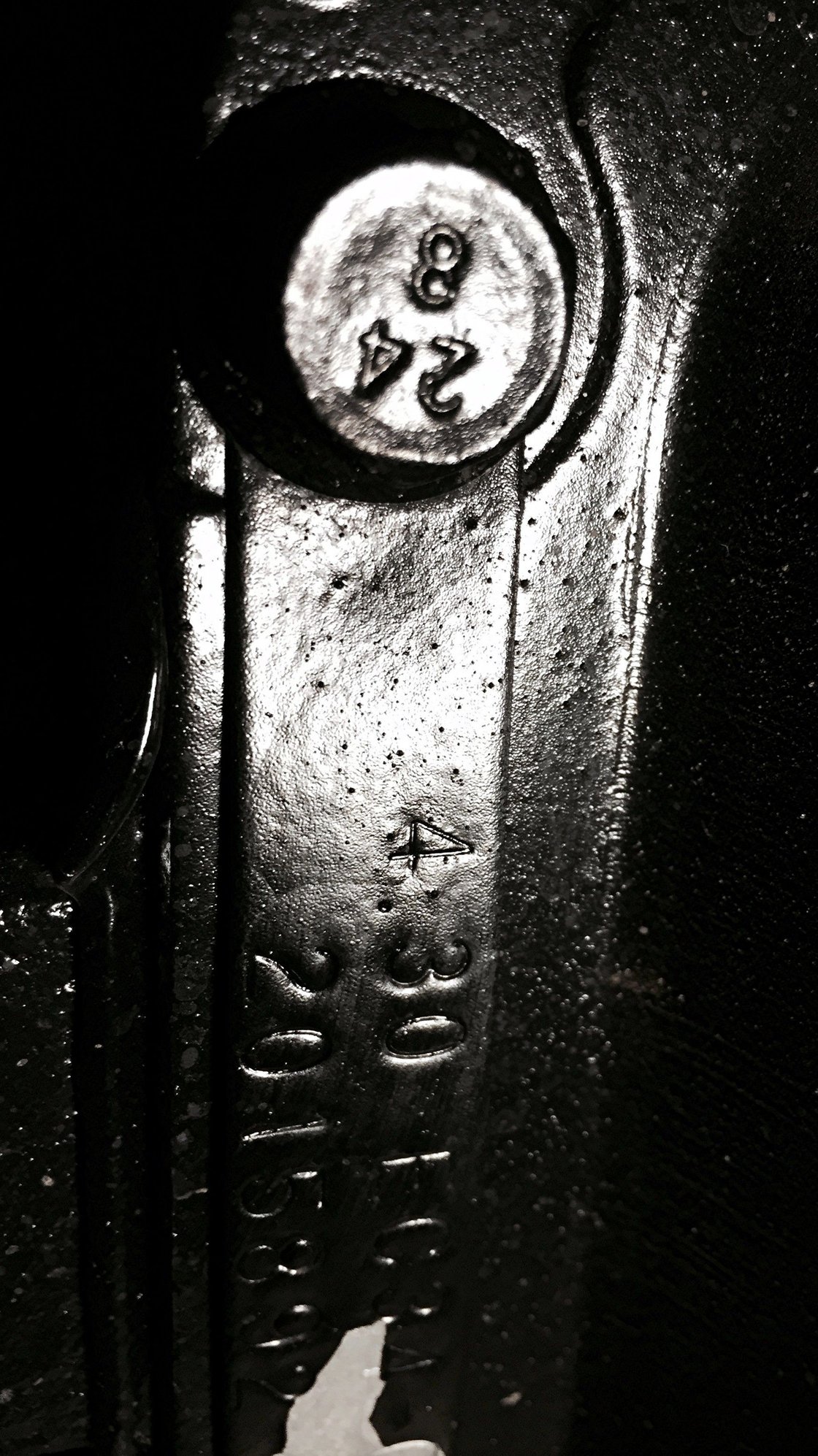

This is the tag that is on the left side of the front differential cover. Its on a 2015 F350.
