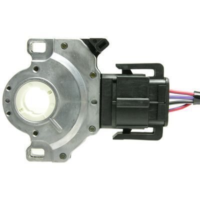

Thank you for that information, I didnt know what the middle sensor was for. My bronco has a C6, and this is the NSS and connector thats on it. I'll have to look into that aftermarket switch you mentioned, but for this specific issue, this is as far as Ive gotten. The ports on the plug were corroded, and I cleaned them, but no luck.

Yup, that's the C6 NSS connector.
