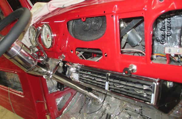

30" is what I went with in my 52 from Flaming River with column shift. Had to heat and bend the shift lever to give me a little more clearance with the dash but wanted to keep wheel as far away from my belly as possible.

That's the length I'm going to go with. Mine is a stick so I'm good to go there. Thanks for the pic. Big help.
