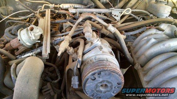

As an update I found out that in the late 80s (87-89) ford used an FS6 compressor and some of them had a fitting on them that can be easily adapted to my 70s hoses. Now I have one just need some fittings so I have some pressure ports. It should fit the same bracket as the FS10 fits.
