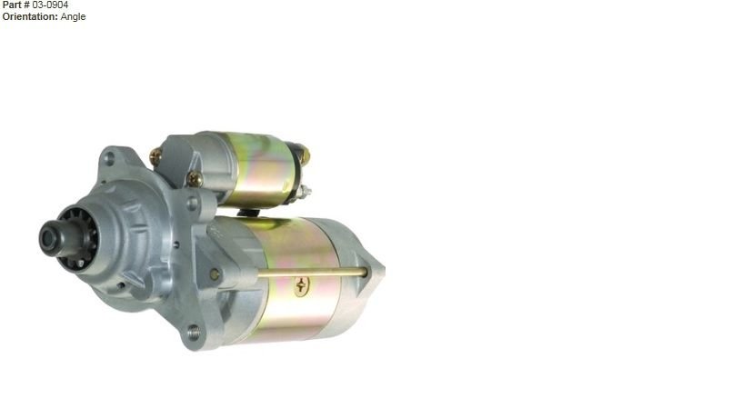

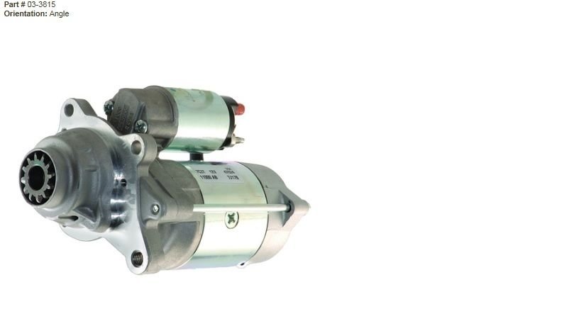

6.0 starter
6.4 starter
Okay, problem? Here is a pic of a 6.0 starter and a 6.4 starter. Take note of the drives. You sure the 6.4 will work on the 6.0? They both show 12 tooth drives and 3.0kw output power. But the 6.0 starter say's it has a 4.75:1 ratio where the 6.4 doesn't specify.
B.

Okay, I crawled under her a little bit ago. She already has the offset PMGR style starter, NOT the straight style. SO, would there be an advantage to using the 6.4L starter anyway? B.
