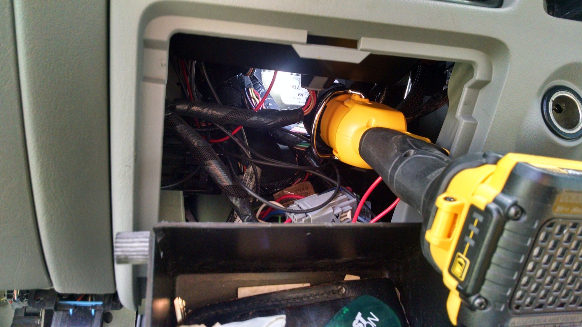

Here it is on my '05 on the firewall just left of center. On mine, there is a drop-down driver's side mini-glovebox thingy that lets you see up there. The master code should be on a sticker on the face of it. It is also printed on a credit-card size card in with the original owner's manual (if that's still around).
Master door code on firewall module
