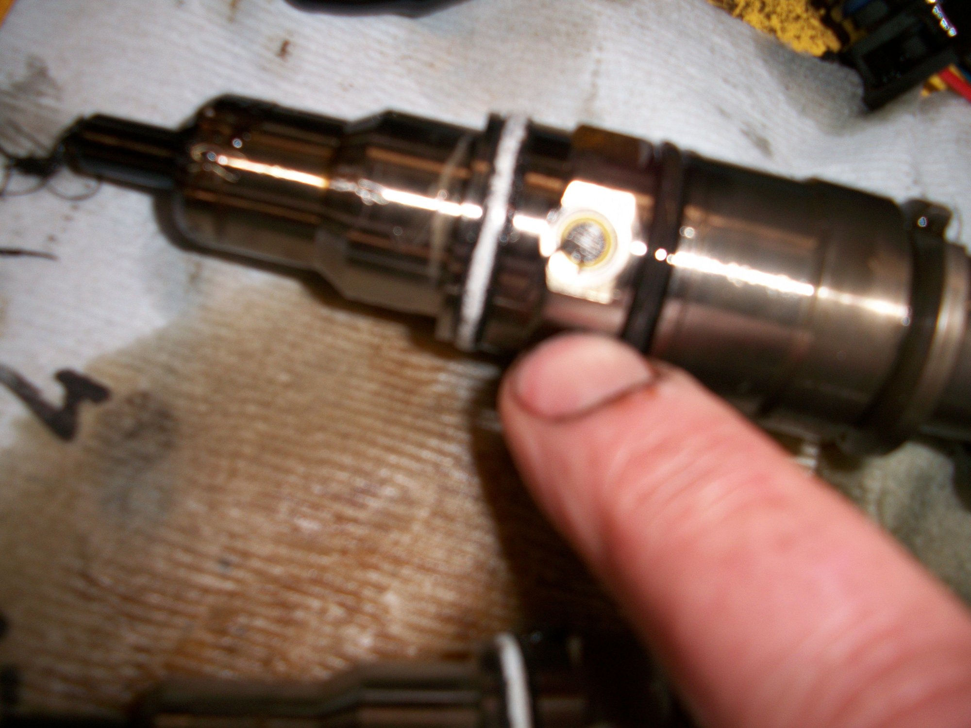

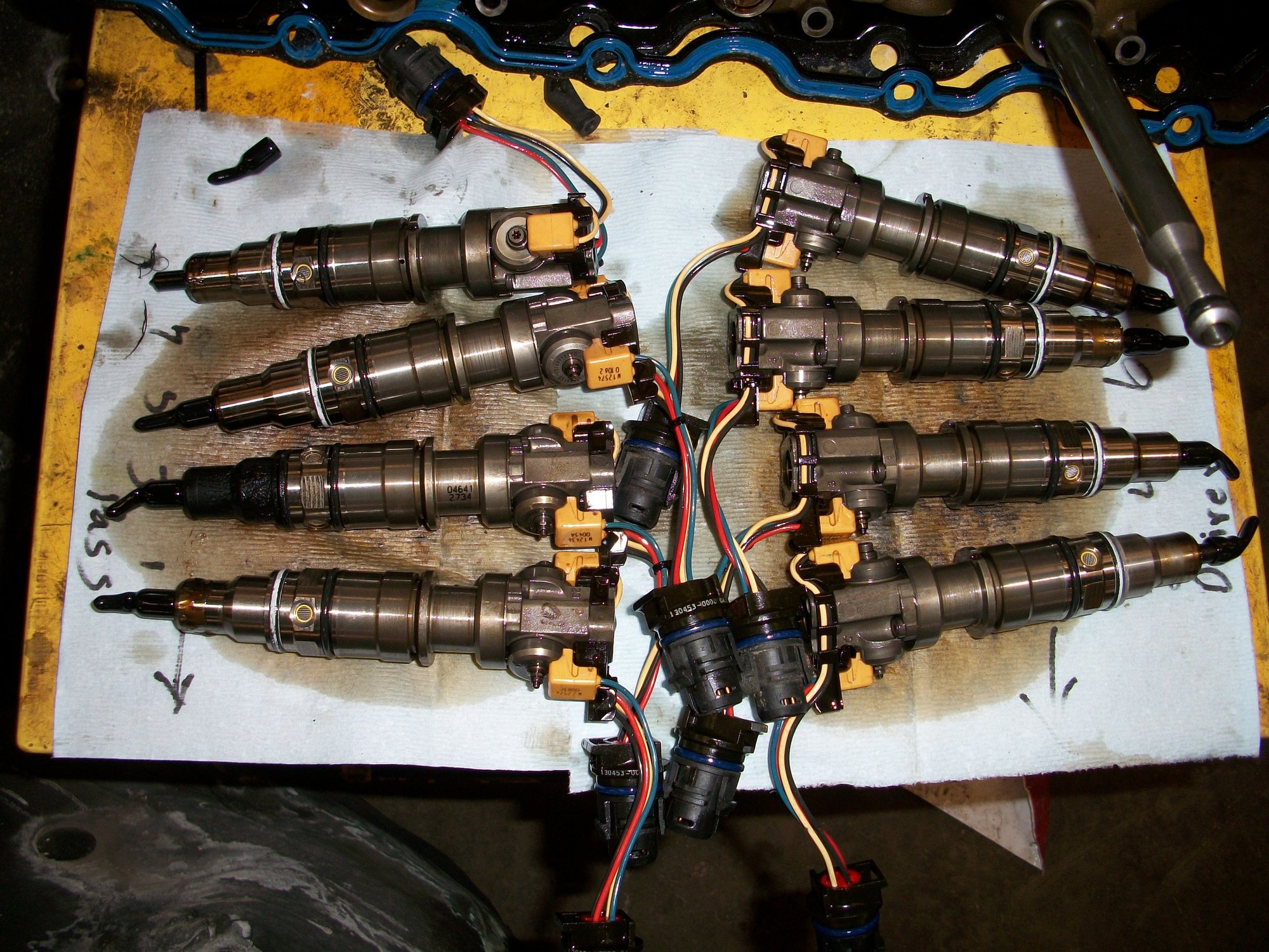

here are the picks of the injectors we took out and some of the stuff we found around them

#3 is text book copper washer failure, many times from improper torque on the injector hold down bolt.
The shreds are probably #3's lower oring. That's why the shreds are on the same bank.

Or more then one injector was starting to have issues. But it would make sense that debris would get washed down to 7.
Were they able to clean up the cups OK and get it back running?
