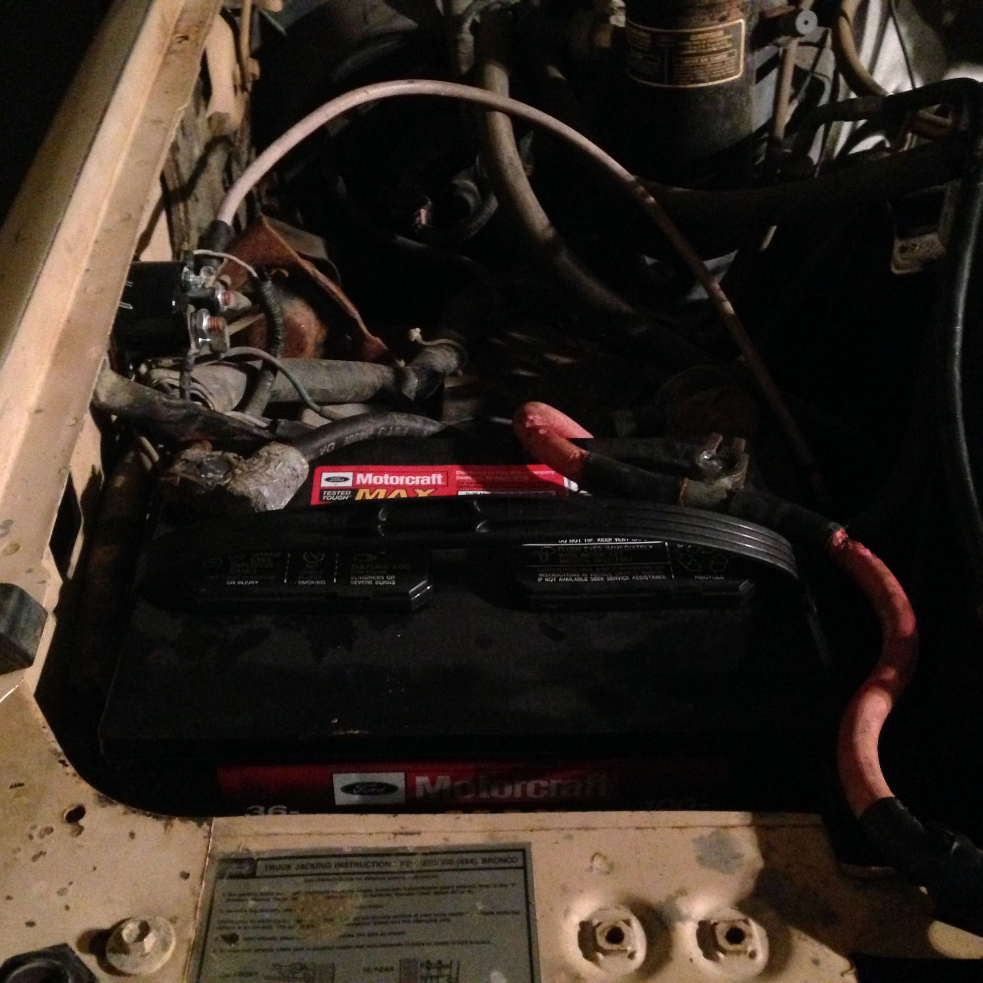

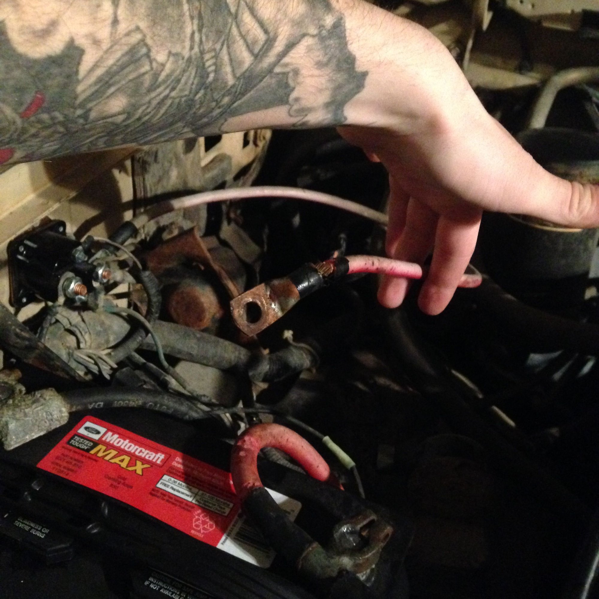

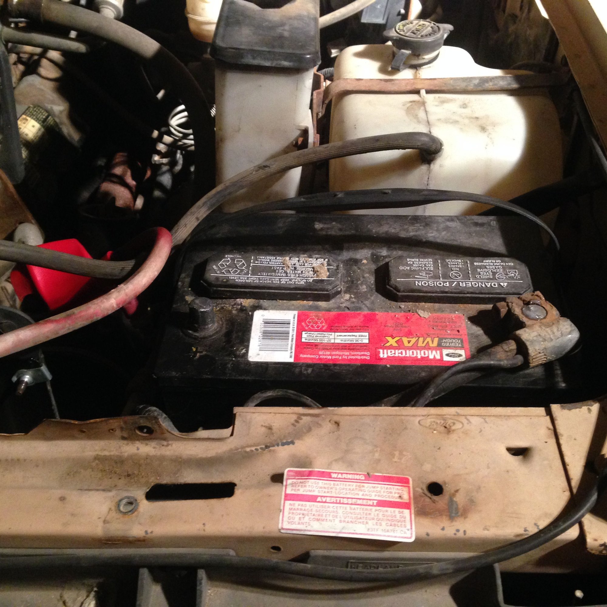

Good news and bad news. Changed the glow plugs and the ignition switch, she started cranking over but still wouldn't start. I could plug her in with the block heater and she'd start and run fine throughout the days, still a little hard to start sometimes but I tried to start her every hour on the hour just to make my life easier.
Put a new set of tires on the old girl, came time to change the glow plug controller. Well...made an EXTREMELY stupid mistake. I matched up all the wires on the old glow plug to the knew except one of the large yellow wires and ended up plugging it into the bus bar which promptly fried my batteries after I started it...yeah I felt like a *******. On a good note it did start and run great, so I know the GPC was the problem solver.
Anyway, yaked out the batteries and my glow plug controller. GPC and one of the batteries was still under warranty so I swapped those out, got the other battery charged up and put them back in. Now, for some damn reason my start relay wire wants to arc and spark as I'm trying to hook my batteries back up.
I made damn sure to follow the wiring diagram this time, so my GPC is definitely plugged in correctly. Even a numbskull like me can't screw up the batteries, so what gives? Any ideas?
This is the wiring diagram I used
Starter Relay wire. She's pretty mangled looking, but she worked just fine before is what I don't get
Proof my passenger battery is installed correctly
Proof my driverside battery is installed correctly

i would disconnect the power wires to the controller and see if the relay still sparks when connected.
it sounds to me like the fender mount started relay may be stuck in the closed position.
