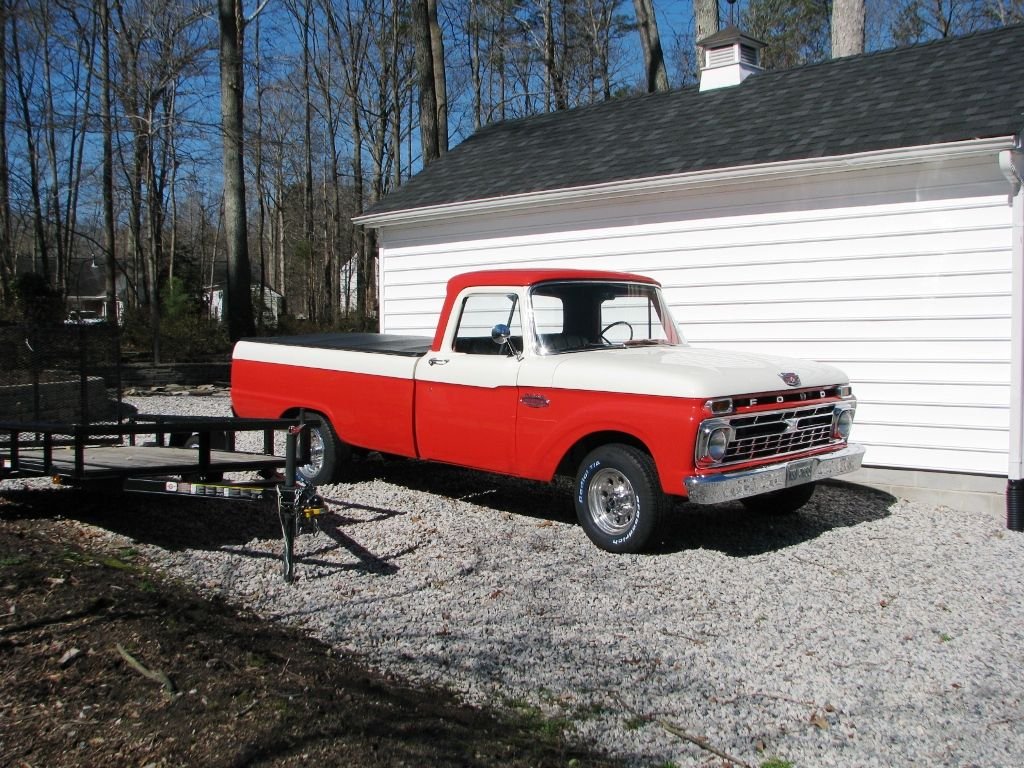

Been struggling with this for a couple weeks now and discovering too many issues. One that relates to this was pointed out by Tom at Flashback 100's. He mentioned a most dangerous situation since the column was not bolted in the truck to firewall and no clamp holding the bracket either. He also mentioned something about what is holding the shaft in center? It's an uncomfortable feeling when you learn that in the case of a front end crash, depending on impact, death can occur due to the fact column is not bolted in and can go through you. Based on this we've decided to file a warrant in debt against the joker. We may not see dime one but it'll give us the satisfaction we did something. Won't make spending the extra coin any easier but it's able to be justified now.
I did learn the steering box is from a 70-79 and found a couple 73-79 trucks. Will be checking them out if the owners would be willing to part them out. Don't need a whole truck so we'll see. Last ditch effort will be a column from IDIDIT an d a conversion to floor shift. Auto is out of the question and we're still debating the use of a GM column since we can't keep the stock steering wheel. If that's decided, at least we can keep the 3 on a tree.
Just for giggles, here's a before and after picture of the truck. I will admit it does look nice but in this case it's not the main problem. There's issues you can see but it's the one's you can't that get me.
before
after
Old Mar 15, 2015 | 11:09 AM
