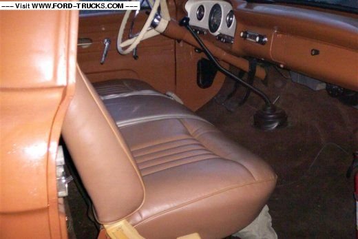

Hello fellow Ford truck people! I am interested to hear if anyone through trial and error has found the best steering column to use in a 66 F100? I currently have a 4 spd and am thinking of doing an auto but want a column shift instead of putting a shifter on the floor. My truck is currently setup with power steering and has a different year column in it, I would guess a late 70's and only guessing that because it looks like the steering wheel out of a 77 half ton I use to have. Also if possible I would like one a bit shorter, I am 6'2 and there isn't much room between me and the steering wheel. I'm sure there are threads about different columns to use but thought I would just ask. Also because I am new here and need to build my post count! But any and all help will be greatly appreciated!
