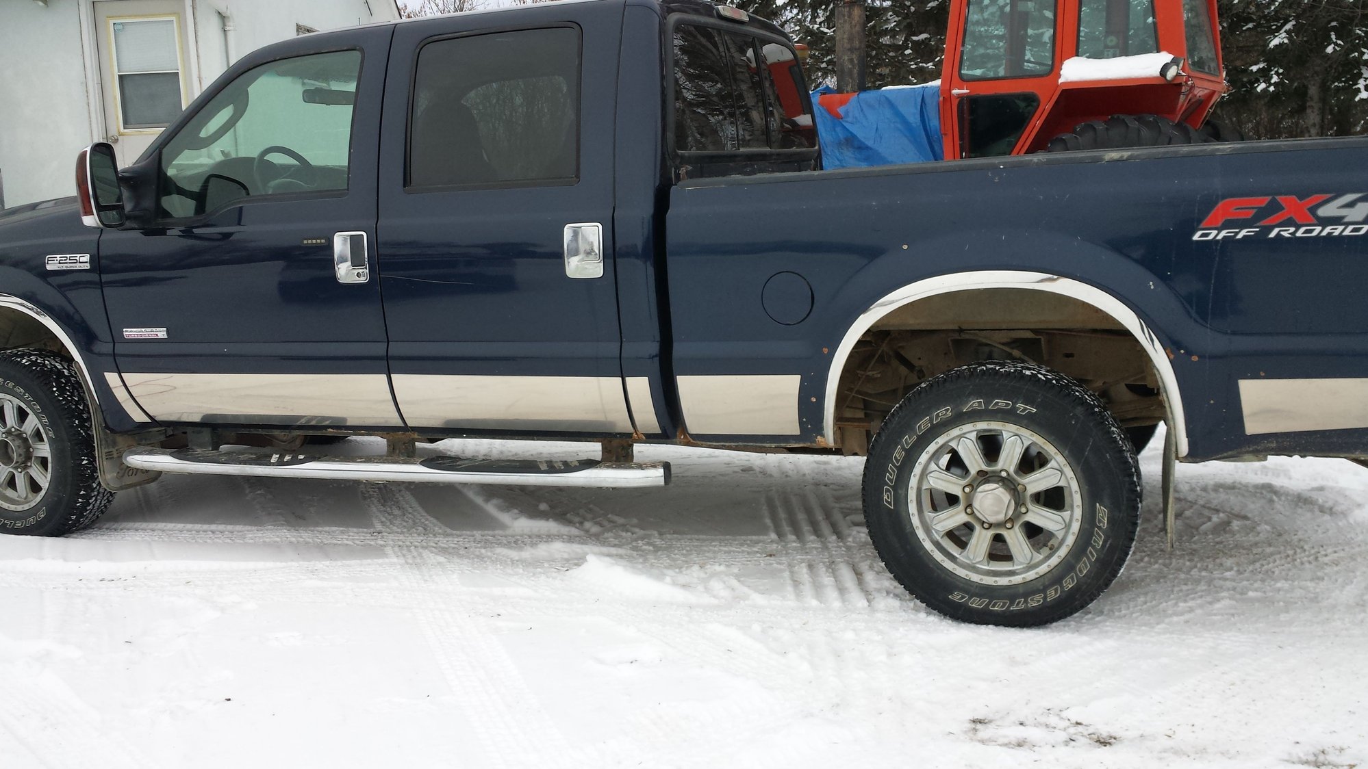

these are the sweet units I'm messing with
