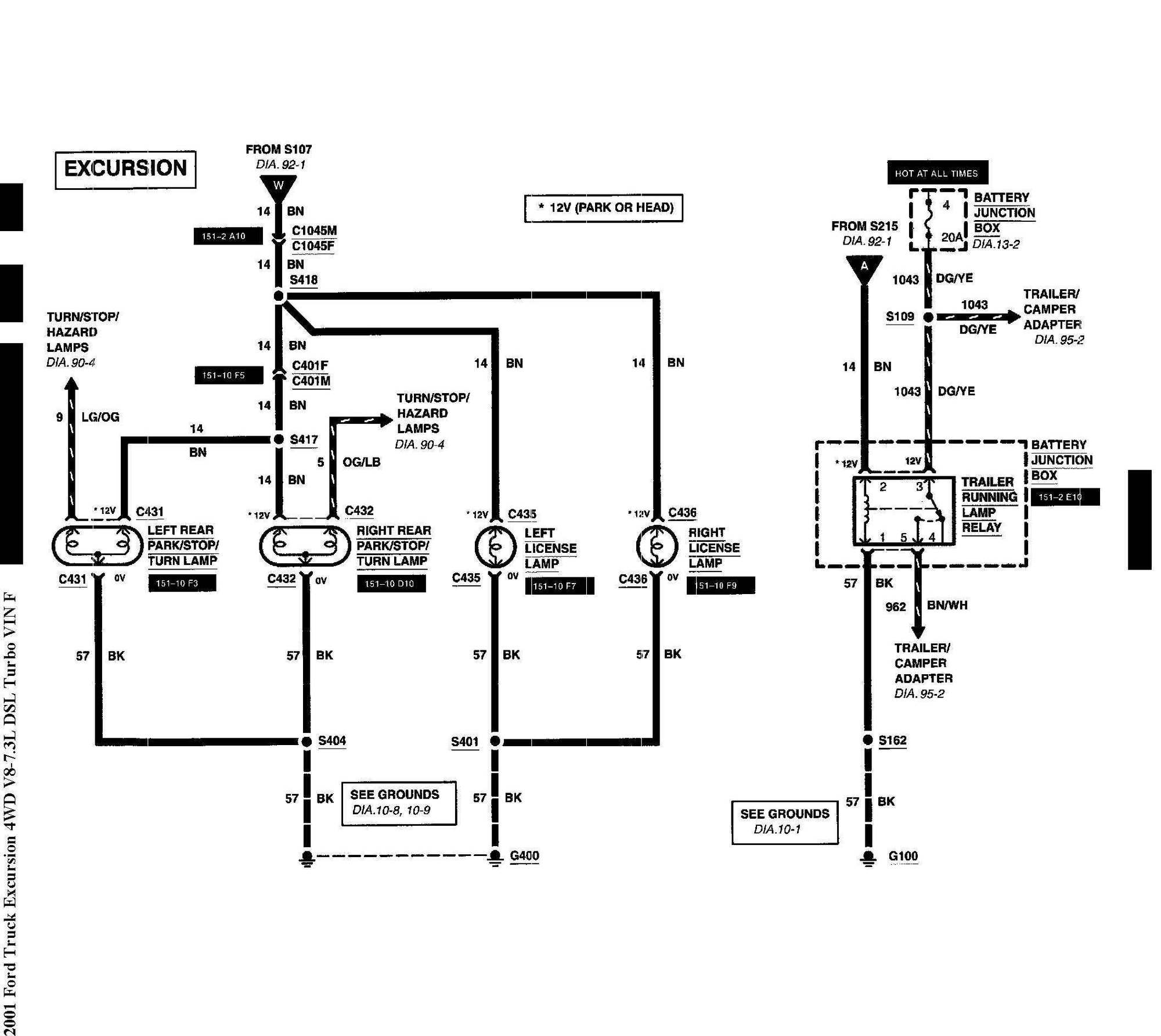

i have 2001 ford excursion limited 7.3l 4x4.
My tail lights just went out. bulbs work and turning signal and reverse light works.
i have no blown fuses, changed headlight switch.
what is my next option?
Thanks for help.

here is the circuitry diagrams. You'll need to determine where the issue is.
