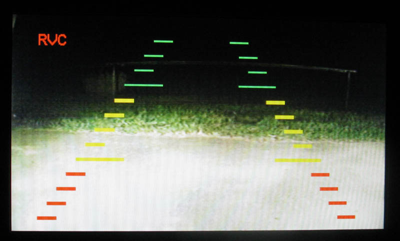

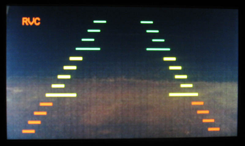

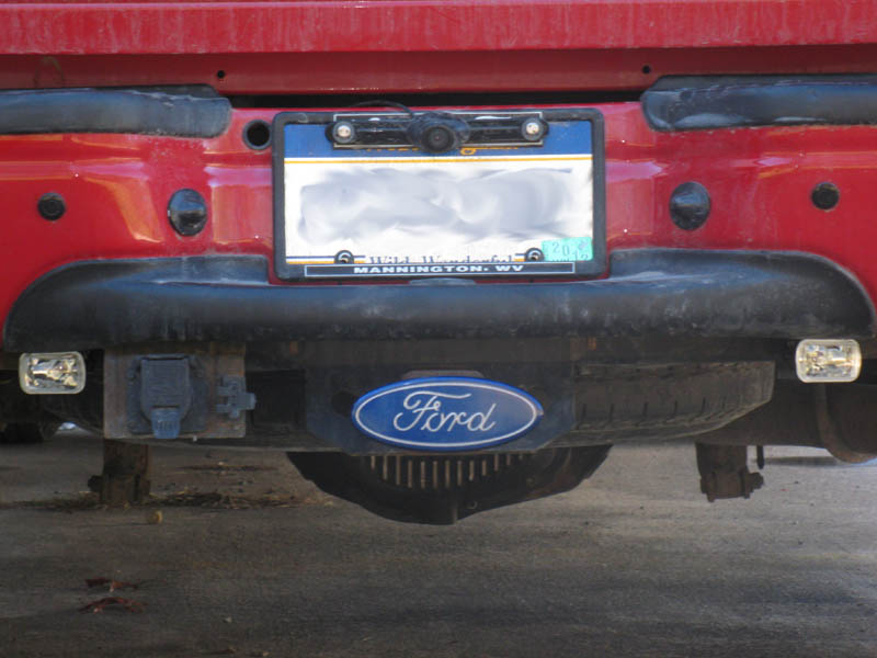

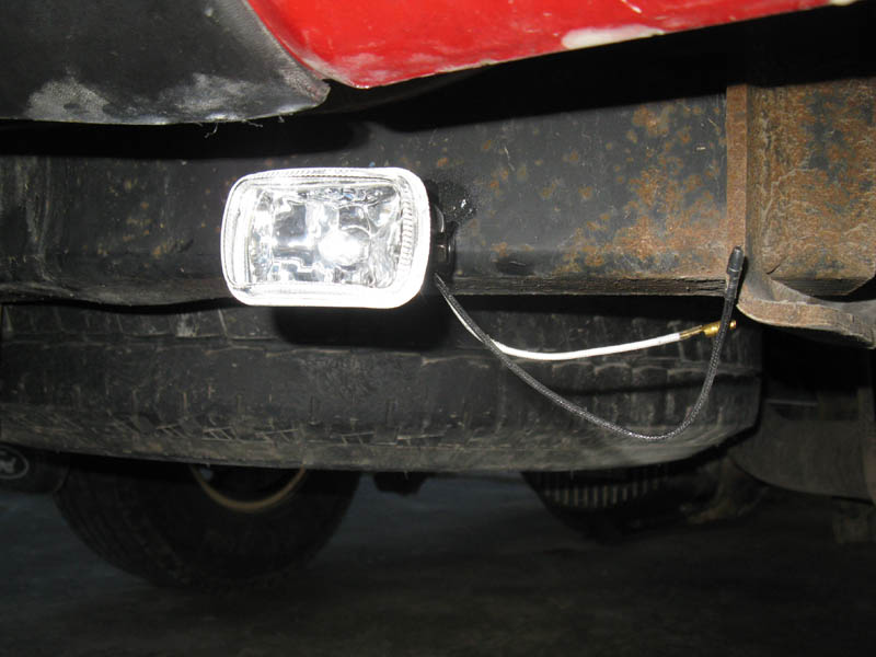

I have a few lighting projects coming up for my truck. The first of which is some auxiliary backup lights. Its too dark out the back to get any use from my backup camera at night most of the time so I added a couple small driving lights back there.
Here's the writeup on that:
2004 F250 Aux Reverse Lamps

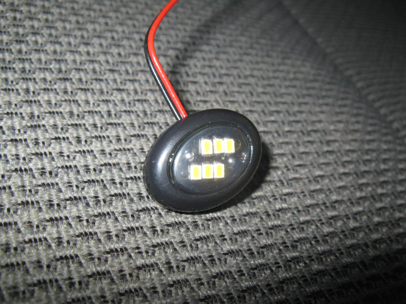

I also bought a few waterproof LED clusters that I plan to install under my mirrors as "puddle lights". Basically they'll just come on with the interior lights. They'll light up around the truck when I click the unlock button for instance.
And, I bought a few small amber marker lights that I plan to put on the pinch weld at some point. Three on each side.
Not sure how many of these I'll get finished before winter hits, but here's a few pics of the backup lights....
Normal reverse lamps only.....
New backup lights turned on...

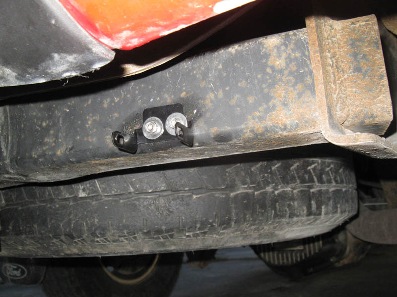

I measured over about 4" from the edge of my hitch and drilled & tapped two holes in it.

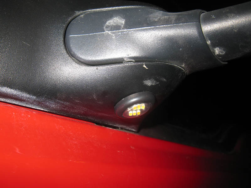

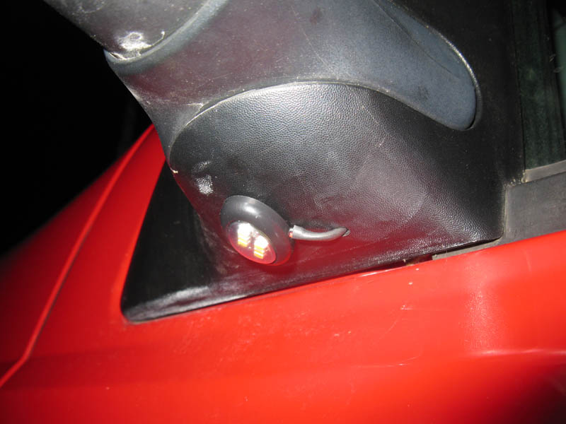

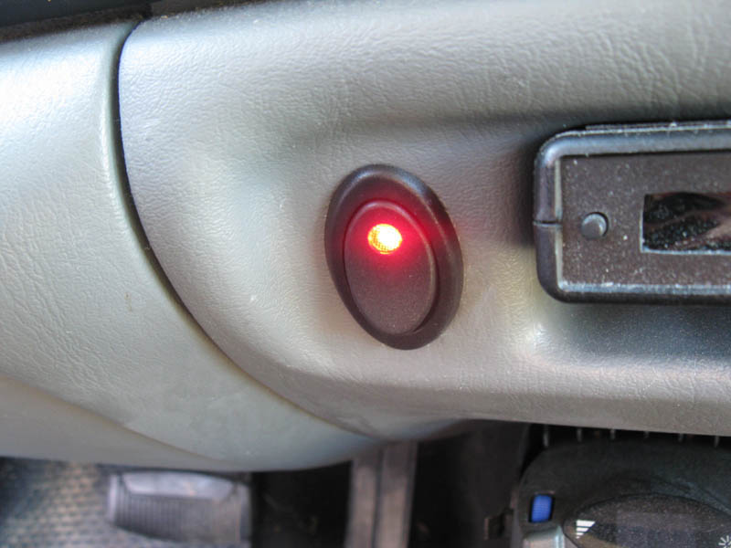

Ok, so today was a beautiful day and I got a chance to work on the puddle lights and they turned out great. They light up the area beside the truck just like I'd hoped. Its mission impossible to get a picture of that so you'll have to take my word for it
Anyway, I haven't done a write up on it yet, but here's a few teaser pics....
superbrightleds.com part number AM-OB-WW6
