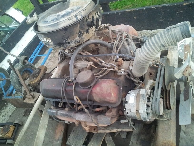

is there a way to tell which I have. Id tag 330 65 5 4m 640j short of pulling it apart.

Google "difference between 330 hd and 330 md" There will be a chart there that will tell you what you want to know. The numbers you are looking for are on the front passenger side of the block. It will be the second entry. Era replica numbers.

don't see a chart, some ND part #s in a post might work though. can't see where the dampener is stamped though. those numbers are casting numbers for the block right and the castings are the same for many engines right c5aea,

From a 2 year old thread on this site https://www.ford-trucks.com/forums/1...-330-swap.html
There are two different 330 FT engines: 330 2V Medium Duty / 330 2V Heavy Duty / Most of the parts do not interchange!
The 4th digit of the VIN is the engine code. 1966/78:
C = 330 2V M/D / D = 330 2V H/D / E = 361 2V / F = 391 4V

no truck just engine
what part of the crank snout is exposed it looks like the spacer is smaller on my 68 390 so looks like the hd any one have a part # for the seal to put in the timing cover and the dizzy spacer ? if not I will see what I can find. thanks for the responses.

dizzy bushing to use fe dizzy, oil pump in a ft blockC4TZ-12367-A
