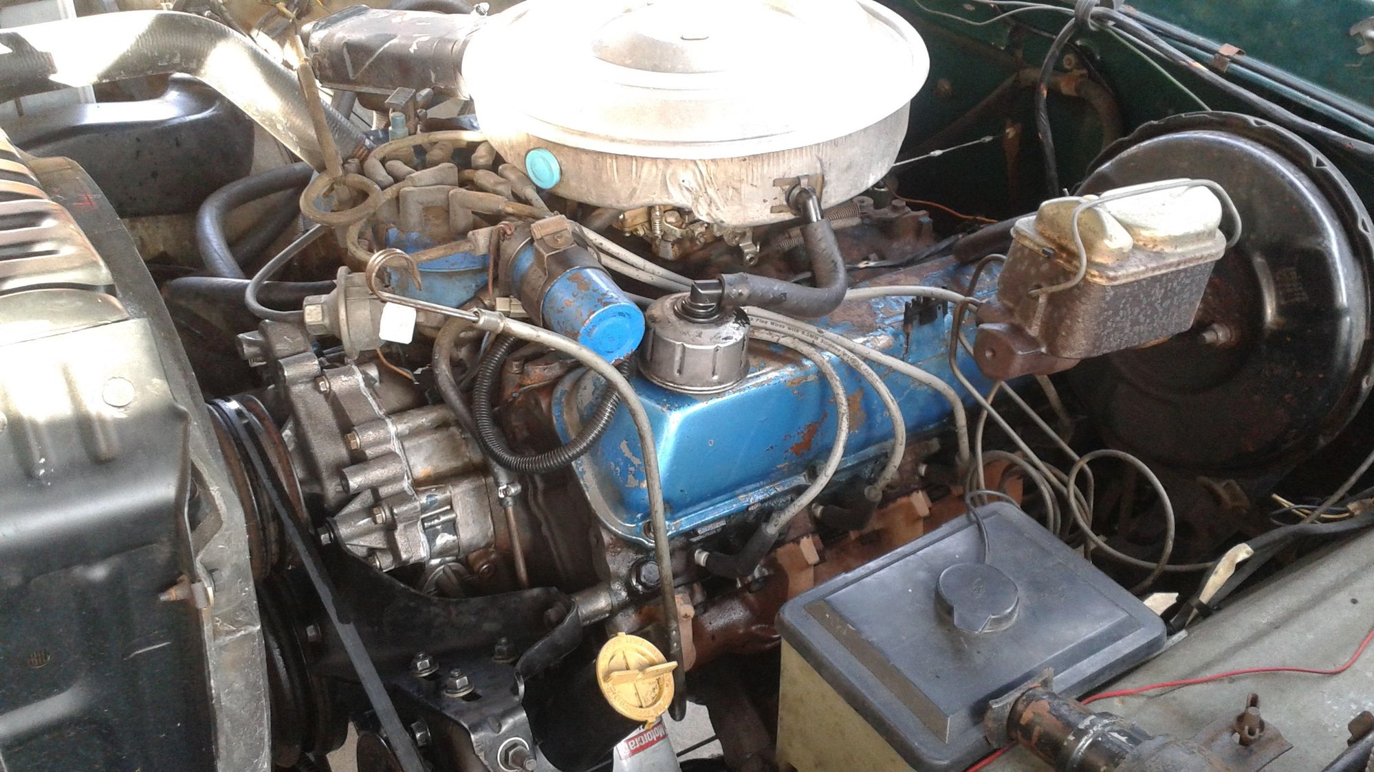

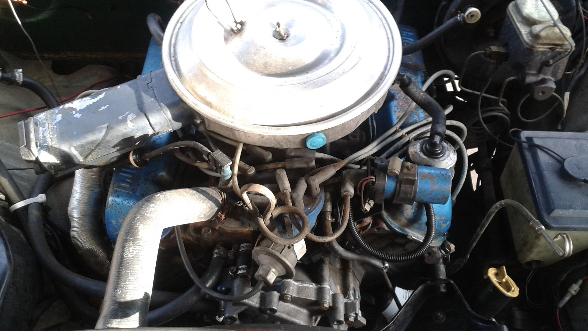

Some pictures of the engine bay:
I did the WP, PS and alternator last week - mostly to learn.
Yes, I spilled some oil on the PS belt. I'm an amateur ;-)
The snorkel hose is in pieces. I've disconnected it until the replacement arrives.

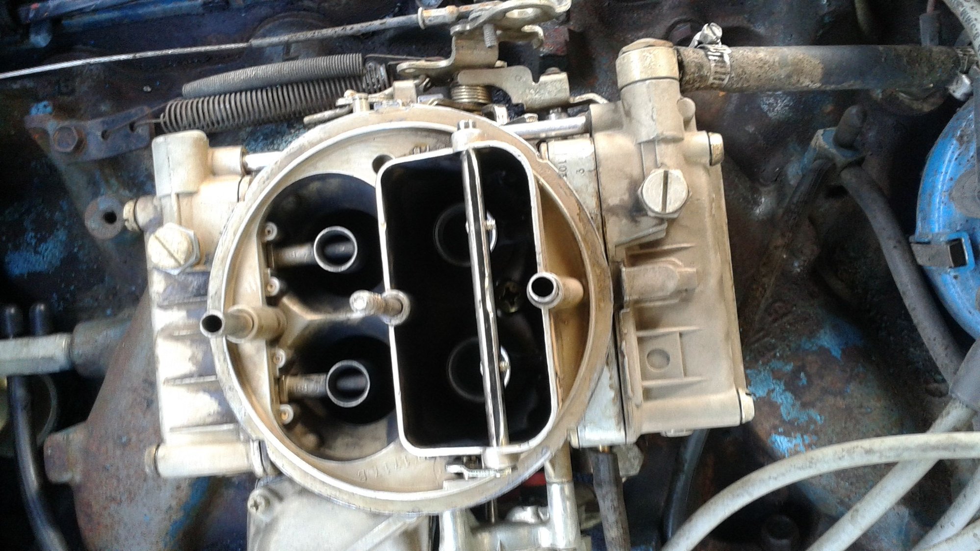

That, my friend, is the gas guzzling, big-inch, 4 barrel, low compression, retarded cam, 460. I bet the motor mounts look questionable too as well as the exhaust? Must be an automatic? Too bad you already did the water pump. It was about half way to getting into the timing cover and doing a timing set to get some of that power back with a strait up timing set. Good engines, hard to kill and pretty cheap to fix if it goes on you. Tune that holley in and it should purr like a kitten.

Thank for the quick response F250_WARHORSE. I am probably going to go back into the timing cover in the not-so-distant future. Would you consider this confirmation of what you wrote?

The quickest way of differentiating between the different familys of Ford engines is to simply count the valve cover bolts.
2 bolts: 239/256/272/292/312 (produced from 1954 to 1964)
5 bolts: 332/352/360/361/390/391/406/410/427/428 (FE engine)
6 bolts: 221/260/289/302/351W
7 bolts: 429/460
8 bolts: 351C/351M/400
And yes, it looks like you've got a 460. Welcome to the 8mpg club
Make sure you take some time to look through the technical info hyperlink sticky. The answers to almost all your questions are in there.

The air cleaner needs to be rotated so the relief on the base is aligned with the distributor. Doing that will also straighten out the driver-side hose to the breather cap. Unclip the fitting on the air cleaner and rotate it to point to the breather. Reinstall the clip.

I am no guru, but my 460 looks just like yours and I have the same carburator too.
