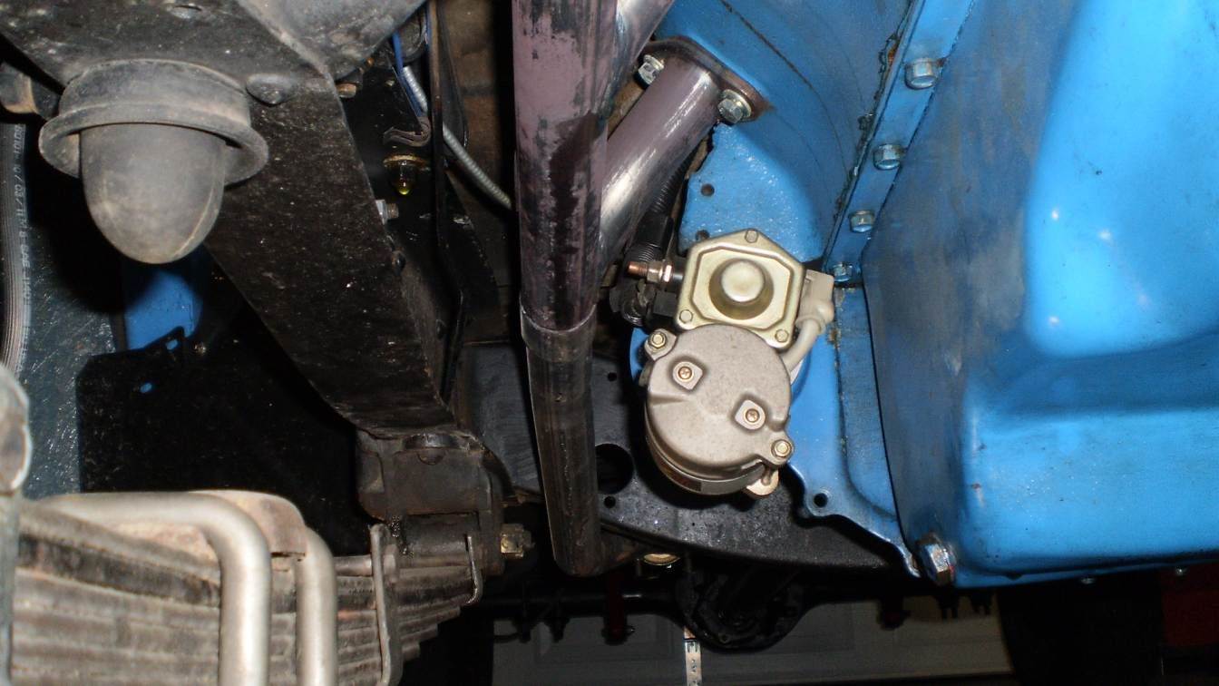

This is the mini-starter I've got. Speedway and lots of others on eBay sell them.
http://www.qualitypowerauto.com/item...-Flatheads.htm
Abe, I had really bad experience with 6v batteries, more power to you if you can keep one alive that long!

And here I am trying to figure out a way to put the mini starter in the original starter casing... I've got a bad starter laying around that would be a perfect candidate for that.. I'm probably better off just re-brushing it as planned. Geez I wish you guys wouldn't give me ideas like this sometimes!

The mini's work completely differently, sorry! They work like a GM starter, with the solenoid pushing the bendix into the flywheel from the front, instead of pulling it in from the back, so no more starter hang-ups. The mini's also weigh 1/3 or less of the original starters, that starts to add up. With the mini, alternator, and various aluminum bits, I've taken more than 60 lbs off my engine.

I was thinking of taking just the outer casing and putting the entire new starter on the inside of that, but then realized the mini probably isn't small enough.

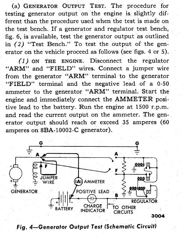

I'm not sure if anyone is looking at this thread anymore, but here is an update on the situation. I broke down and purchased a new 6 volt battery wow what a difference. With the old battery the truck would barely turn over and wouldn't take a charge. With the new battery there is no starting issues, I reach in hit the throttle twice with my hand, turn the key and hit the button. Fires right up, even in the cold mornings. The only issue I have is I am not sure it is charging. I have driven the truck a few times with the lights on and heater going. Each time I park it I check the battery voltage and it is above 6 volts. Its an analog meter so it is hard to read the gauge. Time will tell I guess.

If you've been driving with the lights on and check the battery immediately after shutting it off, I'd say your battery is charging.
Why not start the engine, set the throttle at high idle and check the voltage? If the generator is charging the battery, you should be getting over 7 volts.

I have done that a couple times and have never gotten a reading above 6.3 volts. I am wondering if the generator is wearing out and putting out a little over 6 volts. I have never had 7 volts at the battery at high idle. I'm not sure what to check next.

All the tests are covered in the Workshop Manual.

Thank you very much for the schematic. It is nice to see it drawn up like this. I have ran across this procedure a few times as a written description but was a little leery of trying it. If the weather improves I will try this.

If you don't have an ammeter capable of those currents, it seems to me that if you disconnect the F and A terminals at the regulator, and put the A wire over onto the B terminal of the regulator, then jumper the F to A at the generator, you can use the dash ammeter. You don't want to do any of this too long, a minute at most.
I've never done this, so proceed with caution! Better to find an ammeter.
PS you really need to get a manual if you want to work on your truck. They are only $20 - $30.
