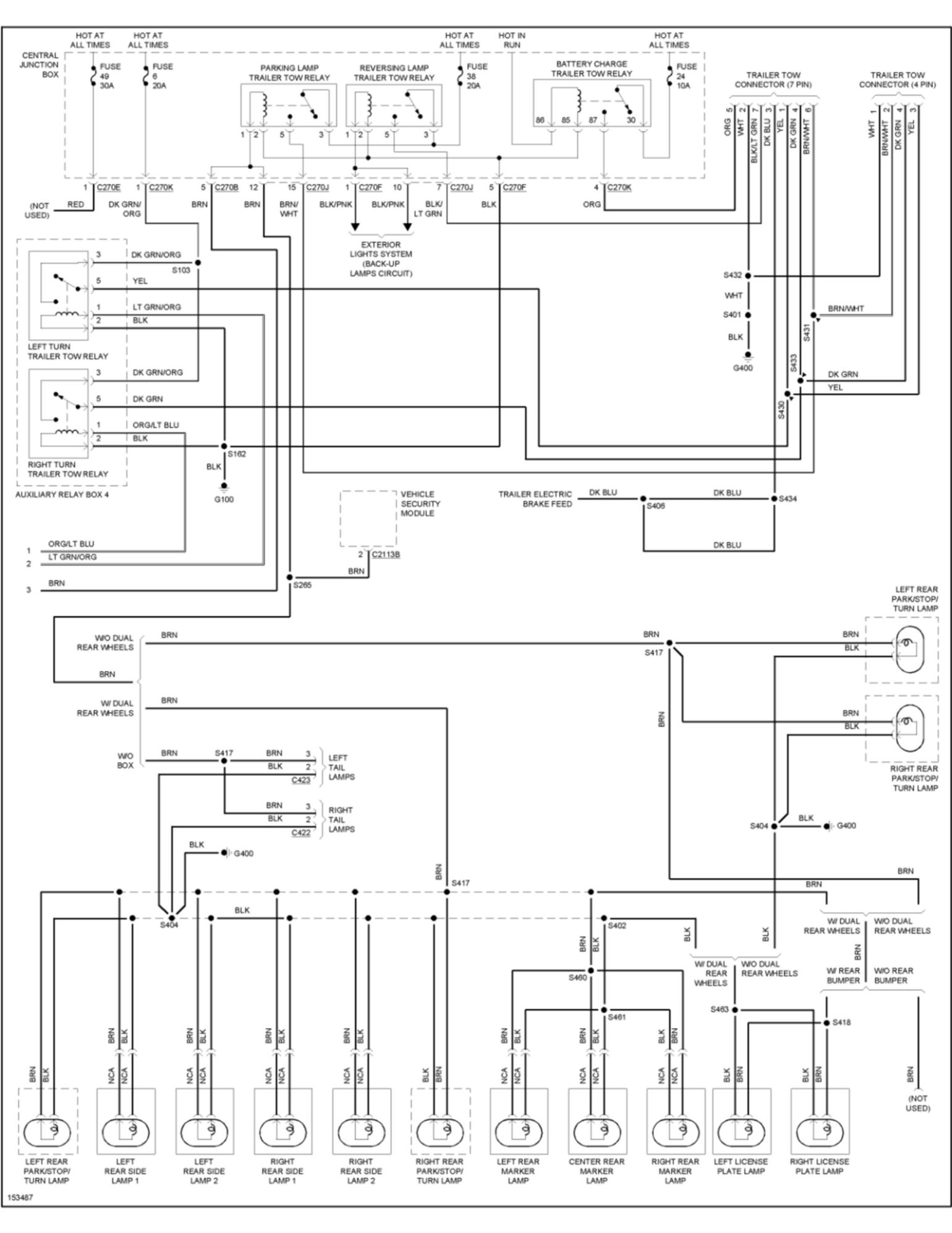

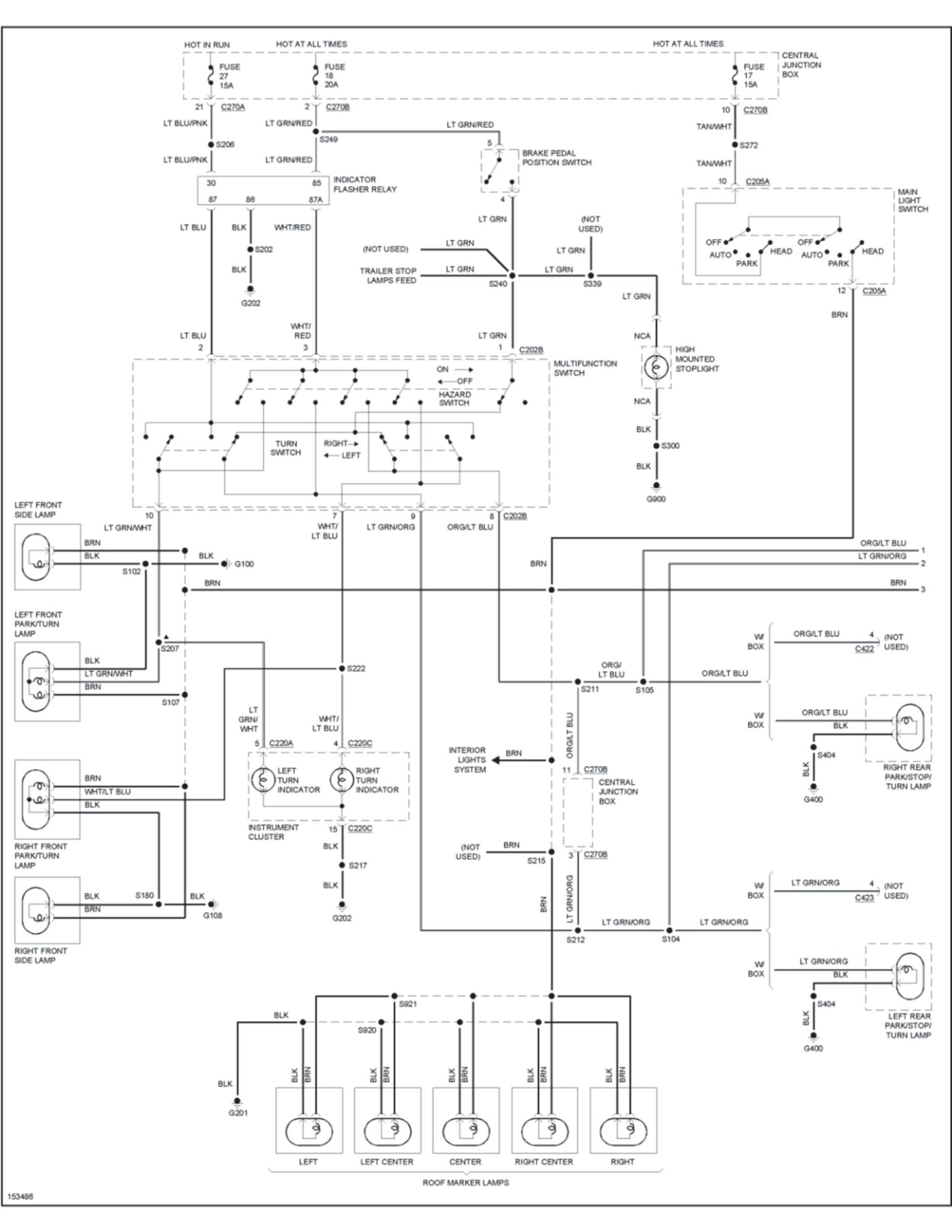

Here are the 2 wiring diagrams for the stop light circuits. You might have a chaffed wire some where in the circuit. Hope these diagrams help.

Does it blow when the trailer is NOT hooked up?
If no,
You have a trailer wiring problem. I would check the trailer wiring from the trailer plug to your lights.
If yes,
Looking at the second diagram....I would look for a chaffed wire that goes from the auxiliary relay box #4 to the trailer plug on the rear of the truck....
trace the yellow and dark green wires from the trailer plug back to the aux relay box 4...some were along the way you will find an exposed wire that is shorting to ground to blow the fuse.

Originally Posted by Muzzy33
Could it be the switch that's attached to the brake pedal?
No. It's either the trailer (if one is hooked up) or the vehicle harness between the points that Larry said to check.
