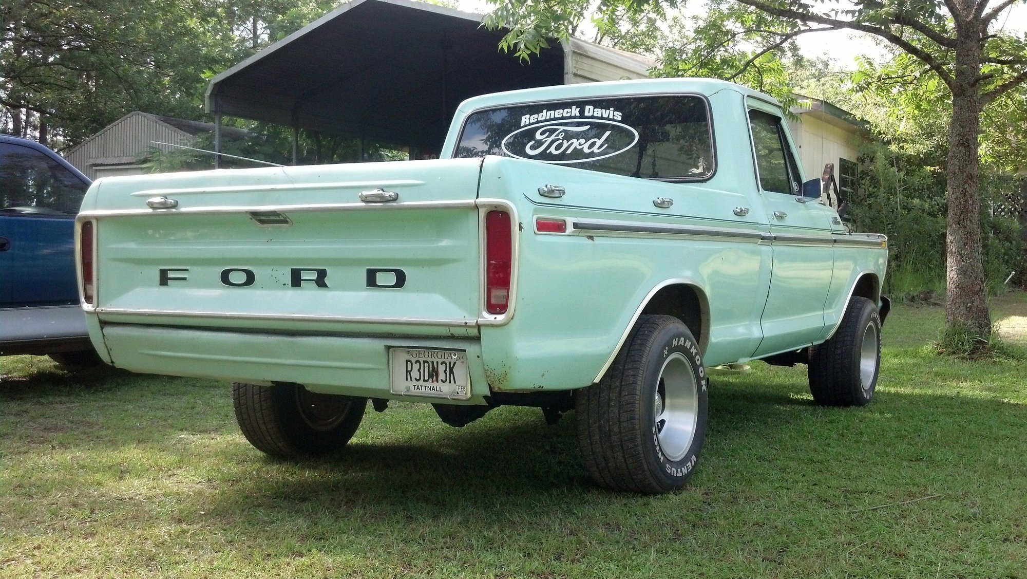

And here's my baby

Very nice looking truck!! I also run a 429/460 in my 76 F250 4x4.

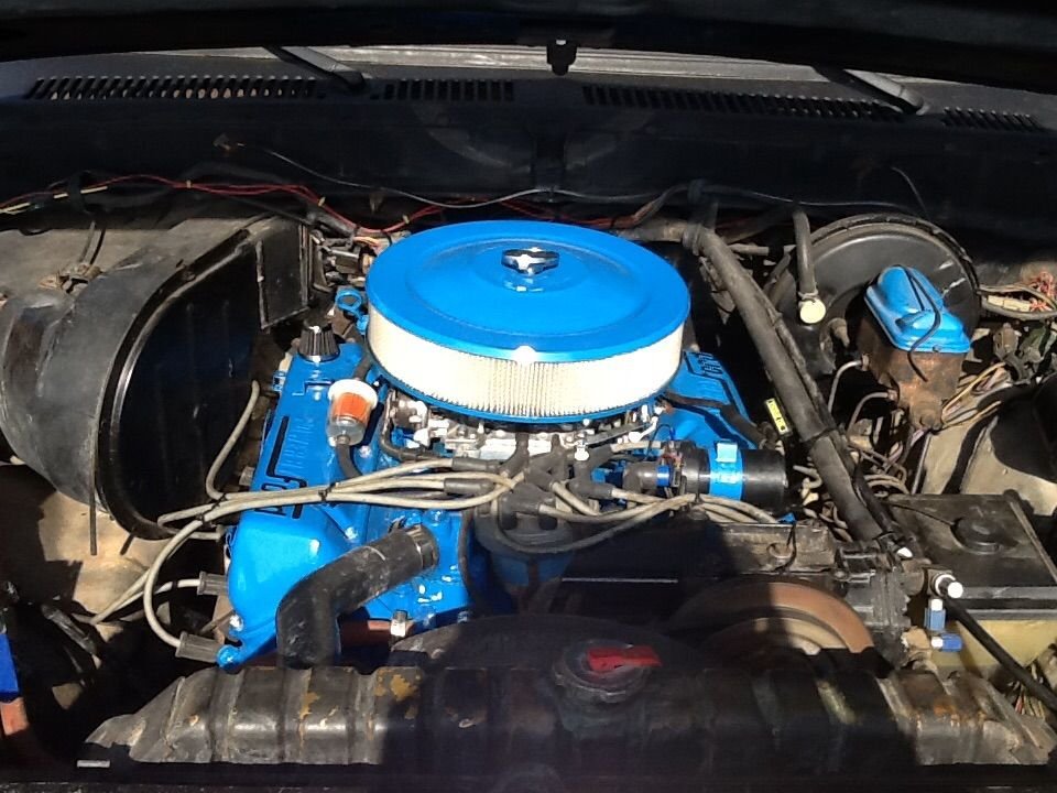

The paint is duplicolor. I just got the engine in last Friday but I've been keeping it hot( running and driving it everyday). It also ran a lot before I got it in on a engine stand. The looks of the paint hasn't changed any so I think its going to hold up well.
I decided to keep the stock 4 barrel cast iron intake. Supposed to have better low end with it. I also installed a double roller edelbrock timing set and set it at (0). The engine is stock other than the timing chain and edelbrock carb. Sure does have a ton of torque though. Moves the '78 Bronco easily. Big upgrade from the 351M it had.
